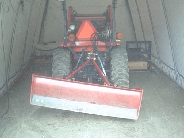

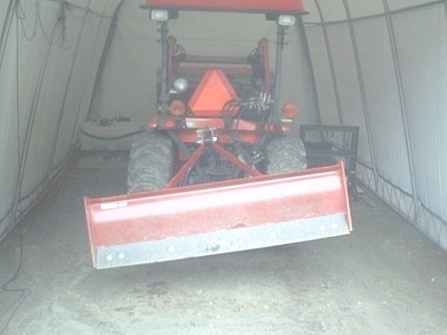

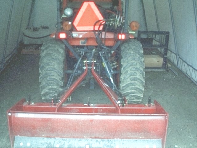

Why not just replace the fixed link with the hydraulic link. That is what I did. At installation all you really have to do is make sure the lift arms are level when the tilt cylinder is half way extended. You will be surprised that how much tilt you will get with a 5" stroke cylinder. You really don't need a second cylinder, it's just overkill. BTW, I fabbed my own cylinder ends to match what was originally on the tractor.
