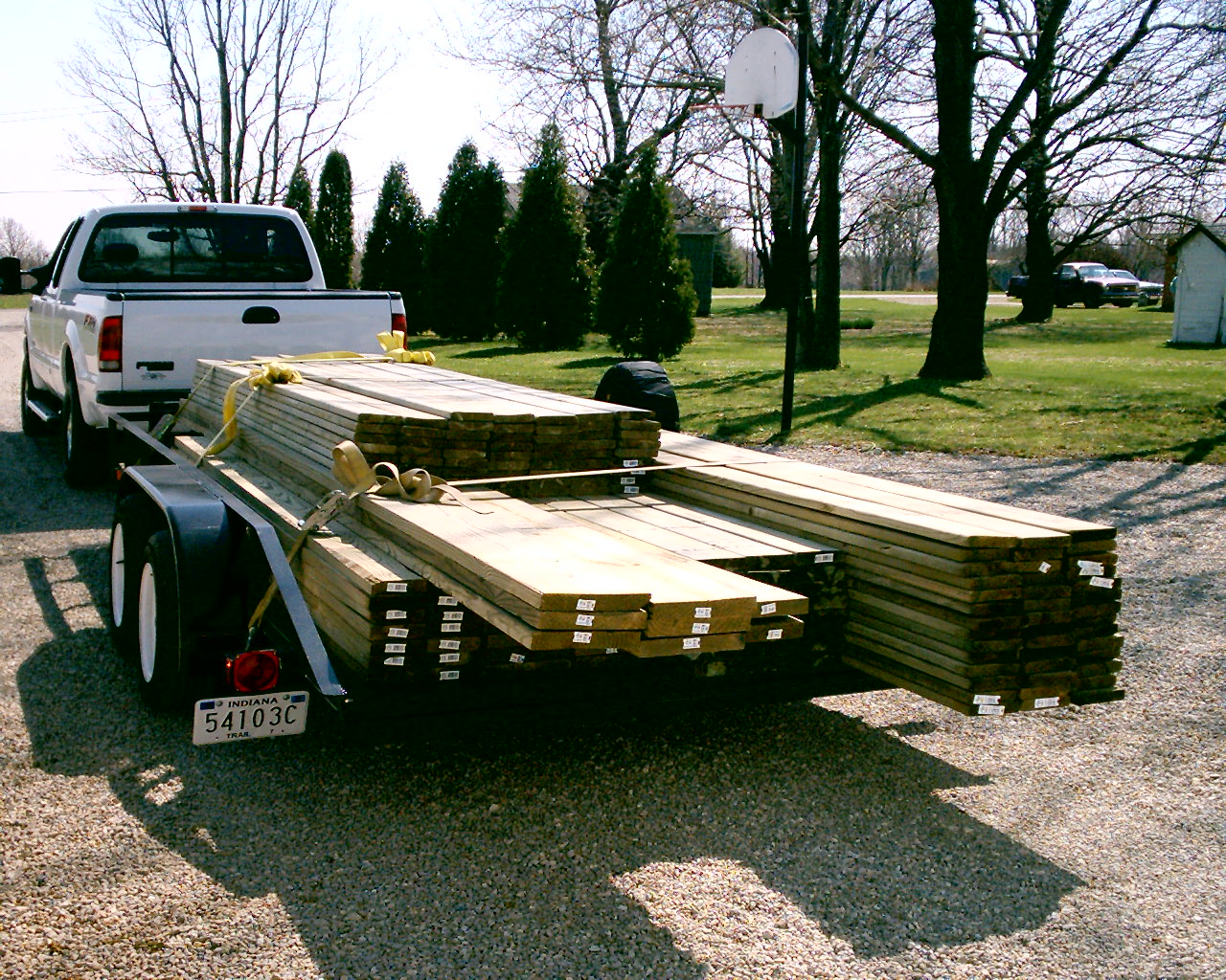

No! I have one of these trailers and while they are very good they are not meant for that type of weight. My trailer will haul about 5,000# after you deduct the weight of the trailer itself. My Jinma 28HP tractor weighs 5,200# with the FEL and something on the 3 point and its the max my trailer will handle. Most cars weigh in at 3,500# so they are no problem and even pickups up to 1/2 ton weigh 5,000# so that is doable. I tow most of the time with my Diesel trucks so tongue weight is not so much of a issue but with a SUV or 1/2 ton it will be. The only real cure for this is a longer trailer that will allow you to move the load to balance.
You need a 10K or 12K trailer.
Chris
