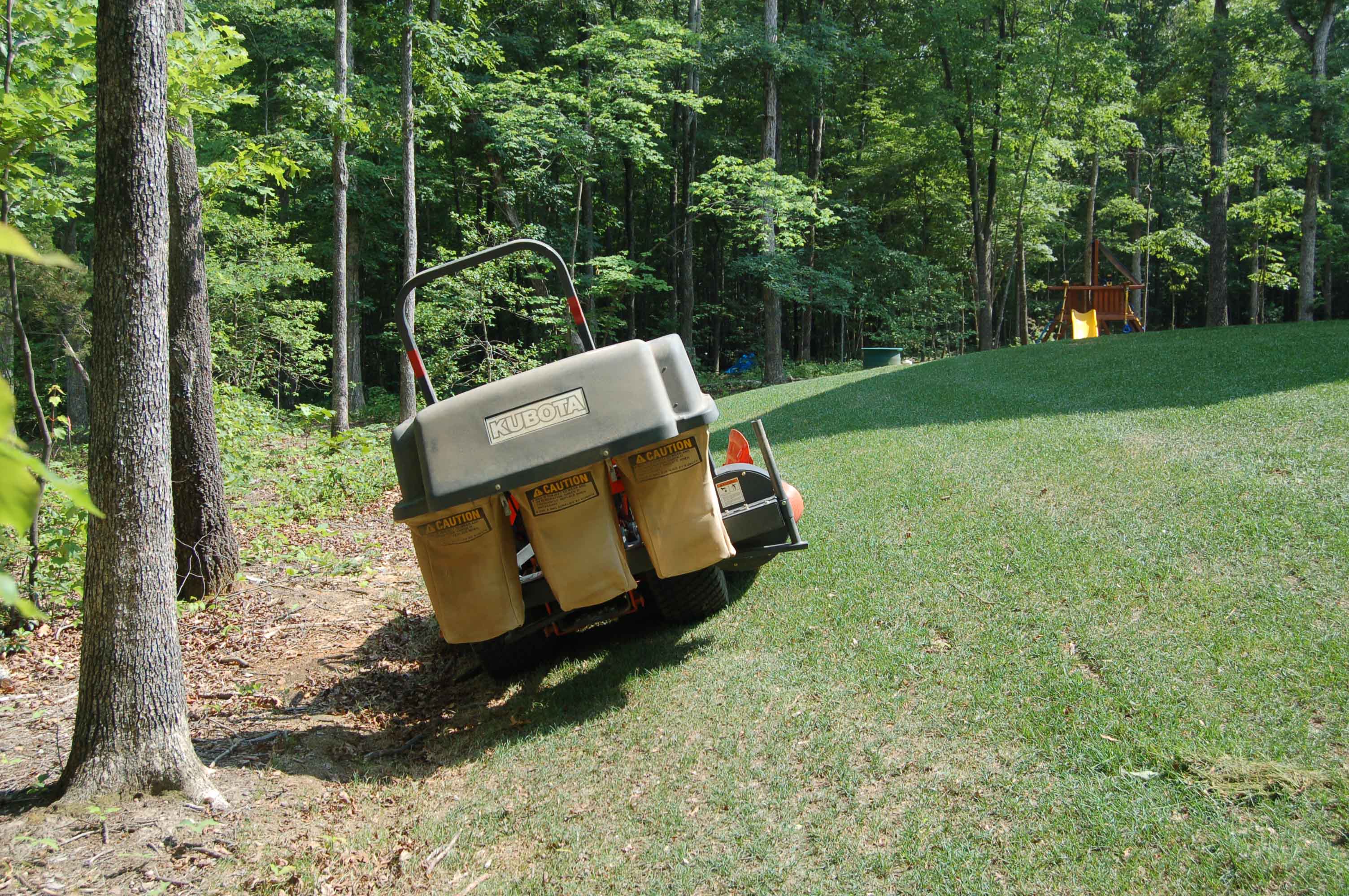

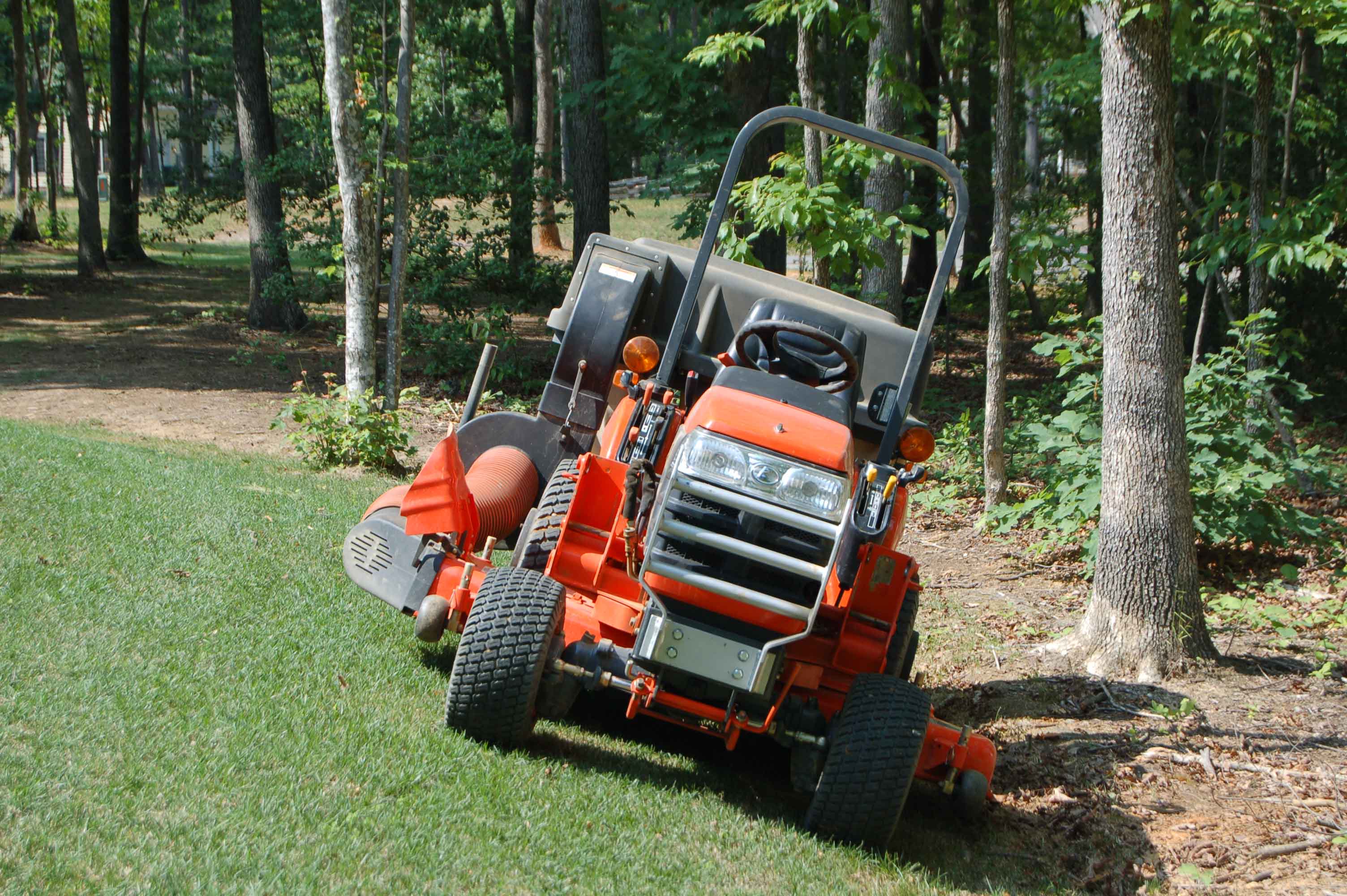

Agree with others. And said it in a thread not 1 month ago. I would NEVER go by a tilt-meter. Just no point.
This is about the steepest thing I mow. I always slow down when I mow this and don't go the other way since the mass of the bagger would be downhill instead of uphill (see impeller offset in "front" picture). I think I'd make it, but as others have said, if I ran over a twig, hit a soft spot, found a chunk of dirt or a pine cone, I'd suddenly find myself at a very different "slope" and further risk a rollover.
I have tried this slope with FEL/BH and MMM/Bagger disconnected...couldn't do it. The COG was so much higher that I was simply too uncomfortable to continue.
I just measured the slope in AutoCAD off this picture...17 degrees. Doesn't look like much in the picture. But it feels steep enough on the tractor to prompt me to get off the tractor, take a picture, and share it with others.
Go with your gut. Look at what your doing. Don't stare at a tilt-meter and figure "you're good". Way too much can happen.
