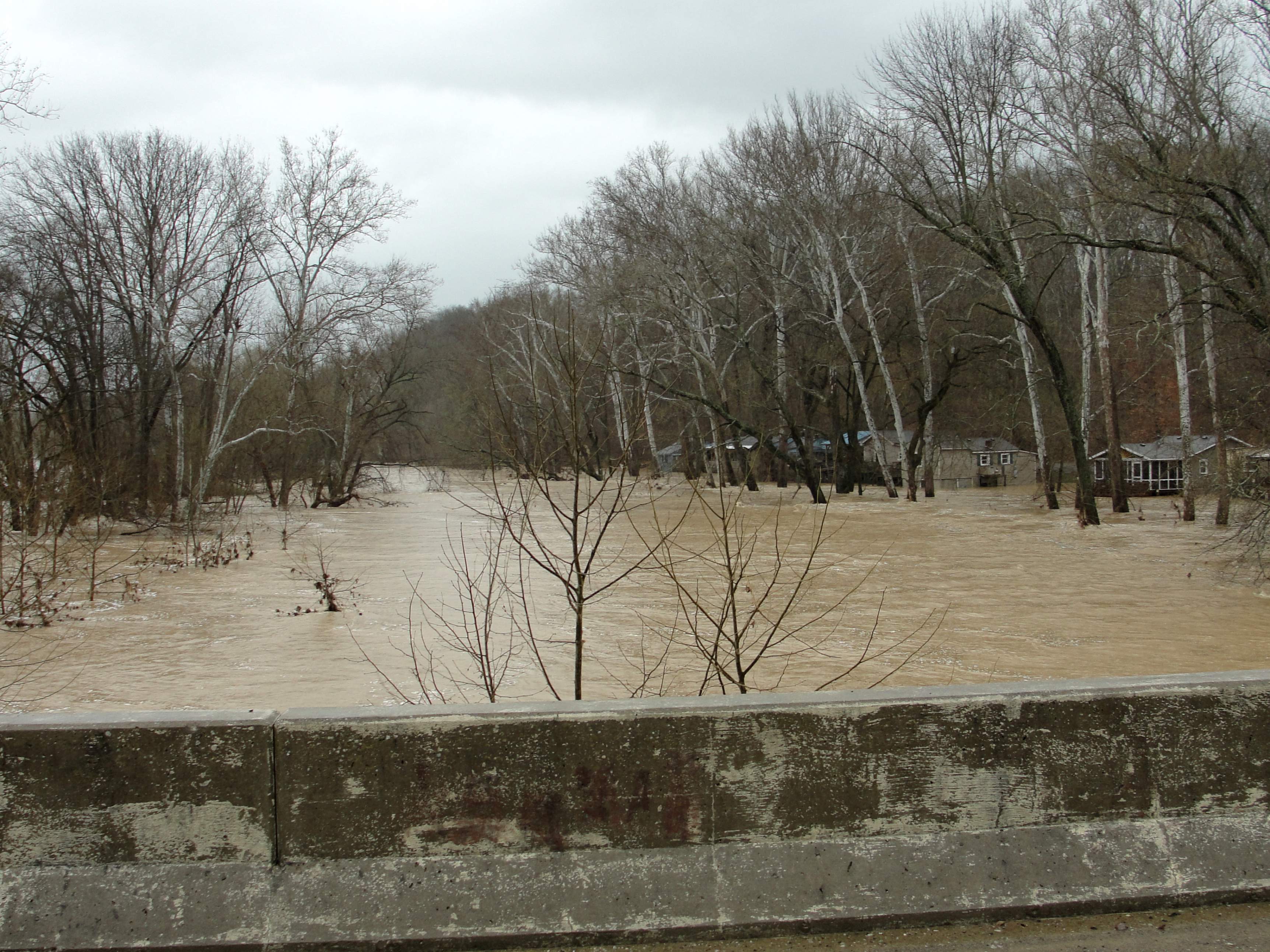

Haven't been able to move forward with this project because of the almost non-stop, copious amount of rain we have been having.
Photo of an example, not the driveway that I need to work on!

Well not every creek will fit through a twelve inch pipe.
