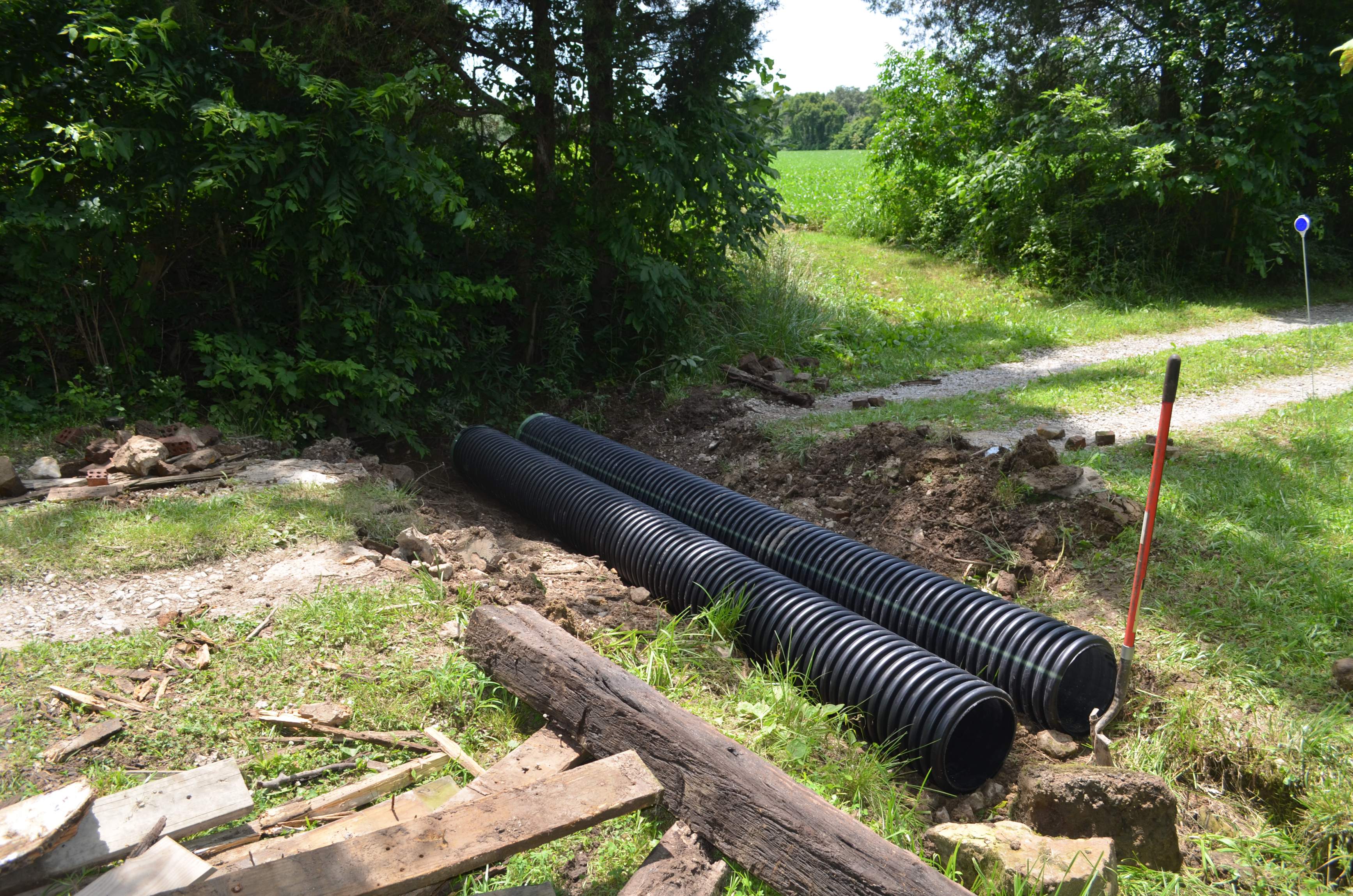

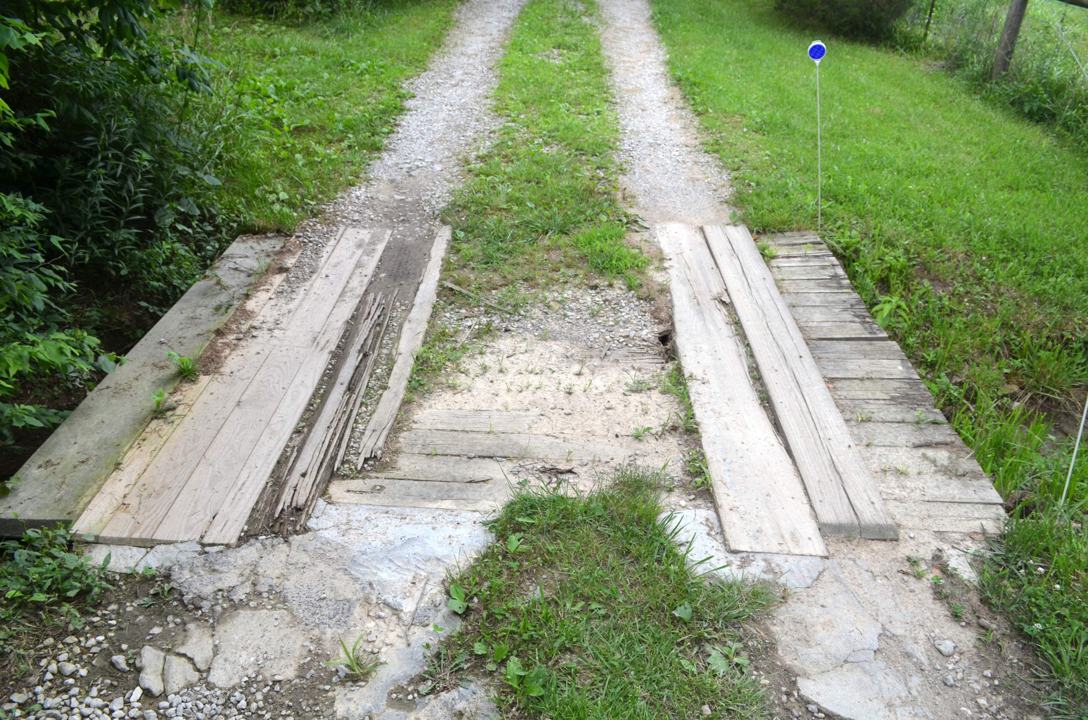

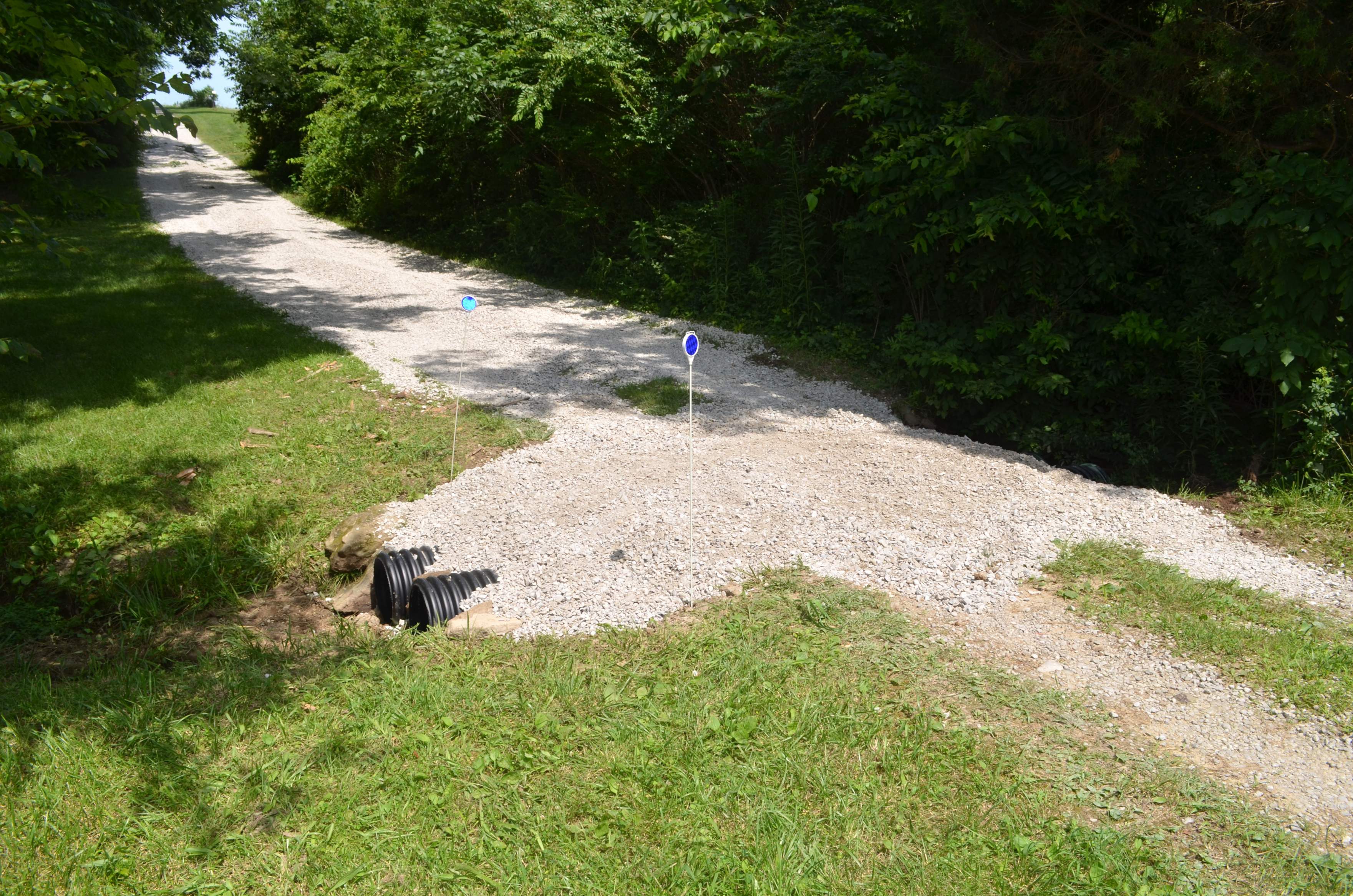

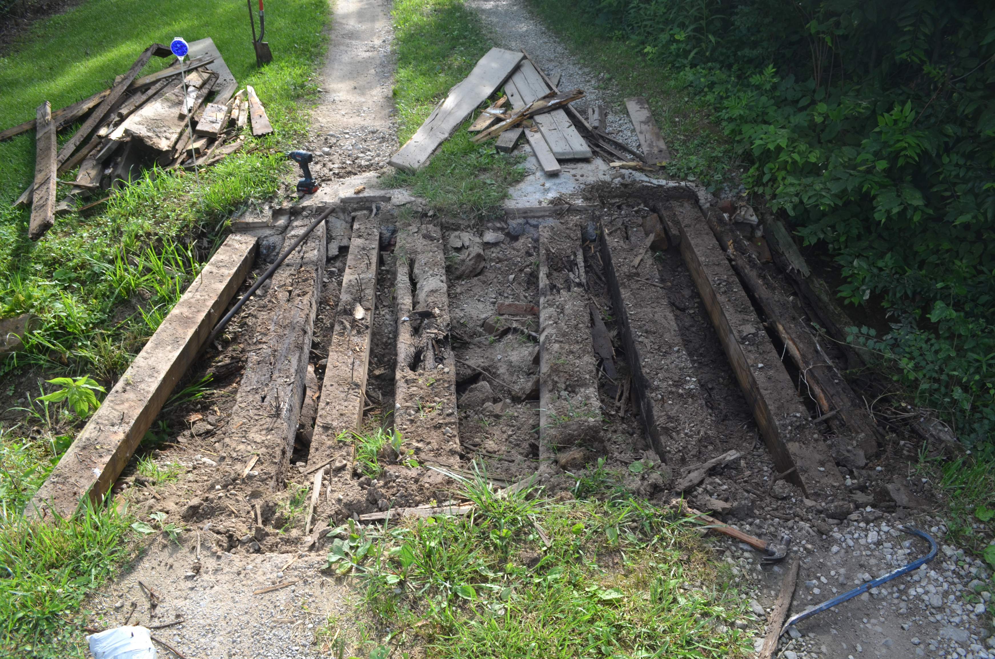

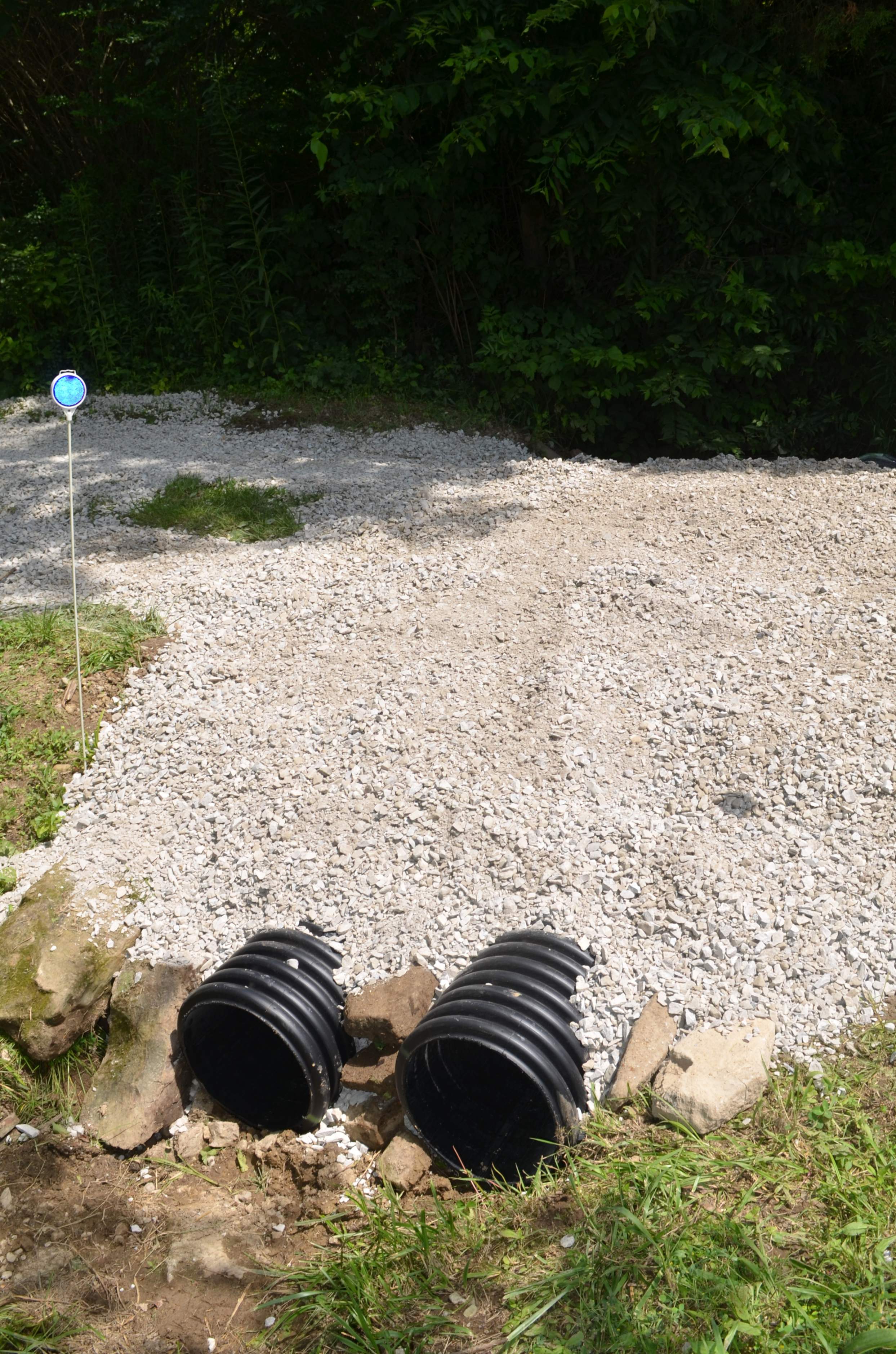

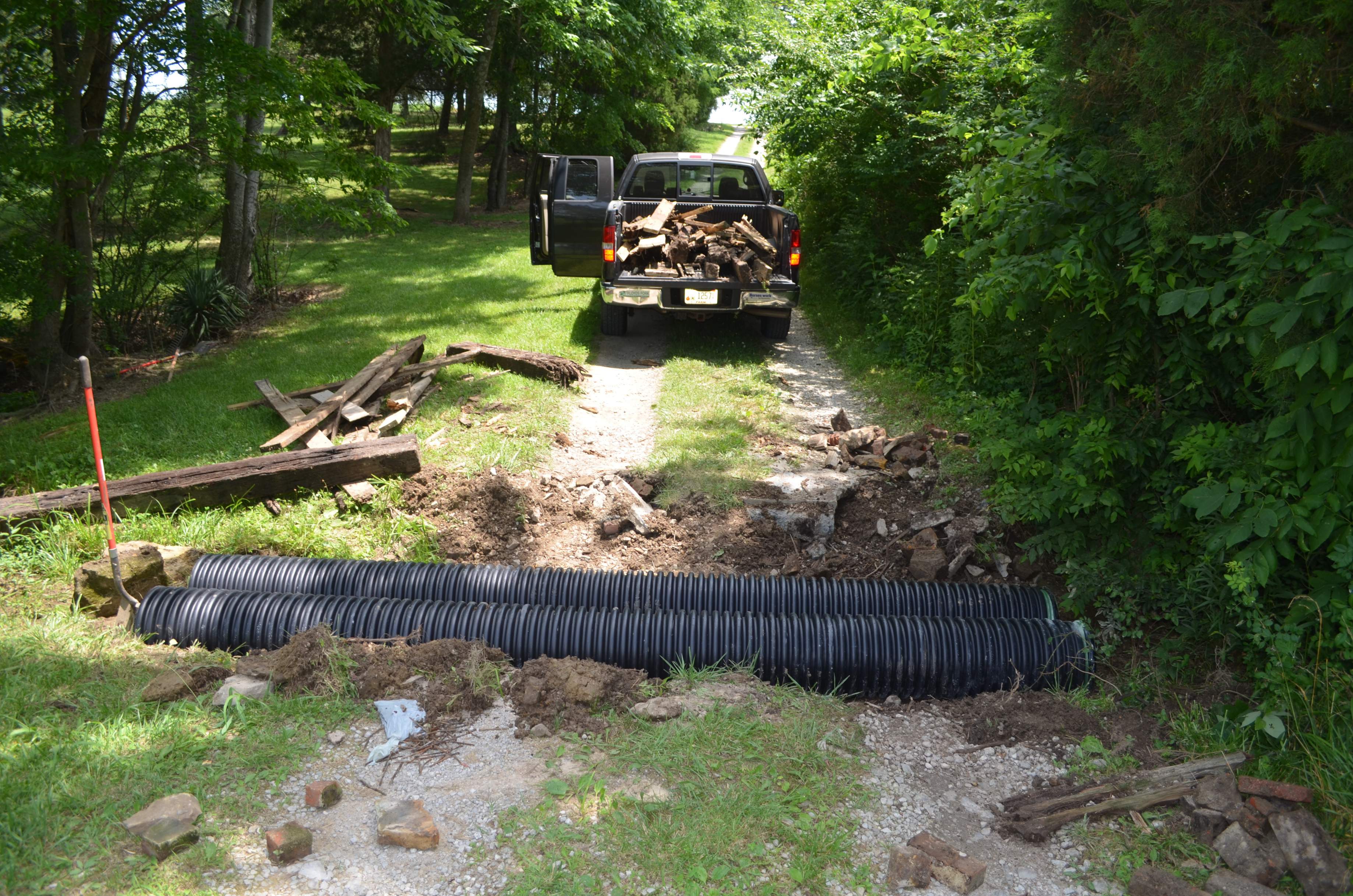

Well a wet Spring and complicated schedule put this project off until this week (in the heat). I finally decided on a culvert; smooth bore 12" plastic pipes side-by-side with a good covering of DGA (dense grade aggregate). Definately time to stop driving over the old wooden death-trap.
There is probably now more water moving capacity since it was pretty silted up under the old bridge. But you want to see pictures, don't you? Here you are:
