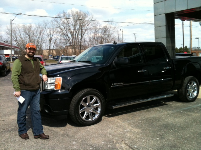

I bought this truck in March and have averaged 16.6 mpg. I have pulled trailer most of the summer hauling my JD 2210 w/various attachments. It has the 6.2 liter with the Borg Warner 6 speed transmission, 460hp and AWD.
My wife has the 6.0 liter in her 02 Yukon Denali and averages 18mpg. She said she could get that or better with my truck if she drove as I am a fast, hard driver.

That's a good looking truck:thumbsup:
I see you got the Denali - love my Yukon Denali, definitely the way to go!
