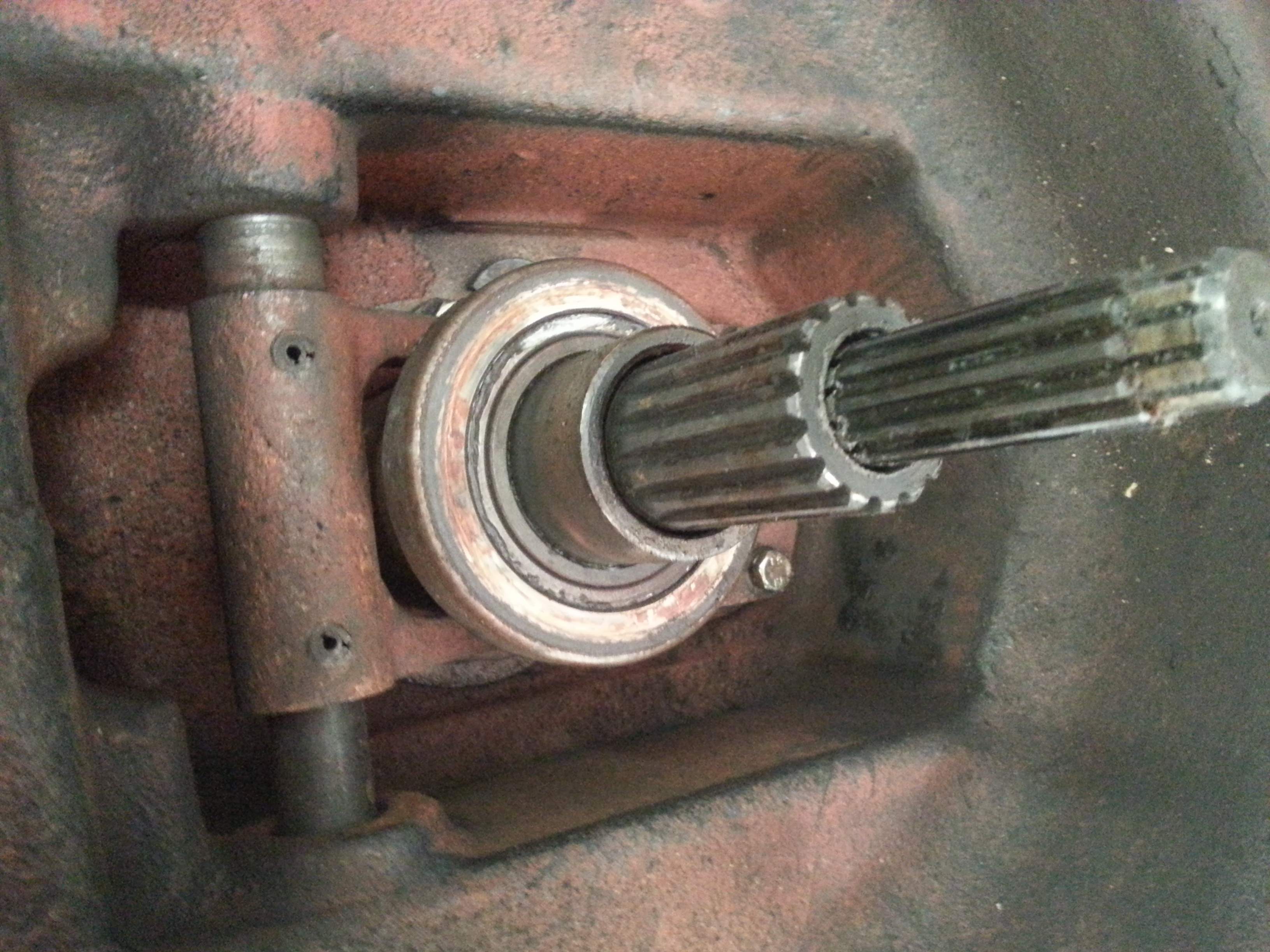

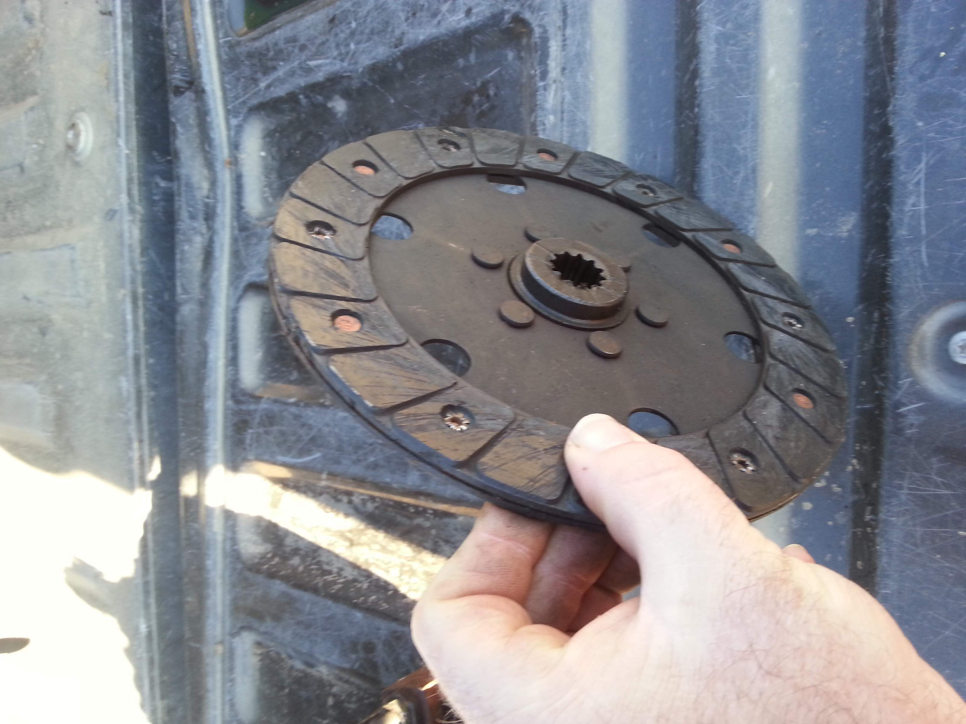

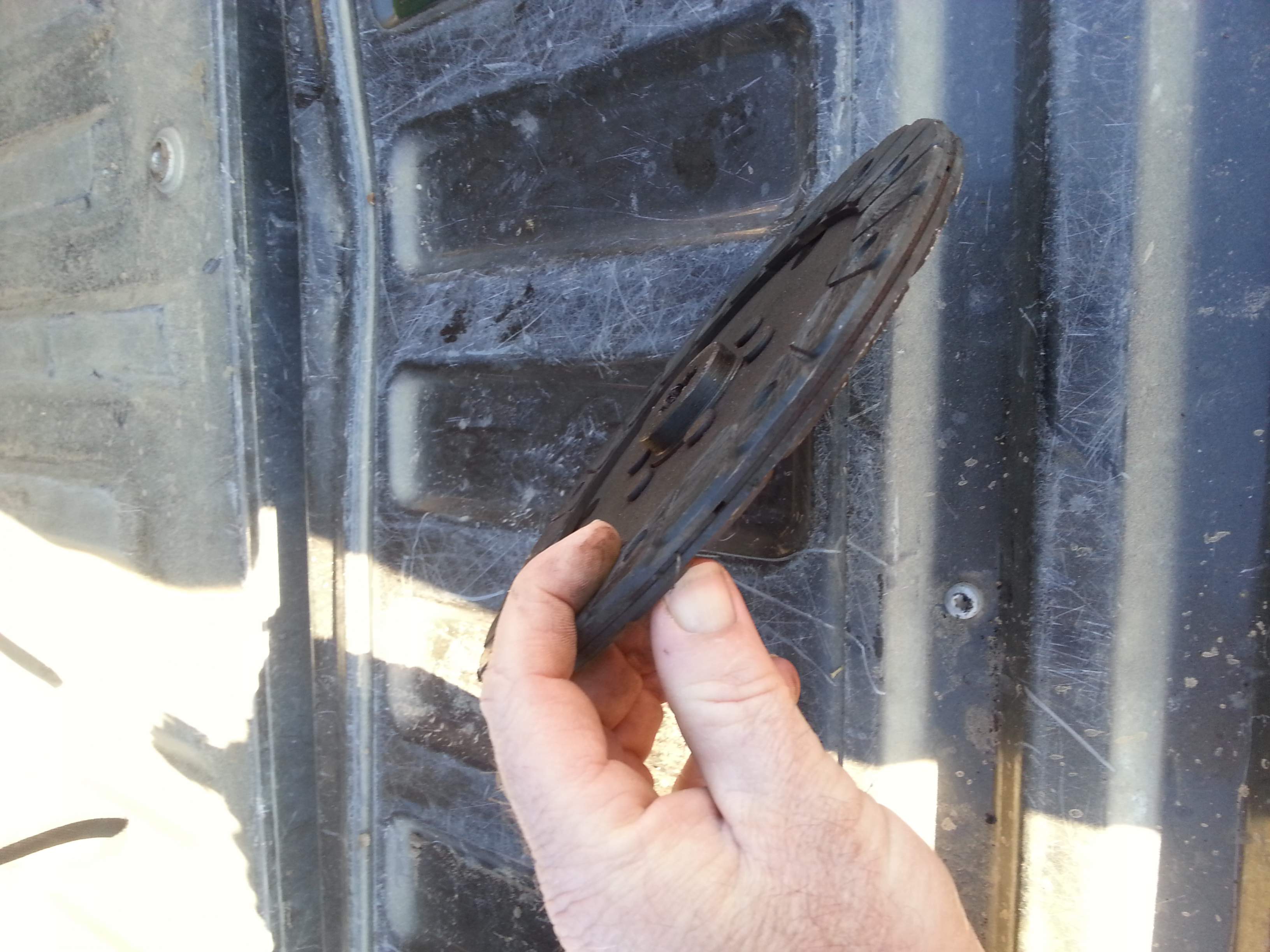

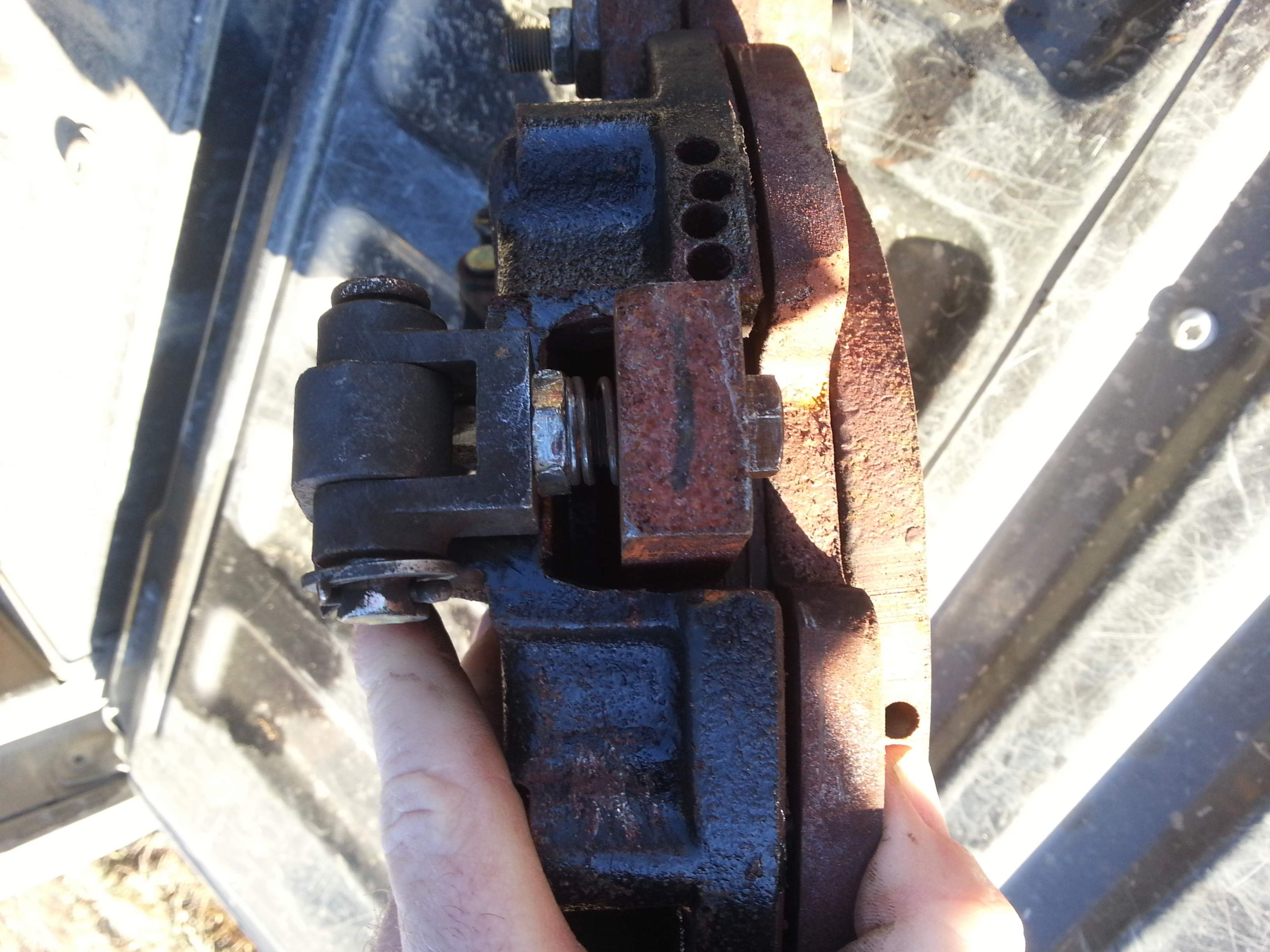

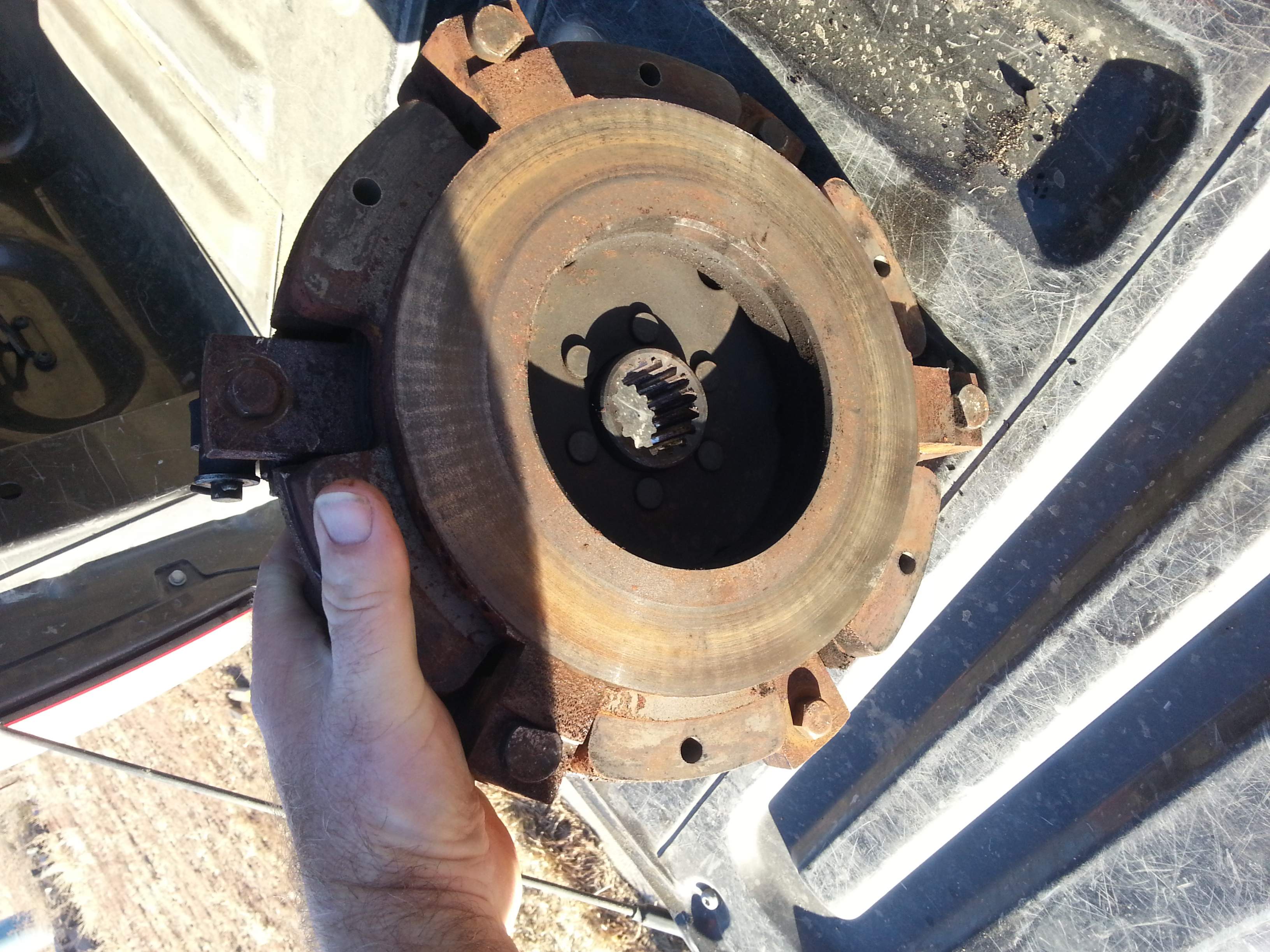

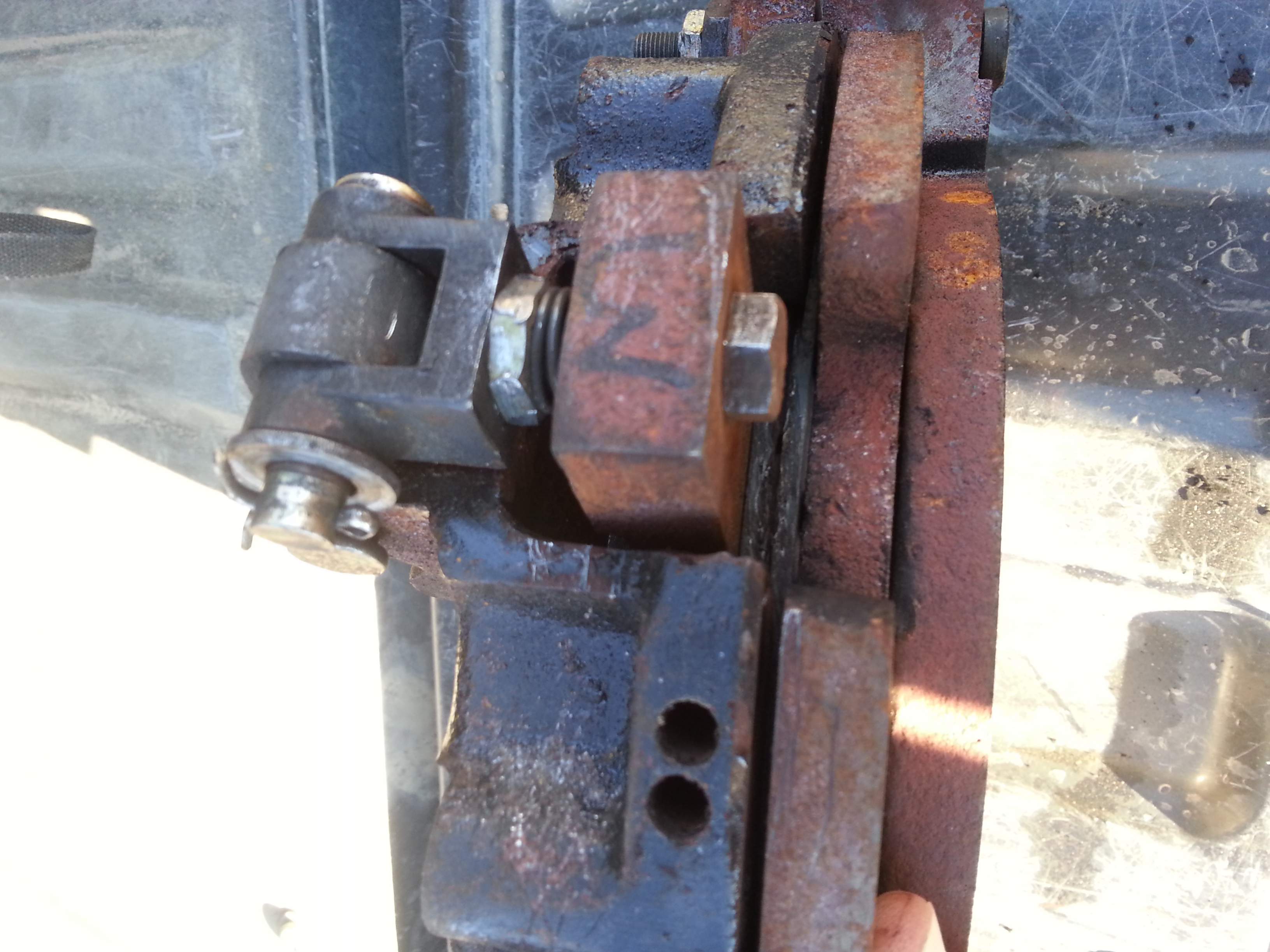

I have the clutch out and am putting in pictures. As far as I can tell there is no more clutch. It is gone. The pto clutch is good but will replace. Does the cone on the pto clutch go toward the engine or transmission? Also I put in a short video. My neighbor said it might be good to replace the throw-out bearing. But it turns and move in and out. And does not seem to have much wear on it. I need to get gap spacers. Are there any good ones at sears or ace? 20131222_150720.jpg20131222_150730.jpg20131222_150740.jpg20131222_150744.jpg20131222_150752.jpg20131222_150801.jpg20131222_150806.jpg20131222_151112.jpg20131222_151115.jpg

I was asked at Affordable if I needed the 8 or 9. I measured the pto clutch and it is under 8 by a little. Is that how to measure it? Because that is what I ordered.

You really should replace the clutch release (throwout) bearing and the pilot bushing as well. They are inexpensive and there is no reason to risk a later failure just to save twenty or thirty bucks. What's your time worth to have to split the tractor again if one of them fails?
How are the clutch fingers? Any visible wear or scoring on the contact ends where they meet the throwout bearing?
I suggest using blue Loctite on the bolts when reassembling the clutch, flywheel, bell housing, etc. Don't use the red Loctite. Torque to book specs unless Tommy recommends something different.
If you're going to set up the clutch pack on the bench, you need to bolt it to a flat reference surface. In order to get the clearances set correctly, the clutch pack must be compressed just as though it would be in the tractor.
I'm unsure what you mean by "gap spacers" - do you mean thickness (feeler) gauges? Sears has good ones, yes.
