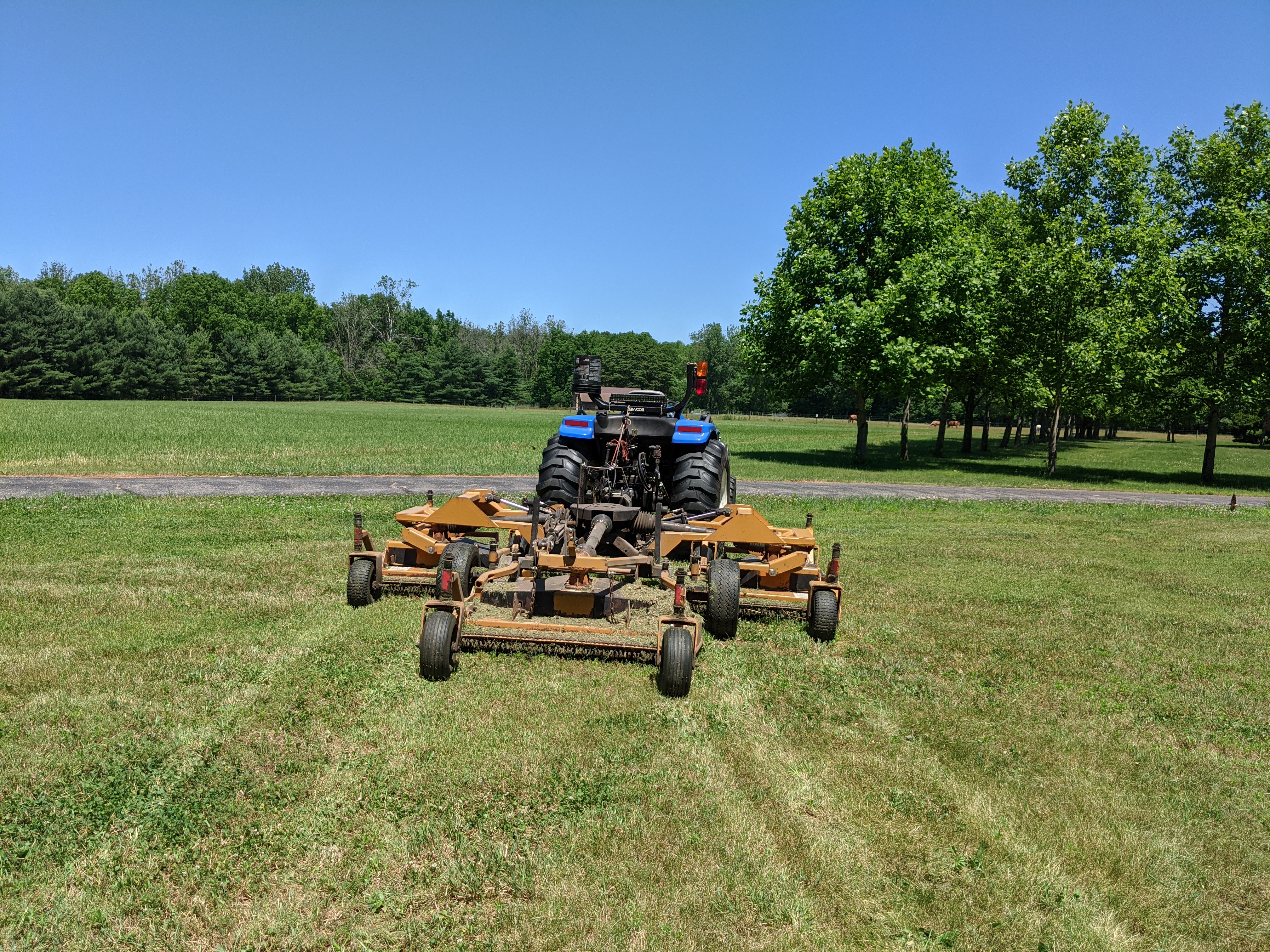

I mow with a combination of a 60” Lazer and a 15.5 foot progressive behind a Kubota L6060. Both are great at what they do, but not in any way interchangeable. I will mow along fences trees and buildings with the Lazer and knock out the open areas with the progressive.
I would say that the Lazer is at least twice as fast as a tractor with the same size mower.

It doesn't take long to mow an acre with my 12 foot mower. My wife uses the 60 inch zt to finish.
