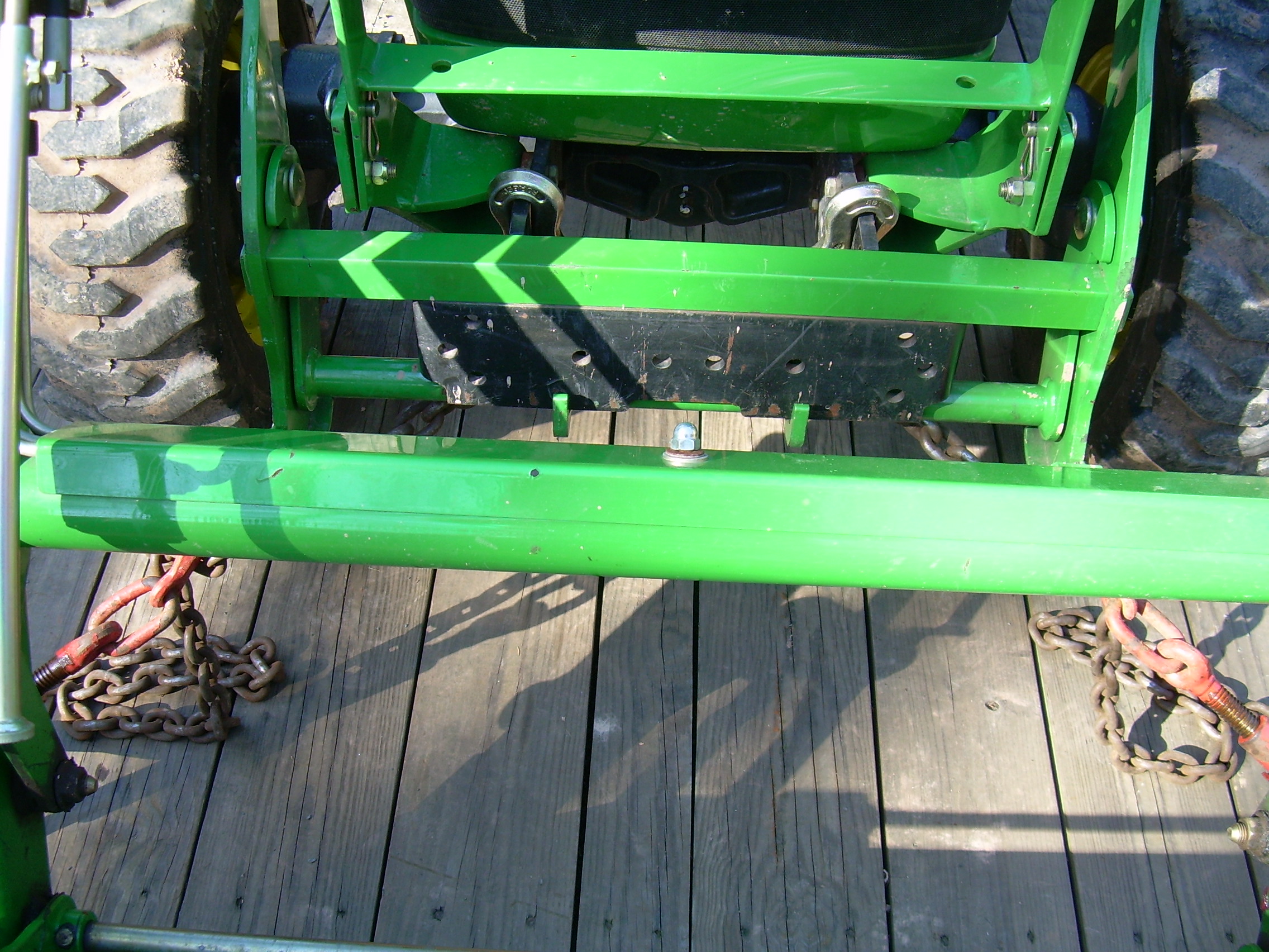

   / Time to re-deck my trailer #33
Looks great, better than new, I learned something, to make it easier I see you did one board at a time. I was thinking you lay all the boards down then you'd have to keep climbing under and back for every bolt, much easier I see now to work from the side in the opening.
Might consider reinstalling that angle iron over the board ends just for that little protection it provides them, I don't think the water trapping concern outweighs the benefit.
My PT deck is drying out and cracking a little so I'll be preserving with something, got plenty of diesel so if that's the way to go, all the better.
#34
Thanks everyone. The oil and diesel mixture is what I was trying to remember, but kept coming up blank when I tried to think of what others had used. My experience with the more traditional wood sealers has been rather disappointing.
I've built quite a few wood decks for clients here in East Texas, and most of them are decked in 5/4 PT wood. The first one that I did here was back in 02, which is before I bought this trailer. That deck is in great condition and there is no sign of rot or decay. The boards have shrunk a fair bit, but otherwise, with nothing added to them, it's doing fine. Why that wolmanized wood rotted out on my is sort of a mystery to me. It either has to be because it is just inferior to PT wood, or that angle iron at the end is holding moisture and allowing the end grain to rot without me being able to tell. Once the rot starts, it's all over. I thought that a metal plate at the end might help protect the wood, but don't really know if I need it or not. I only use the trailer a few times a year and mostly to pick up culverts or a lumber that's too long for my truck bed. I'm building a deck next month and will need it then, but otherwise, it just sits here for months at a time. I keep it at an angle so that water runs off of it to the rear, which just makes it worse for catching and holding water with that angle iron over the boards. Without that angle iron, I think that the water will just run off of the wood and the end grain will dry out rather quickly.
If I'm wrong, I'll post pictures and hopefully a solution to the problem. For now, I don't see a need for the angle iron, and will keep it in my scrap pile. It's painted red, so I'll know what it's for if I need a piece of angle iron.

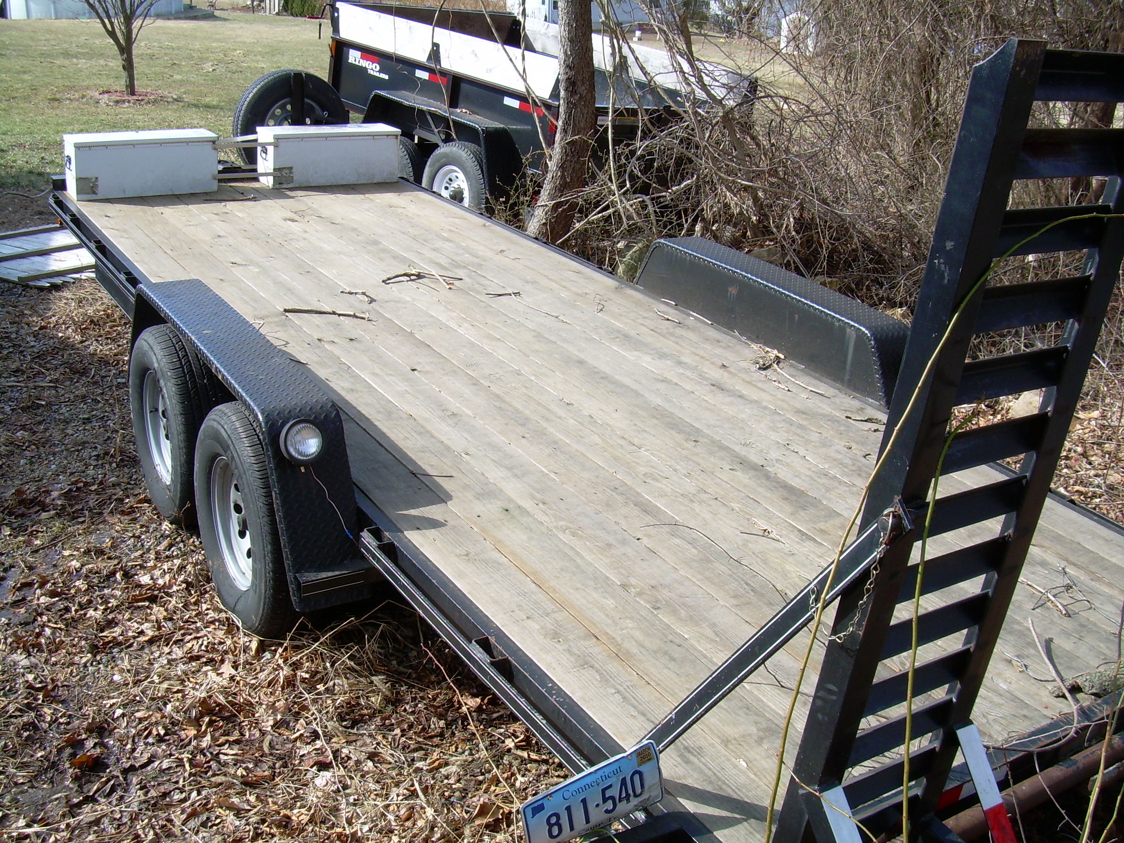

   / Time to re-deck my trailer #38
here is the picture of the deck dad and I redid last year. note the metal strip in the center, it covers the ends of the 8' boards.
#40
I think the picture of your trailer shows the problem that I had with mine really good. At the end of the trailer, near the ramps, there is some build up of dirt. I think this is why the boards rot out at the ends. The dirt, or leaves, or whatever it is, gets under that angle iron and holds moisture there. Over a short period of time, the boards start to rot. The more I think about it, the more I feel that it's the biggest problem for the wood decking and the reason the boards rot out. Compared to a wood deck, the wood on a trailer should last just as long. I'd expect 20 years out of it and was really shocked at how quickly the previous wood failed.
