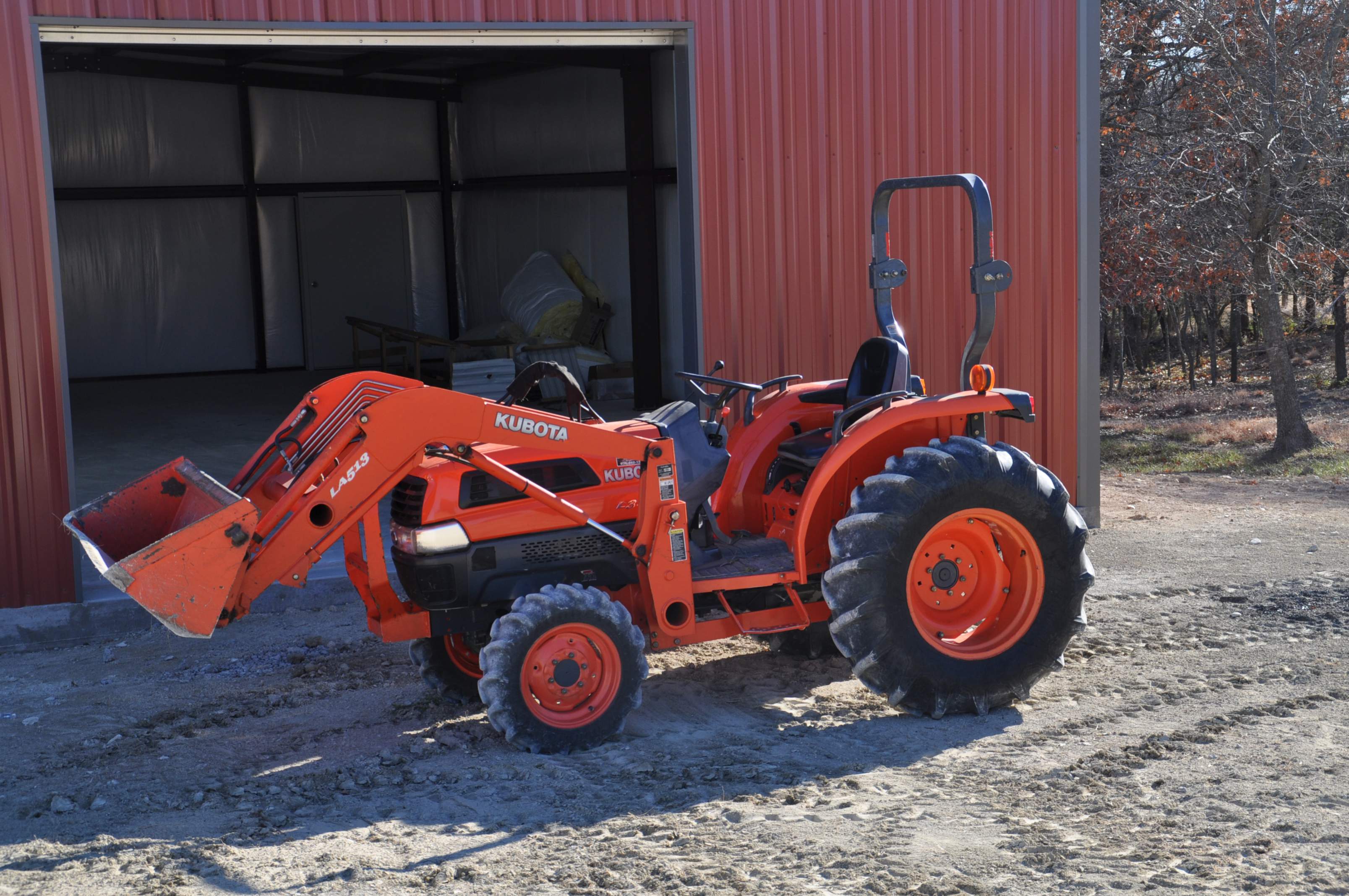

Here is what I have. Ag tires. outside rear to outside rear is 6ft. No HST. Got the shuttle shift.
Just looking at this picture. I wouldn't even have my loader on the tractor without counter weight on the 3 pt. Running a tractor that way will be rough, with a lot of bounce and tipsy and no traction in the rear and will kill the front end...
Good choice on tires and width. Too much pressure in those rears Im betting, and not enuf weight on them for sure. It would be super cheap and easy to fill them with water. If not already loaded that would help. You do need counterweight on 3pt too.

I second rear ballast and loaded tires, I have both and still lose traction sometimes with a backhoe on the back.

I took that picture when I first got it. I either have a box blade on all the time or the bushhog.
   / Time to Sell Tractor? #35
That box blade looks like mine, which is light weight. Add about 400-600 lbs to it and you'll have a different acting tractor. The blade and tractor both will work much better!!!
Are your rear tires loaded?

My tires are not loaded. Not even sure where I would do that
Any tractor dealer and most any big tire place that handles tractor tires. It would make your machine more stable and add traction.
Loaded tires are great, but ya still need counter ballast on the 3 pt for FEL

Back yard faucet. Garden hose and fill adapter.
He might get away with just water, but his town is pretty far north. Of course it would take quite a cold spell to freeze the total mass of water in the tires. 5thgentexan, how many days in a row do you guys have below freezing? or do you garage your tractor, and it would not matter.
