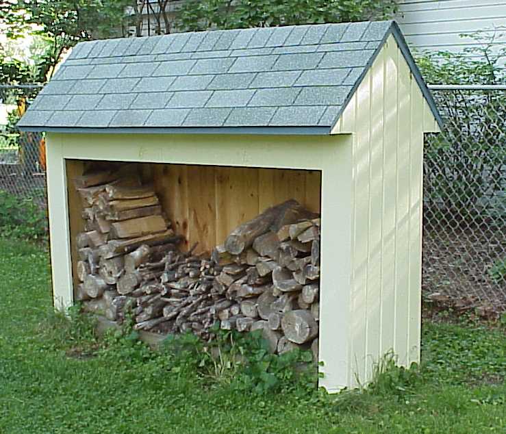

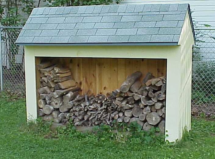

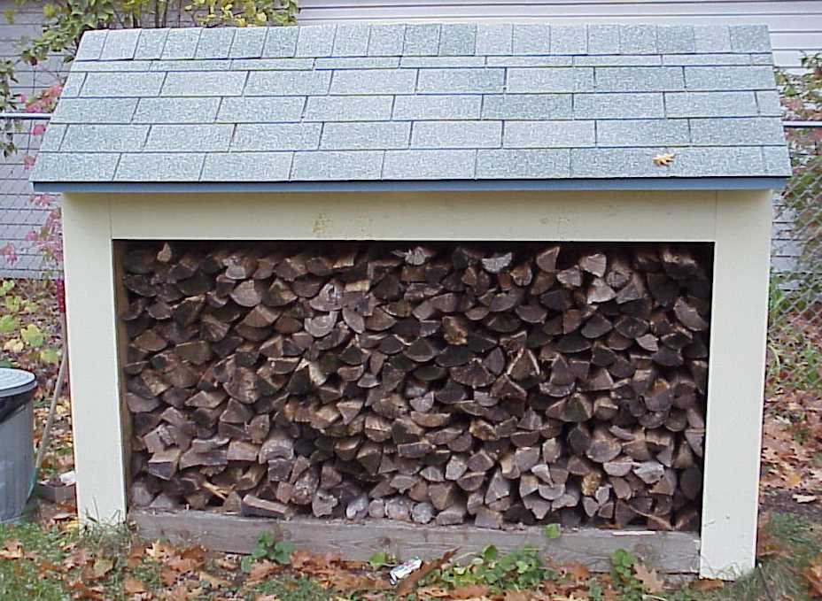

You did good Cliff.
I know most folks want instant product. But there's something special about things that take time and effort.
But you already knew that! /forums/images/graemlins/grin.gif /forums/images/graemlins/grin.gif /forums/images/graemlins/grin.gif
   / Tiny timber frame wood shelter #18
Very nice work. You definately have more patience than me. Thanks for the pics.
Randy
#19
Patience is a big part of timber framing, so you make your objective to get three more joints done, rather than getting the whole frame done. This way it seems like you are progressing right along. Also looking at a few timbers laying there all neat and cut is very gratifying.
Like the title says, this is a tiny frame. It's only 8 feet long by two feet deep. I didn't need any braces. Doing a project like this doesn't take as much time as you might think, but it feels pretty good anyway.
Thanks for the kind words everyone,
Cliff
