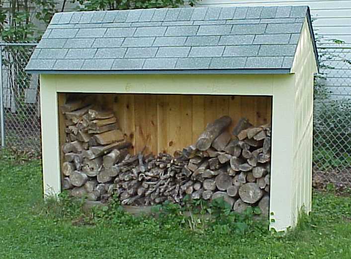

Here's a picture of the finished project as promissed.
Cliff

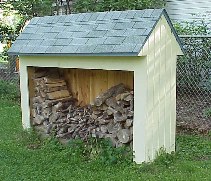

And one more.
Cliff

I think I'd be real careful sticking my hand in there for firewood. It just might bite, the firewood. A home that nice would be very very hard to leave.
You do very nice work.
   / Tiny timber frame wood shelter #26
I believe that might be the fanciest woodshed I've seen. /forums/images/graemlins/wink.gif

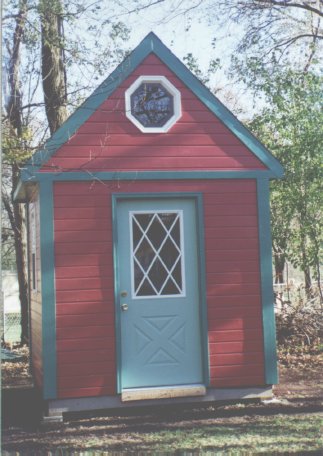

Actually, since our neighbors are pretty close, and we are a bit too rural for them already, I felt like I should make something nice for the yard. It turns out that we get enough drop and chop from the trees that, while I take wood from this little shed for the fire because it's dry, I have most of my wood in a big pile further back in the yard where they don't have to look at it.
I've attached a picture of the other outbuilding I built about ten years ago. It's an 8X8 garden shed, but I wanted something that added to the property, not detracted from it.
Cliff

Cliff, what kind of wood did you use (and what are the dimensions of the posts)? Did you / would you consider making something like this out of pressure treated 6x6 landscape timbers?
#30
</font><font color="blue" class="small">( Did you / would you consider making something like this out of pressure treated 6x6 landscape timbers? )</font>
Yes/yes
Specifically, I used 6X6s from Menards that were treated to refusal (that is, only on the outside) and the 8 footers were $10 a piece at the time. They were also still a little green (as in wet/new) so the cutting was a bit easier. I set the frame on buried concrete blocks so they don't stay wet. Any wood would have worked. These were cheap and using PT wood seemed like a good idea. Use a mask if you're using a power saw.
If you have any trees on your lot that your dropping anyway, it would be a good opportunity to hone your broadaxing skills and chop them out of tree stock. /forums/images/graemlins/crazy.gif
