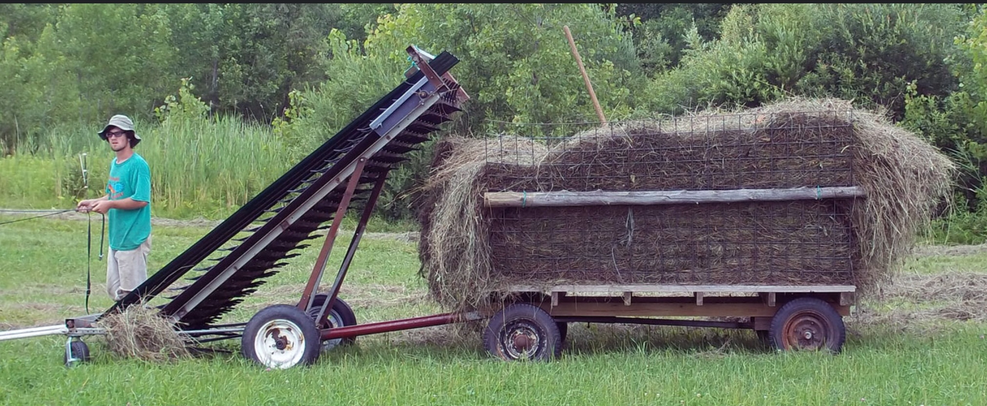

Look at what some Amish do using 1 or 2 horsepower to get hay to the barn. Found this picture on the internet:
That is ultramodern. "When I was a kid" (50's) we raked the hay into rows with a horse drawn rake, piled it into "shocks" by hand with pitch forks, then pulled the shocks by rope/pole/horse to a location where a pole was set into the ground and the hay was stacked around the pole. The stacks were done such that the center was packed tightly and about as high as a long pitch fork and a strong Uncle could boost the hay up to the top. Once it settled it shed water fairly well with only some loss and lasted all winter to feed the cattle.
