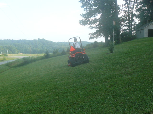

I have just one steep spot along the road. I mow it with my B3030 that has the rears filled with Rimguard. I never felt like I was going to tip over, but just to reassure myself I stopped the tractor on the steepest part, got off and stood on the high side and pushed on the tractor to see if I could get the high side wheel to lift off the ground. No matter how hard I pushed or rocked the tractor side to side the high side wheel never even came close to lifting. That satisfied me that I had nothing to worry about. I still slow down when I mow that area, though, just to be safe. You are smart to trust your feelings when it comes to safety issues. Better safe than sorry.

you might get an incline gauge, as discussed often here (R&B). Tractors have a high center of gravity and no suspension, and just don't like being sideways on a slope. 15 degrees is considered max. 10 degrees is as far as I'll go on the little one, the big tractors wider stance and more weight seem to take a lot more.
