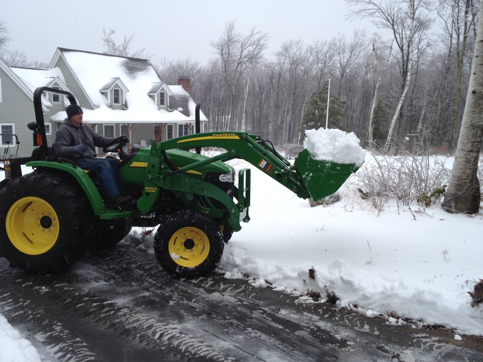

I don't think I could have done it in under 3 hours, I don't know how people do it with the FEL???image.jpg
This snow storm here in northern CT was as bad as it gets. I'm farther east than you, so we got 3-4 inches, but all the rain made it like plowing stiff slush. I plowed with the Gator, and it got a serious workout. One tactic I used was to make a first pass with the plow elevated, then a second clearing pass with it on the ground. I had a few places where the pile stopped me dead, and I had to slice off the end - making 4 or 5 passes- to clear it out of the way.
To summarize, this was a once per year "snow". You likely could have moved 20" of regular snow easier. See what the rest of the winter brings.
I tried to make 2 passes, but if I left anything after the first one I wasn't getting traction to move around on the hills.
