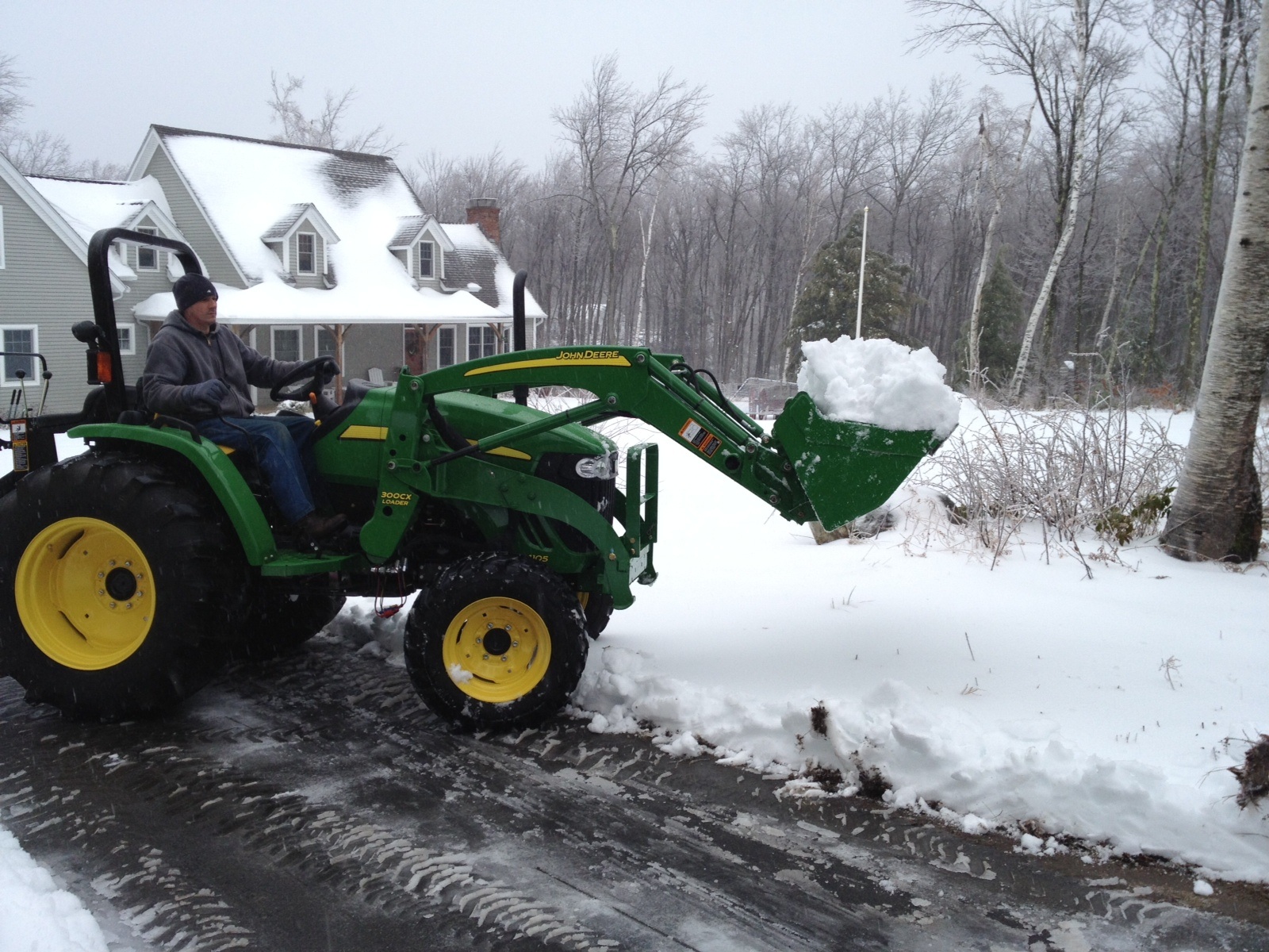

We got another ~4" of snow last night. I plowed the driveway with the plow truck and then took to the tractor to clean up the areas the truck doesn't do well and to push back the banks.
I am definitely getting better. I am finding that float works best with the bucket angled driving in reverse. I can peel snow away from the front of the garages very nicely.
Going forward I angle the bucket a bit more shallow and drive forward modulating the down pressure to keep the front wheels steering and driving.
