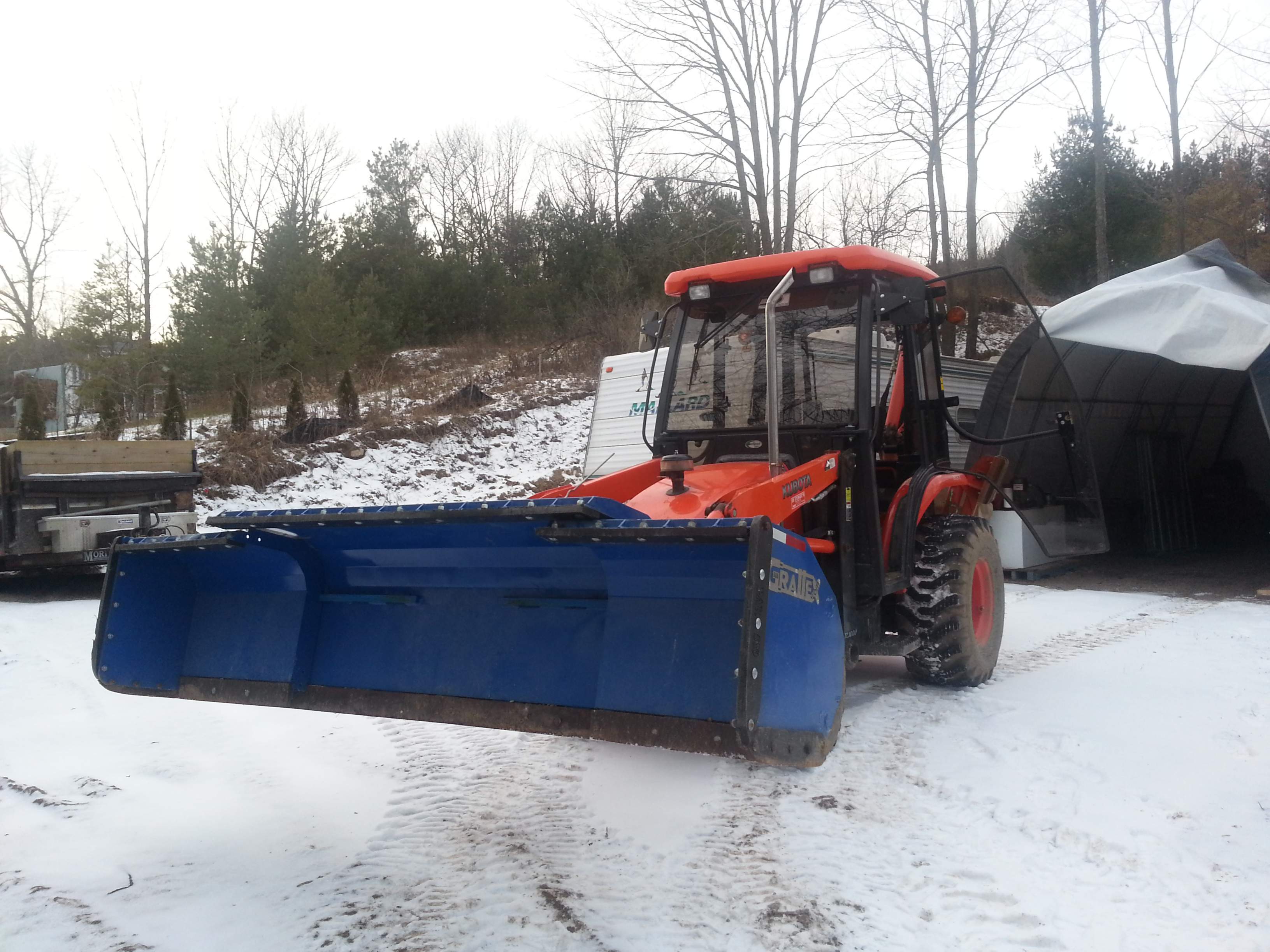

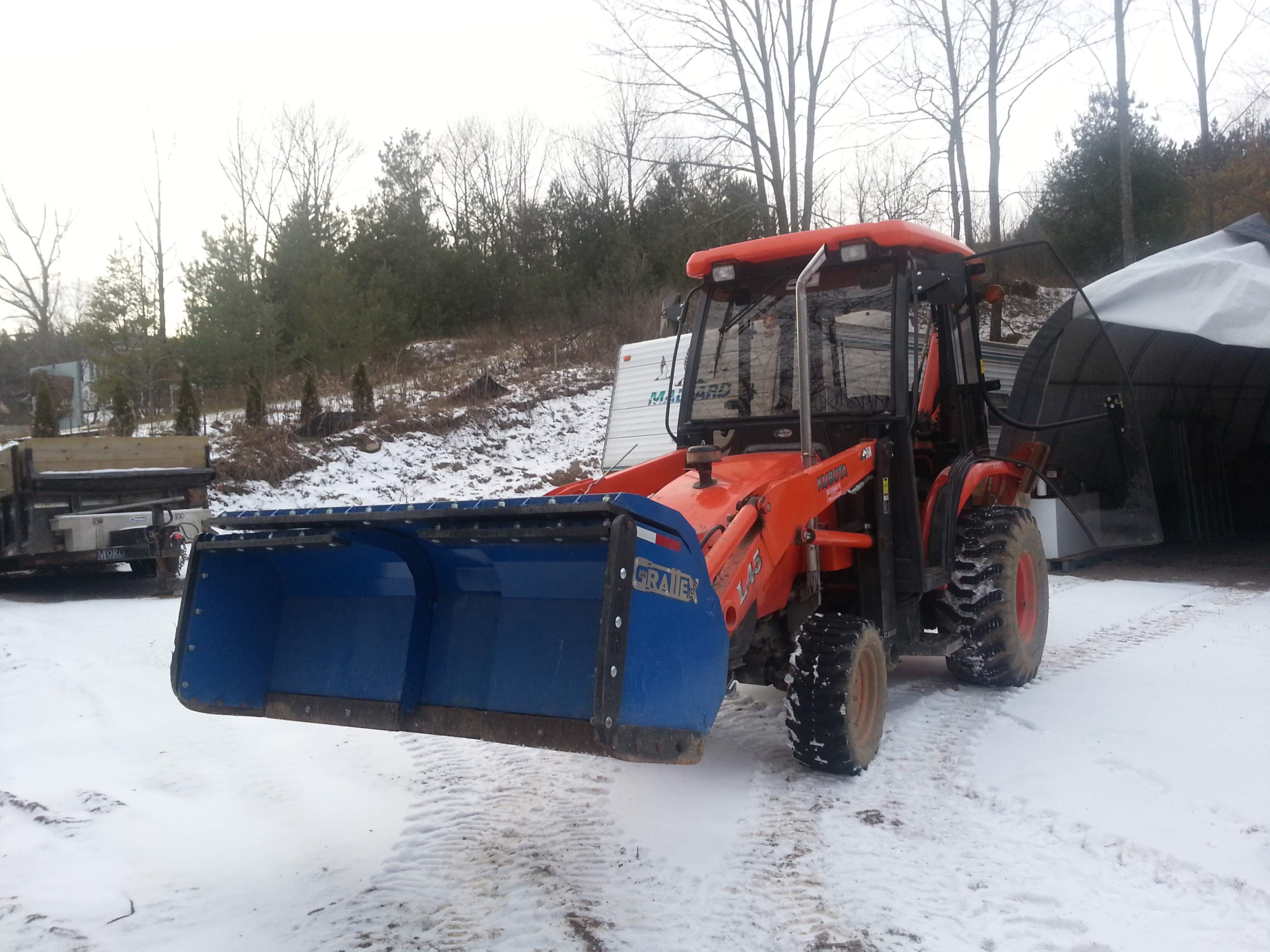

Hi avc1830
I have had a Kubota B21, B26 and I now have an L45. I clear about 1/2 of an acre on my property which is all gravel. The driveway is about 250' but I have a large parking area in front of my 42' garage and a loop around to the front of the house as well as a couple of parking spots beside the house. My slopes are probably not as steep as yours but my property rises about 8' from the road to the back 250' feet away. I initially had a Suburban with a plow which I liked because of the heat but I found there were so many curves and loops on my property that it was difficult to clear effectively with the Suburban. I then tried using the FEL and I experienced the same problems you are have encountered.
I live an hour north of Toronto and I find that in the cold weather the float on all of my Kubota's does not work well or fast enough. I too have seen my front wheels lift off the ground when I go over a hump because the oil in the loader arms does nor respond fast enough to float up. I have also found that if one is going forward when this occurrs the problem is worse because you have the load of the snow in front of the blade trying to stop the tractor and the rear tires pushing and as soon as the front tires start to lift if you stay on the throttle the engine torque wants to push the front end even higher. I find in the cold that floating in reverse works better for me.
That being said, I cleared the snow form the 6" - 8" snow storm we had this week with the L45 and I was really impressed with it. I always had traction issues with the B21 and B26 but I didn't have any problems with the L45. I always have had loaded tires on my machines and the L45 has 932 pounds of foam in the four tires, the backhoe with the 36" bucket on for ballast and I now have the Laurin cab installed which probably adds another few hundred pounds. The L45 is the first machine I have had that I could start at the road in M range and just drive the 250' from the road to the back of my property pushing a 9' wide swath of snow the entire distance without stopping. I still have some steering issues though so I too am considering a set of chains for the front tires but I clear a few paved driveways so I want chains that will not do too much damage. I look forward to hearing how front chains work for you. I can't tell you how nice it was to be warm and dry as I cleared snow for three hours the other morning starting at 5:00am with the wind blowing at 20 MPH and the temperature around -8 C - but that is another story.
As mentioned I have a large parking area and I did not want to install an angling blade on my FEL because I was concerned about side pressure on my loader arms. I also have steering issues now with a straight blade and I think this would only get worse with an angling front blade. Instead I purchased a snow pusher blade a couple of years ago and I really like it. It has hydraulic cylinders to extend it from 66" to 108" with fixed side gables and it has a top on the blade which makes it reversible. This blade moves a lot of snow in a hurry. It used to take me about 2-1/2 hours with the Suburban or the tractors with the factor bucket but now I can clear my snow in an hour. The reversible option is great when you need to get snow out of a corner. I use to carry bucketfuls of snow away which took a lot of time but now I just roll the blade forward and pull is all out. A nine foot wide blade two feet high pushes and pulls a lot of snow. The extendible aspect is nice around buildings, curbs and rocks because the blade is wider than the tractor when you are pushing next to the object but when you need to back up you just retract the blade and you are a safe distance away from the imovable object. This blade was probably a bit too much for the B26 but it seems to be the perfect size for the L45.
There are very few places near the house that I can pile snow and since my property is gravel and will stay that way I gather the snow it off to the side of the garage and then push it all to the back of the property. This means in the spring all the gravel is in one spot (and not on the lawn) for me to fix the low spots. If I were you I would look at a pusher blade rather than a rear blade - it is a lot easier on the neck too. And even though there is no bottom on the pusher, if I lift the loader arms as I hit the pile I can easily creat piles 6' - 8' high. Here are a couple of photos showing the blade retracted and extended.

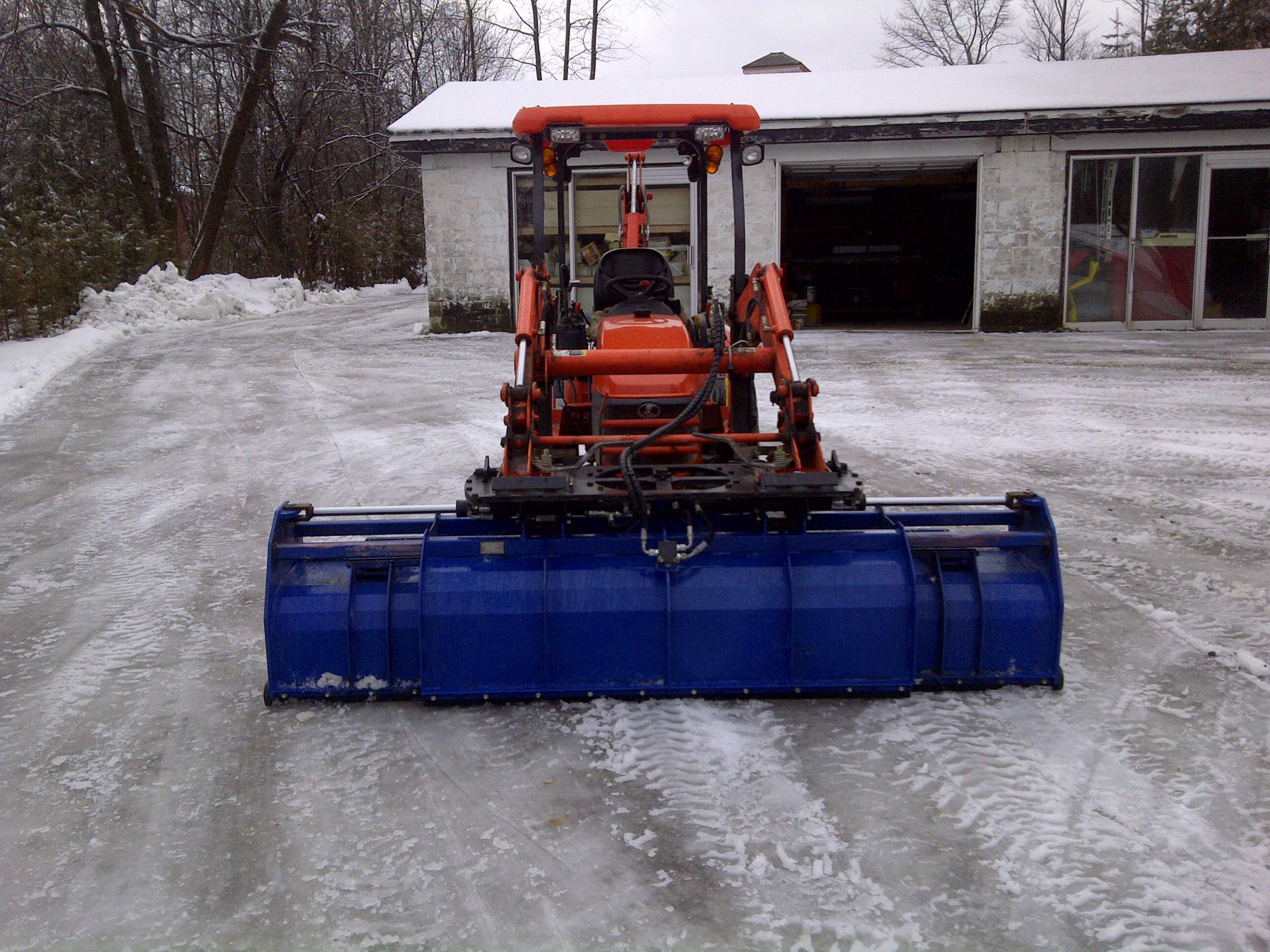

Hi avc1830
Regards,
Lauren

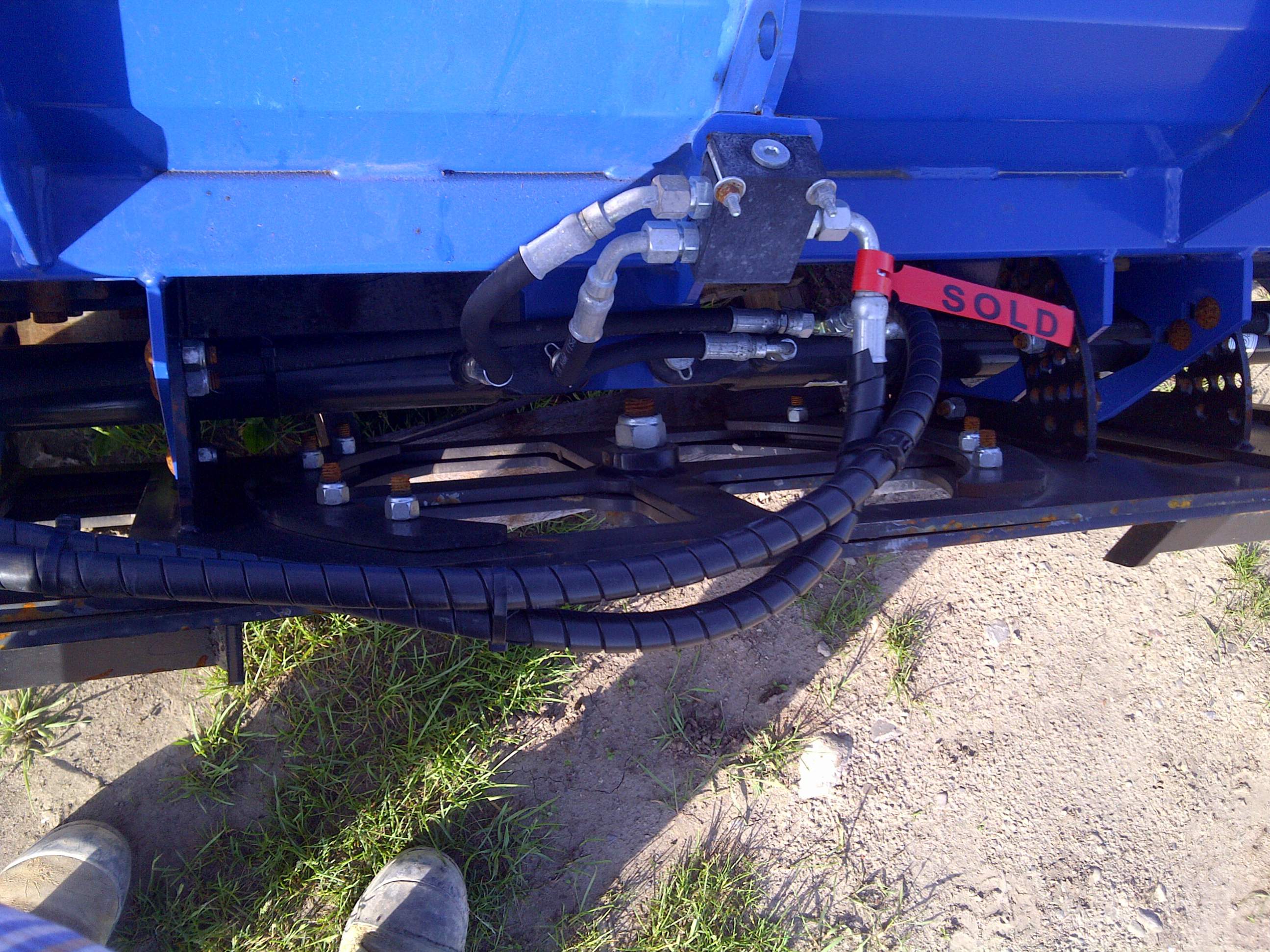

View attachment 295087 View attachment 295088
More pics of the pusher blade! How do you extend the wings? (i.e. what sort of mechanism?)
Your tractor almost looks like a snow groomer from the down hill ski resorts! Pretty cool! What about the cost?

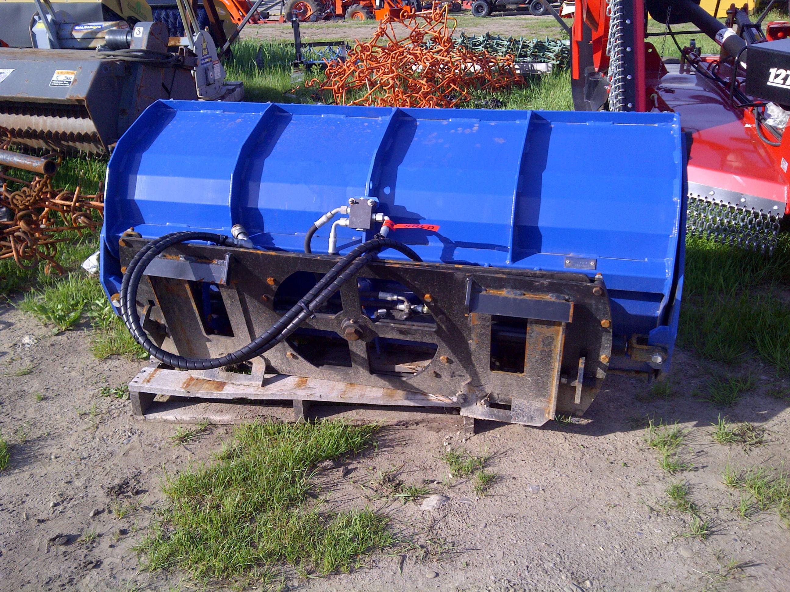

Hi FatTire and yelbike
Attached are a couple of additional photos of my Grattex (Grattex) blade. One is a shot from the rear showing that mine has the swivel option. There are two 5/16" or 3/8" thick plates at the SSQA that are held together by welded tabs on the edges and a 1" diameter central bolt. This enables the blade to swivel up and down independent of the tractor angle. The second photo shows the blade reversed and extended on my old B26 and you can see the cylinders which are connected to the front remotes on the B26 and now the L45.
I was lucky enough to get mine used (which is why it is blue instead of orange) but when I spoke to Grattex my blade with the swivel option, reversible and extendible plus the softer plastic or composite edges rather than steel costs around $4,000 new.
