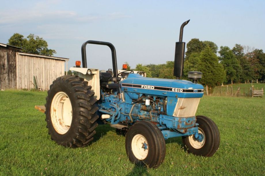

Keeping the load low, that certainly makes sense. COG and all that, very important. Going slow, while against my nature in most circumstances, I can see is a must. Sublte direction changes... all great advice. I will, by the way, read the manual as I am getting a new BH 2246 (I think that's the model). Here's a shot of my tractor, it's a 6610 II and does have filled tires:

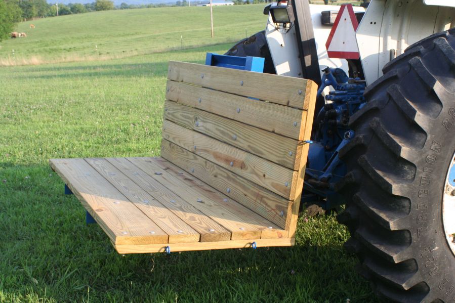

One thing I hadn't thought about was having something on the 3pt. I don't have very many attachments as options there. Most of the stuff I have is light weight (I can pick it up), however I could load down the carry all you see peeking out the back of my tractor. I have a pretty decent sized rotary cutter, but that seems cumbersome to have back there while using the loader. I could pick up a round bale with a spear, that's certainly heavy, but doesn't seem very secure as it could slide off. Hmmm.... this carry all has a 1,000 lb capacity. I could load cinderblocks or something and strasp down with a ratchet deal. I did include hooks just in case I needed to strap something down. Do you think with filled tires (big filled tires at that) and a moderate load on the carry all that would be a good combo weight wise?
