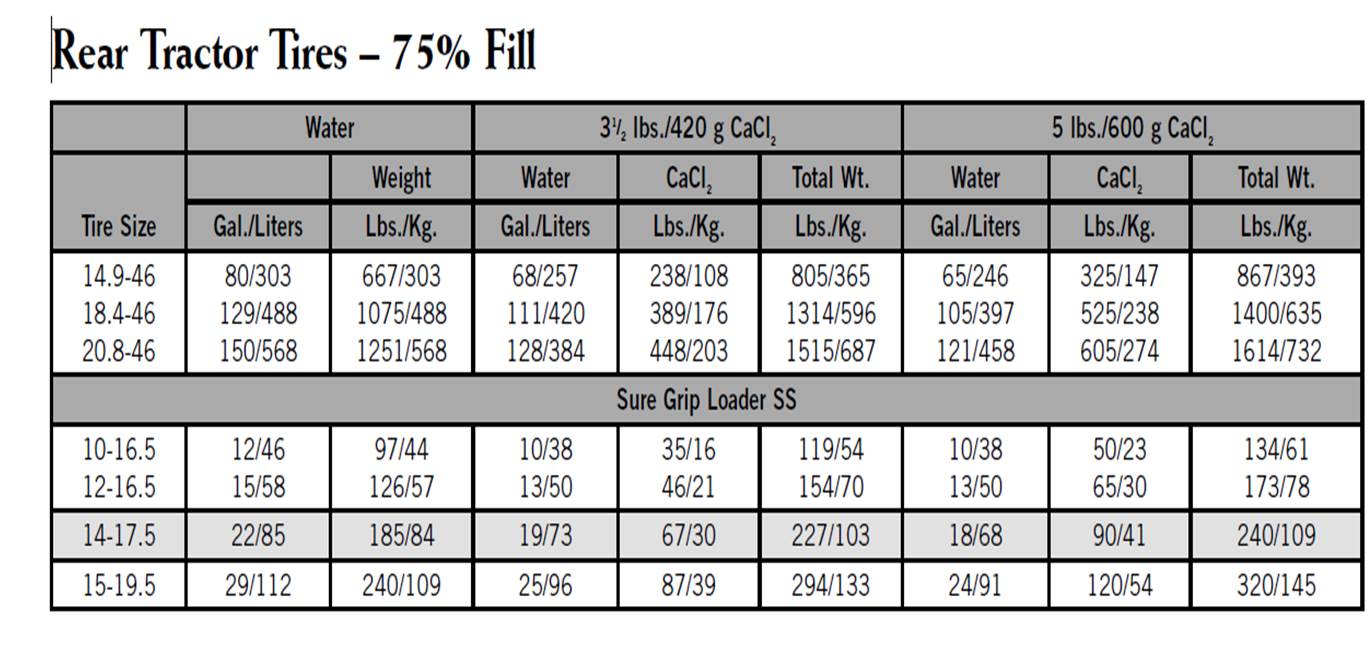

Does anybody have a chart or a link that relates the tire size to the weight (of the liquid ballast) that they will hold?
Example: This size tire holds x gallons, x gallons weighs y pounds.
Is there a standard on how full the tire is filled. 80%?
/ Tire ballast weight #3
Here is a list someone else posted for Titan tires of various sizes

One size I can comment on because I just filled mine with WWAF last weekend is a 8.5 x 24, it holds 45 liters each, level to the valve stem at the 12:00 position, and adds 90 lbs per tire.....Mike

I was wondering on the weight of liquid ballast, because another poster here with a 5075 was calculating the weight of his tractor in order to size a trailer and listed tire ballast as (I think) 1000lbs total, for 2 tires. Whereas, I was thinking each tire was around 800lbs. This link Rim Guard - Liquid Tire Ballast says 16.9-28's are 700 lbs + each.

The tire ballast chart from Messicks says that your 16.9x30 rear tires will hold 609# per tire (water ballast)+ your 190# of steel weights would just about get you to the 1500# per tire per manufacturer. I rather doubt that using the max ballast in tires and the 2000 # rear 3PH ballast is required to operate your FEL safely in most instances. Perhaps if you are loading it to the max capacity of lift at all times you would need that amount but hardly anyone uses their FEL lifting the max capacity ALL the time. The 2000 # ballast on the 3 PH needs much clarification, ie if you have a ballast box staged basically between the lift arms, you wont get as much counter-leverage off the front wheels as having a 2000# bush hog or other long implement hanging back behind you. I would dare say that a 1000# bush hog would give as much countering force as a 2000# ballast box.
