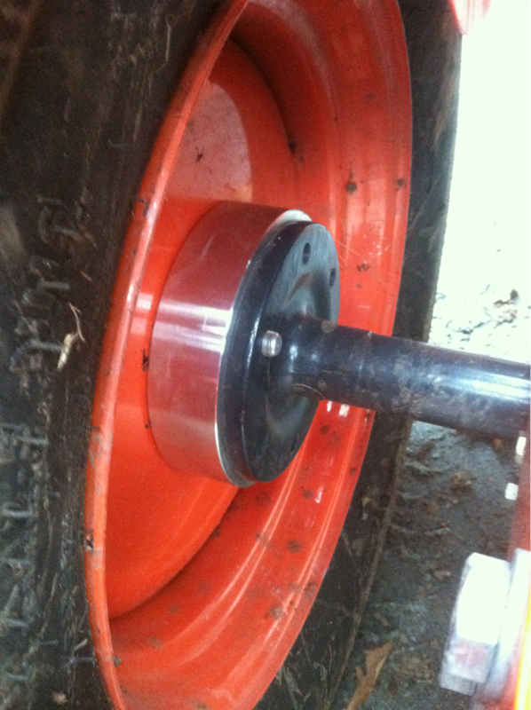

   / Tire chain damage to tractor? #8
Wheel spacers. I added 2" spacers from Bro-Tec
