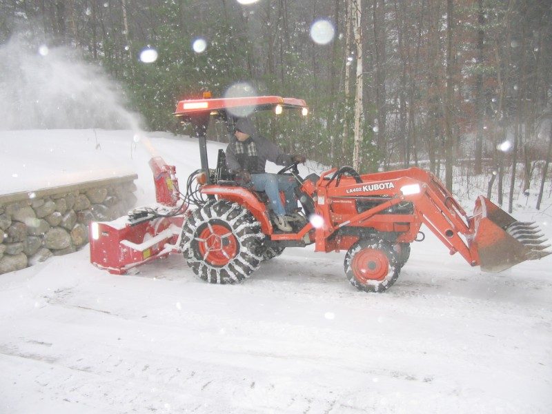

I run front as well as rear chains on my L4330 with turfs. For me, chains on the front are essential. Steering on hilly drive w. ice--can't do without. Ladder-V's on the front, 4-link ladders on rear ...the ride would be lots better with 2-link ladders on the rear, but that would double the weight and I don't think I could put them on.
