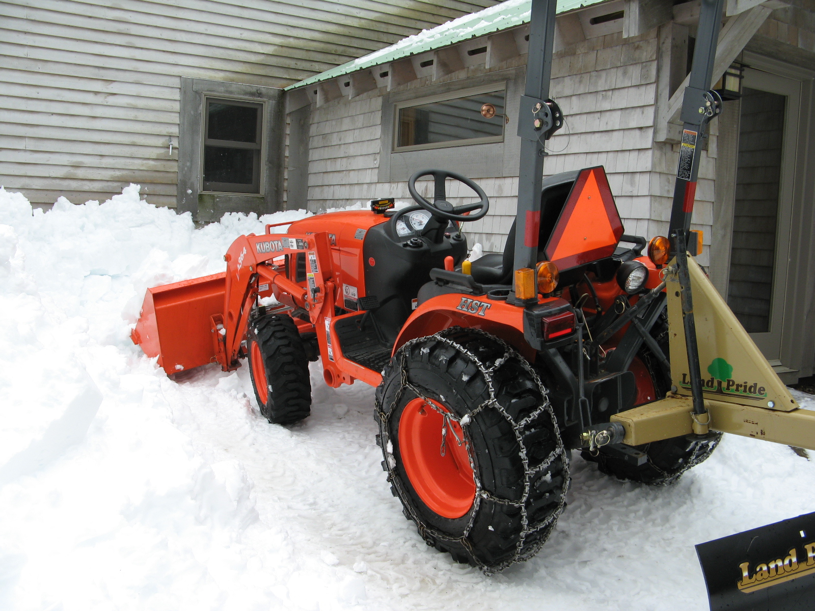

   / Tire chain recomendations #26
How about these? you don't need much clearance for them on the inside and they are pretty aggressive without tearing up pavement. They tell you to leave them loose, not sure why, but I did. They are light and easy to put on. Think you can get them here. Buy Tire Chains & Snow Chains from the Traction Specialistsゥ

   / Tire chain recomendations #27
bstrom yes those are the ones I was trying to find but it seems everyone is out of stock. As far as I can tell trygg, tellefsdal and aquiline make that style.
