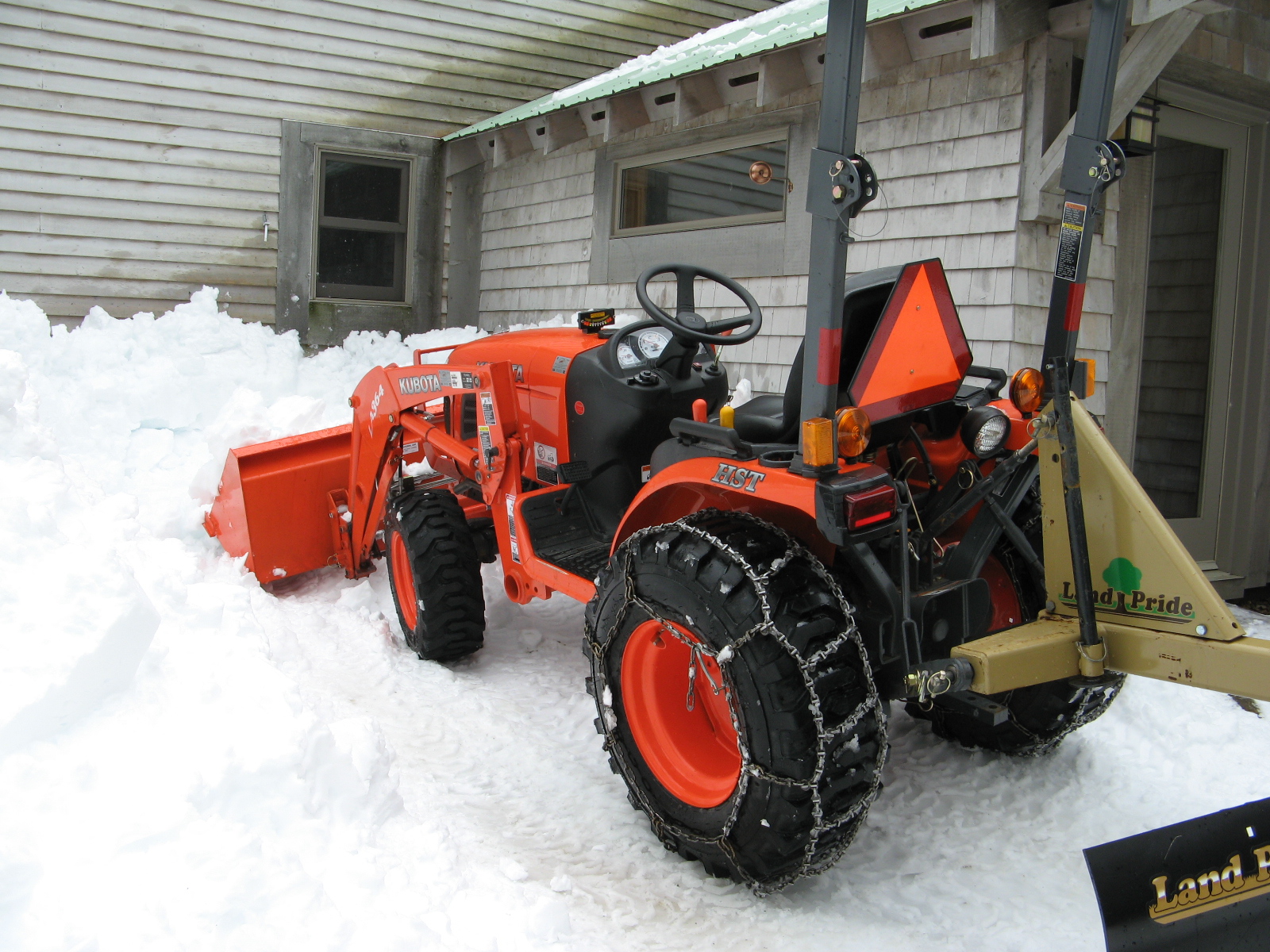

   / Tire Chains for R4 Tires ?????????? #30
I have spacers on my R4s, and I wouldn't want to try to put chains on without the spacers.
I do have chains (front and back), and they make a world of difference on ice and in the field.
I have a BX-24, and I got the spacers from Brotek in Canada. They really help with stability...
