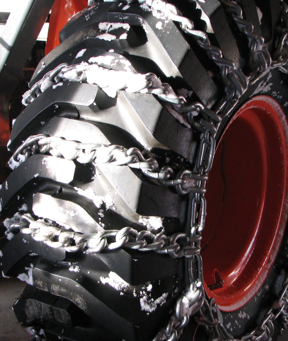

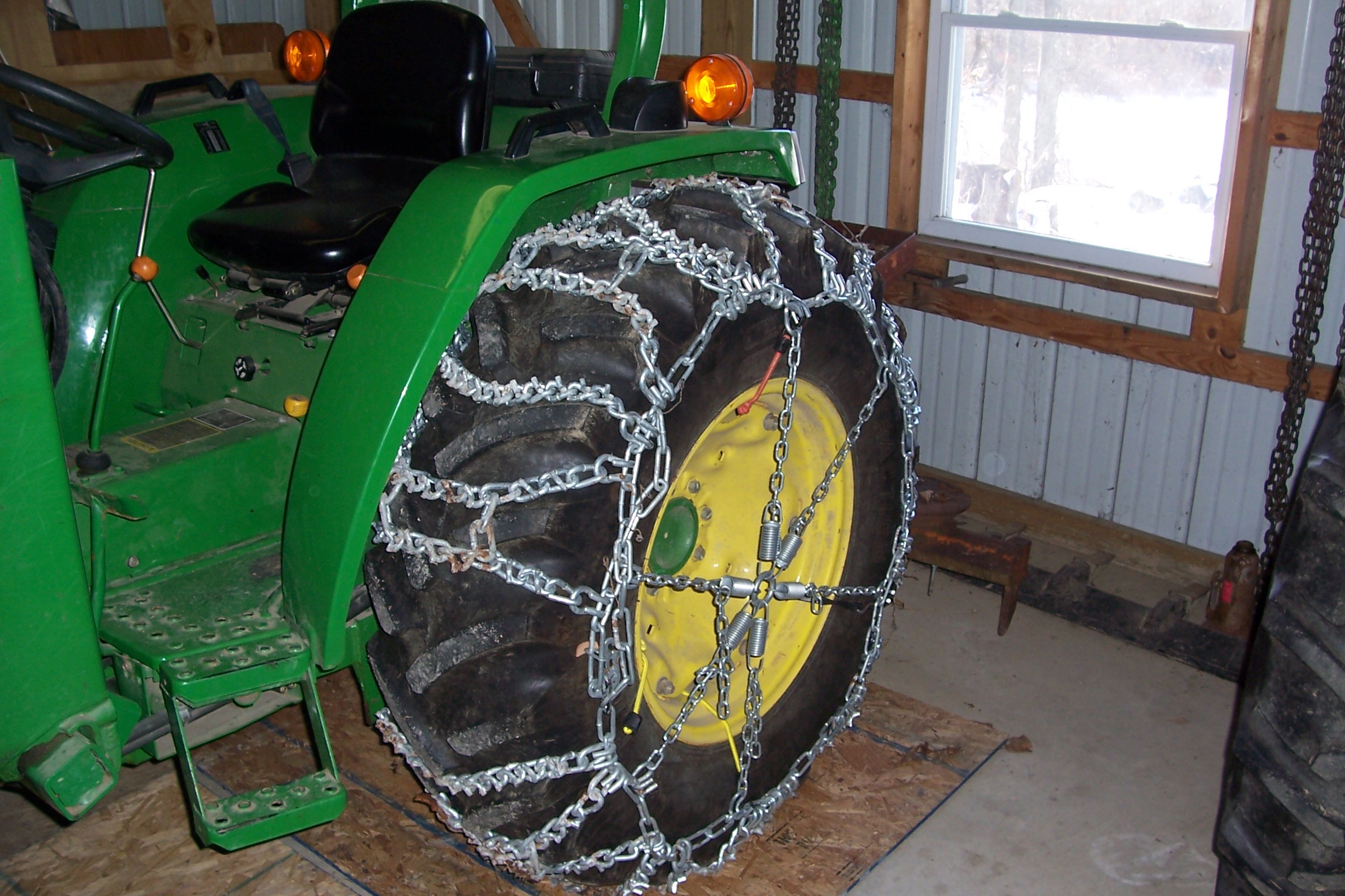

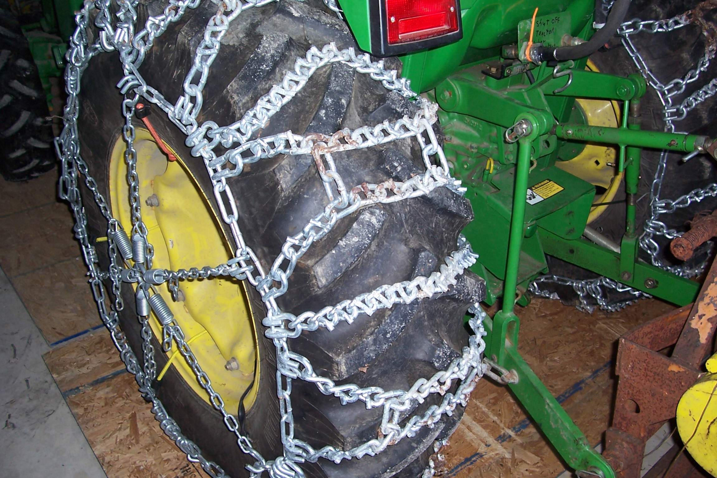

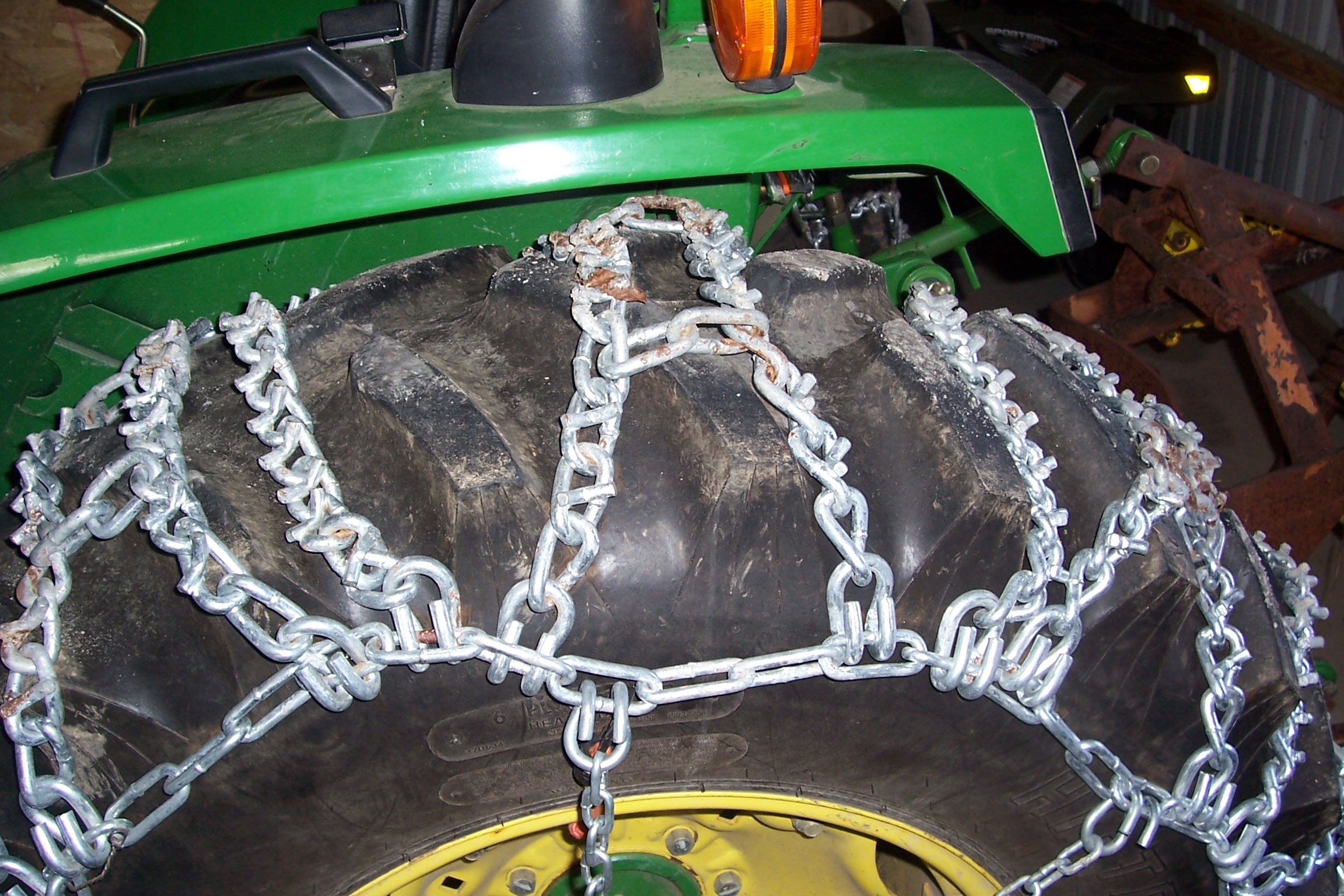

i bought a set of vbar makes a tremendous differance on snow or ice digs into the frozen ground. when i put tractor in barn on concret i drive on plywood so it dont reck the concrete,the 2inch link chains are the best they wount get lost in the weel lug but i was afraid they would hit fender so i went whith the vbar atached in center of weel. 100_4841.jpg

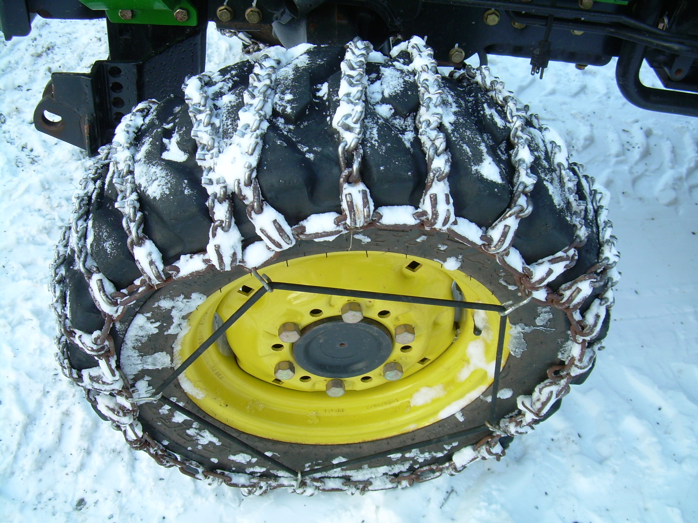

My B7800's rear are R-4 (12.4-16) with 2-Link Ladder
I think that Snow Chain Install Tool would help on chain installation.
The biggest problem I have with installing chains is getting out the slack in order to make the connection. So having something to hold both ends of the chain assy. together, while working the ladders around the tire threads, and being able to adjust the tension as you progress around the tire, should make the job alot easier, and it looks like that tool would work.
I don't have liquid in my tires so on chain installation, both tires are off the ground
(jack stands) all the air is let out of both rear tires, install the chains, then air the tires back up(about 16 psi rather than 20 psi). Chains are nice and tight and they don't move
so I don't use spring tensioners.
Thanks you Jay for pointing out that Snow Chain Install Tool.
Bill

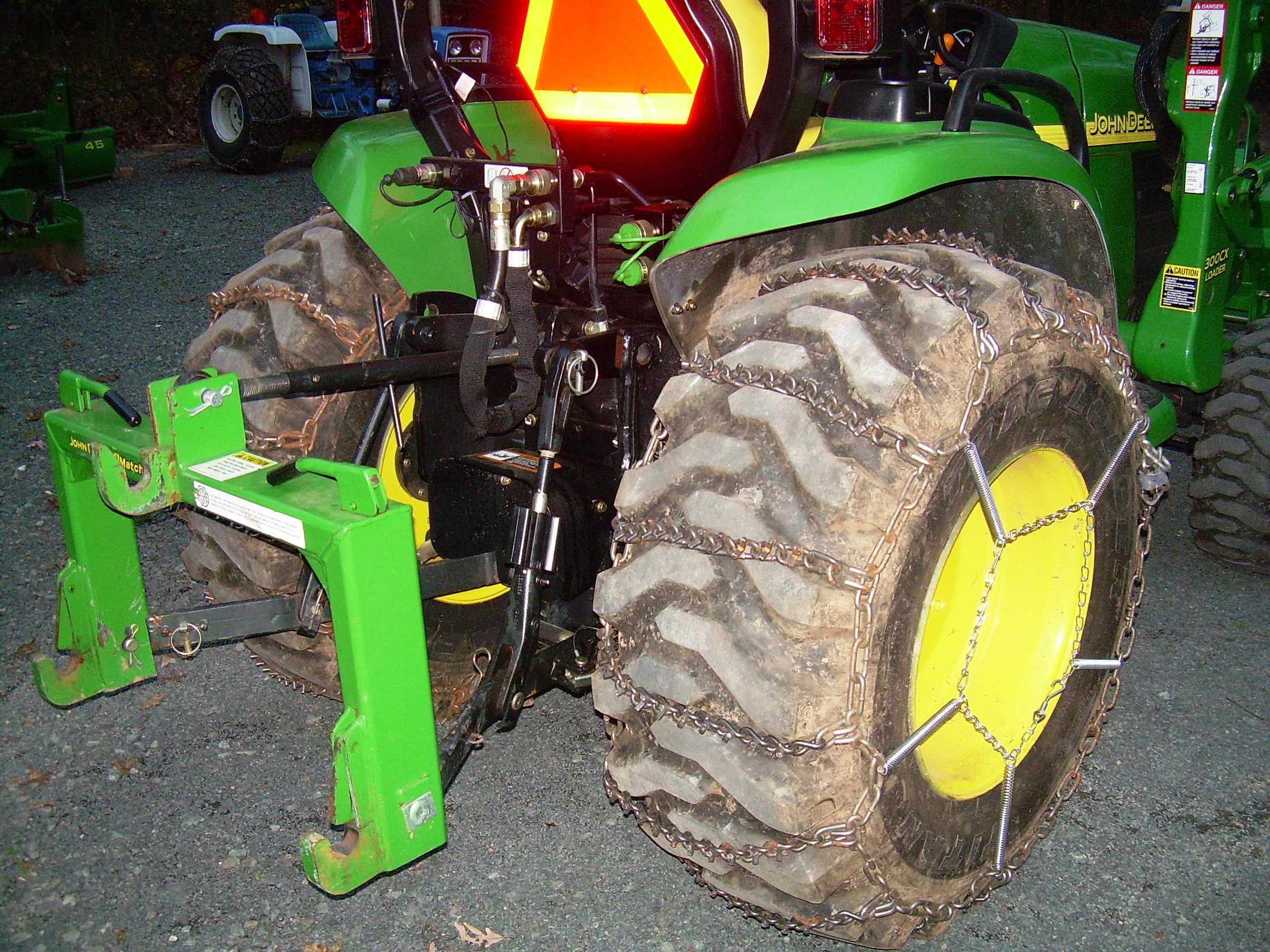

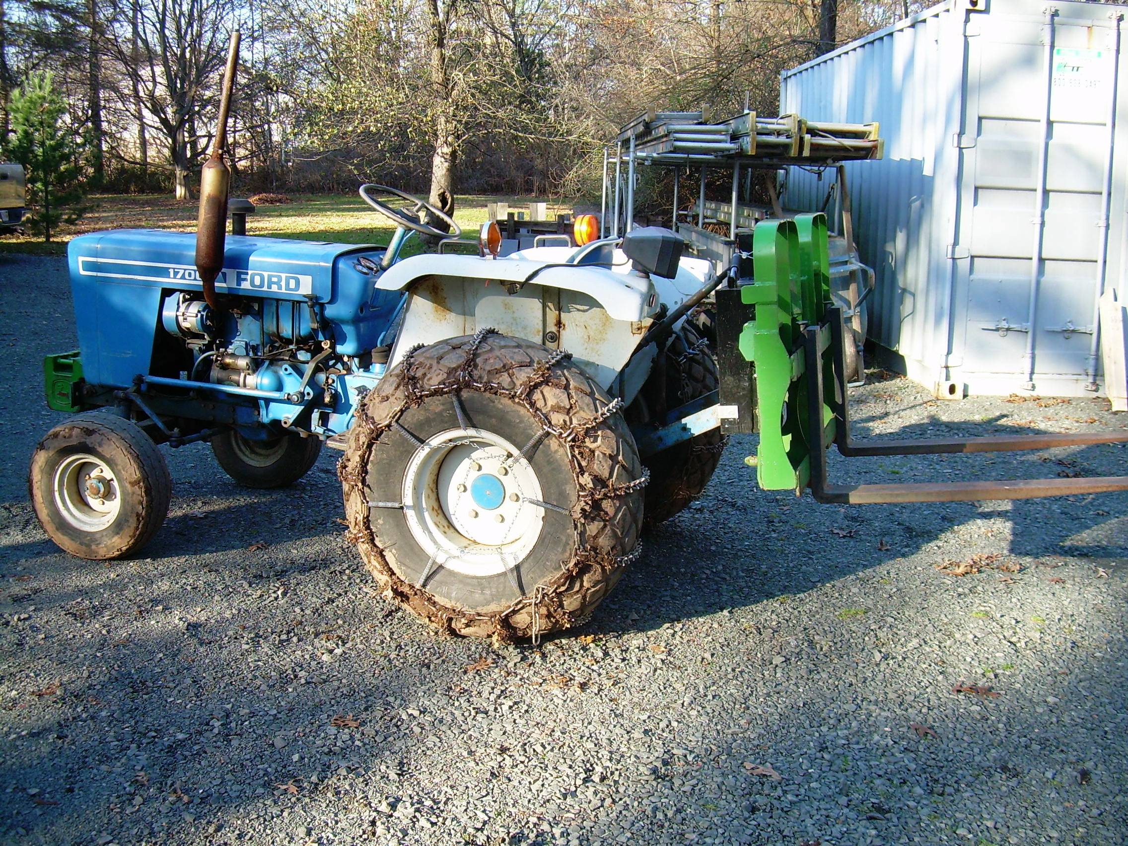

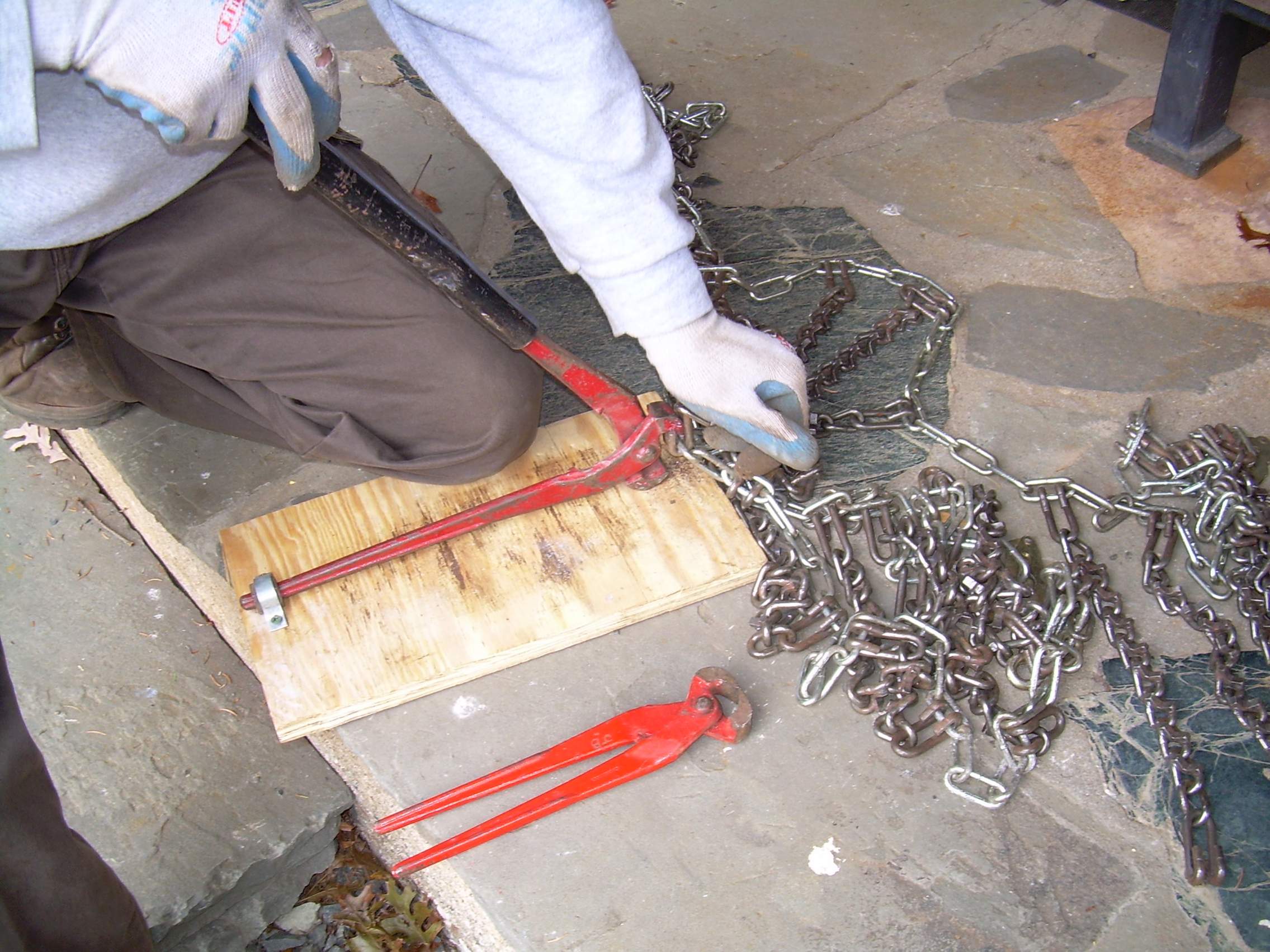

Install tool not necessary, if you want to buy a useful tool get this one, then you can repair, mod or make your own chains.
Large Repair Pliar
By spring tensioners do you mean to take up the slack in the side chains. If so then IMO yes you do need them, you can use springs or bungees etc. Recently I've heard some say they don't use tensioners and prefer a little slop in their chains, not me, I make mine as tight as possible so you can't even hear them, and on some CUTs there is not much clearance for loose chains.

i bought a set of vbar makes a tremendous differance on snow or ice digs into the frozen ground. when i put tractor in barn on concret i drive on plywood so it dont reck the concrete,the 2inch link chains are the best they wount get lost in the weel lug but i was afraid they would hit fender so i went whith the vbar atached in center of weel.View attachment 150355
These pics show a good example of chains that don't fit the tires (one clue is all the chain tighteners pulling the slack out).
Cutting the side chains to the right length, first to fit the inside of the tire, and then the outside (with a couple extra links for tightening/adjustment) would be the first order of business. Think of it as putting clothes on that are too large. They don't look good and don't perform the job well.
Fitted chains do not need tighteners (which get torn off from ice and sticks and rocks) that just cause frustrations. Those frustrations we don't need, and can save a lot of money.
My opinion. :)

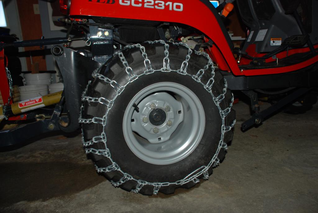

Well, if we are sharing family pictures. here are a couple of mine. :cool:
Looking at them I realized that I could tinker with them a bit more to get them straight(er) and tight(er) - and may do that if/when it warms up a bit.
The weekend forecast is calling for 1-2' of snow, starting on Friday. Sounds like fun! :D
Jay

And yes, I think you need to straighten those cross chains out. :) :)
Nice to see a pic of chains that fit :)
