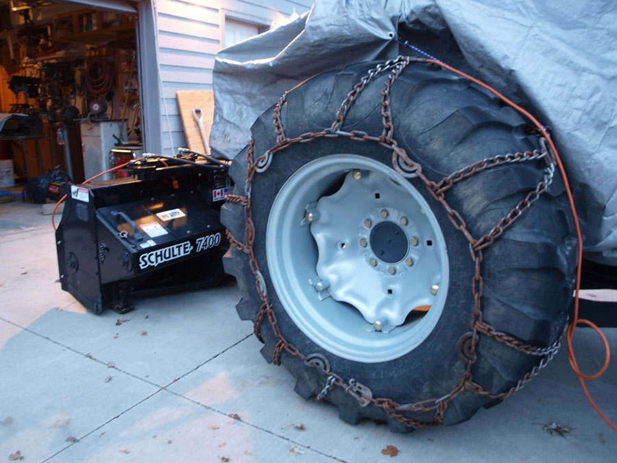

the "new" tractor has 18.4x38s Them suckers are heavy! Should be somewhere around 200 lbs. when extended. I'll probably have to move the wheels out to get cab clearance too. Fun fun! Kim
Just musing about chains this morning. I must be getting old....instead of jumping up and doing the deed I tend to think it through first....
It's probably worth brainstorming on what a proper workbench for chains would look like. No point in wrestling those chains while building them. Particularly not in Ag size. On the workbench some sort of stop or moveable pin is handy to keep the chains from constantly slithering off and heading for the floor. A couple of half inch bolts sticking out of the middle of my workbench were real useful, but crude.
On all the pairs of chains I've built I don't think I've made more than a couple of welds all total. I build by bending the connecting links made for that purpose. It does cost more that way. In the field - and even for new sets - I have used bailing wire quite often to stand in for a missing link. It holds up in use very well. Surprising.
On the Ag tractor it always bothered me when traveling in road gear with the rear chains on. That's something you do when feeding. What if one of those links came loose and tagged me on the elbow? So I mounted a set of really heavy big steel fenders. That did require setting the wheels out an inch or two.
Snow cleans and polishes chains nicely. When I remember to hang them up they stay that way, too.
My welding table has an overhang. As my chains are continuous loops (with removable links) I just draped them over the end of it with the rest piled on the floor. When I shoved a load off the back of the table more was pulled up in front of me: the most I lifted while welding on them was the 2-foot of chain that's between floor and table.
I shudder to think what a set of chains for a "real" tractor would weigh though.. A right pain in the erm... things.

I can assure you I have never carried those chains! Thats what tractors are for. Those are tough enough to just drag around. I'll just lay them out on the shop floor to add to them. They are too heavy and awkward to try to get up on a table. Actually I could build the extensions on my weld table or bench and then add them to the originals on the floor.
Kim
