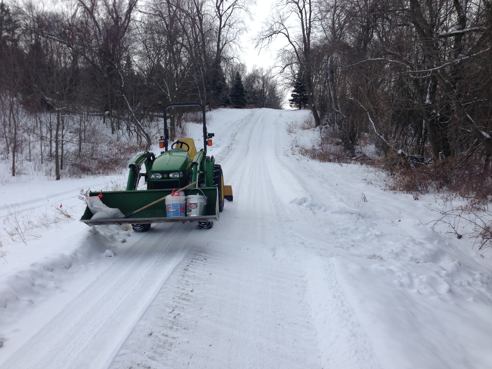

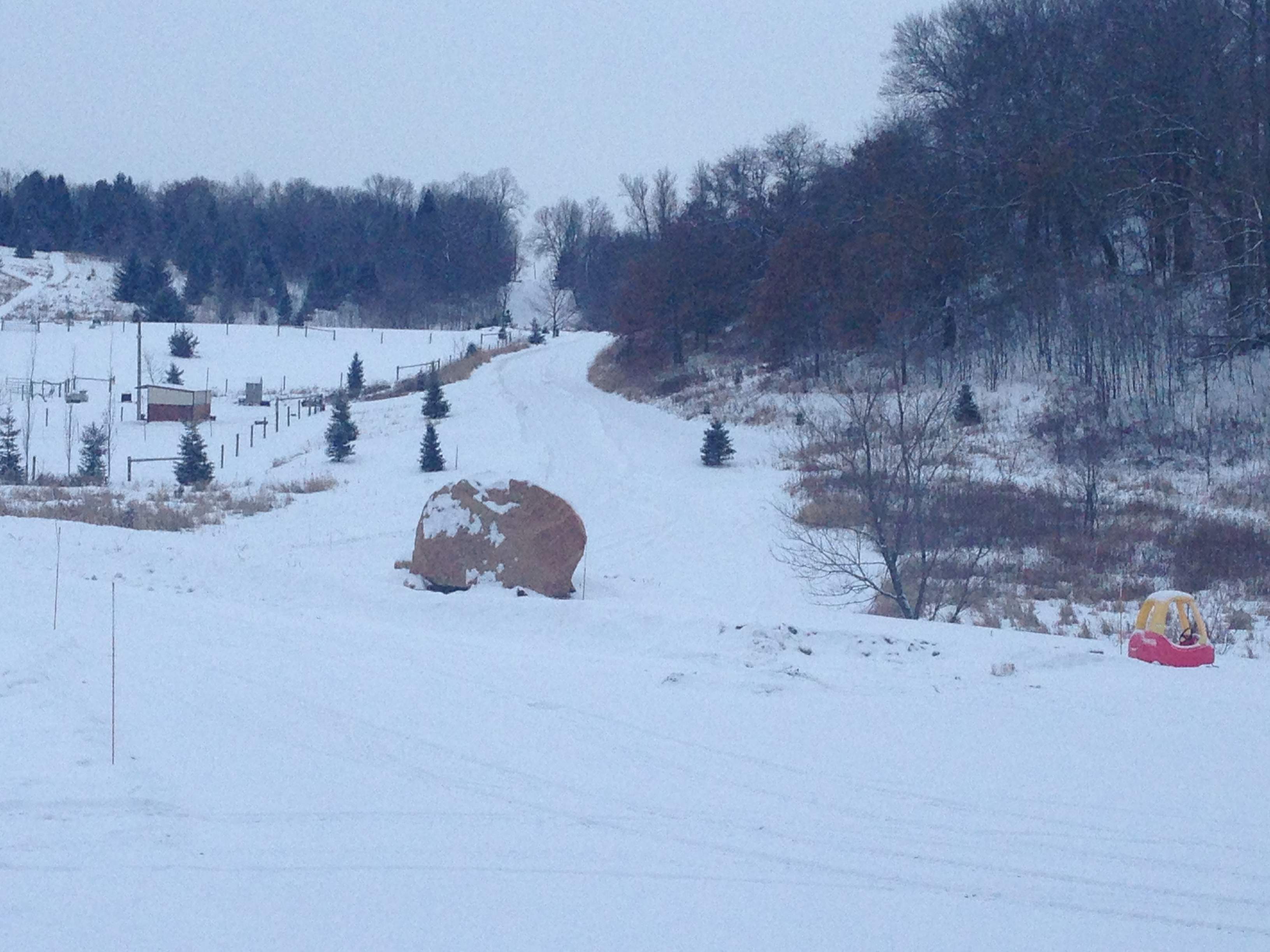

Attached is a picture of my driveway from my house. The steep part is at the end of the driveway. I'll take another picture there soon and post.
You're going to need those tire chains to pull that stuck red and yellow car out of the snow bank!
   / Tire chains-looking for opinions. #68
Its a lost cause, I think my car will be buried all winter.
Attached is a pic at the bottom of the steep hill on my driveway. It doesn't look steep in the picture really. If you take a look at the trees at the top of the hill that gives a little perspective.
By the way, I am originally from Pinckney, MI somewhat near Flushing.
