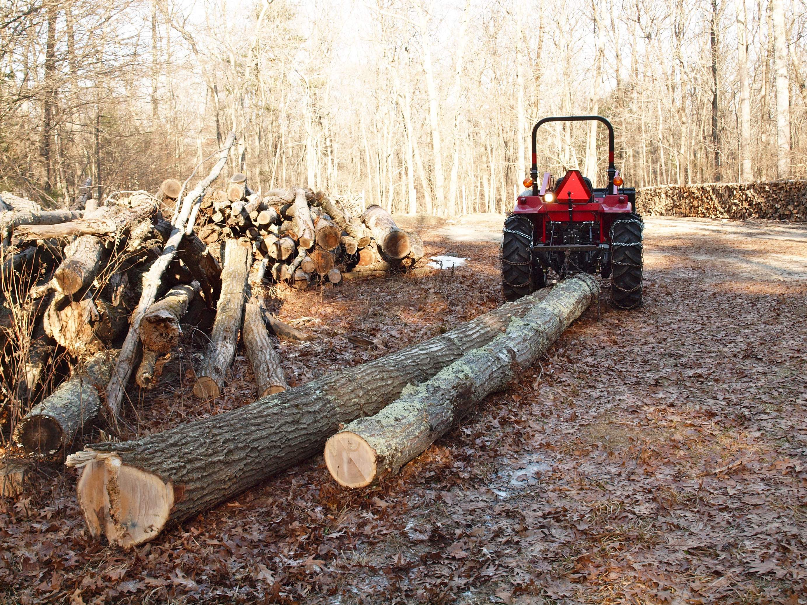

Depends how you bring stems to the landing. I pick mine up with the 3 point. I have 4 link ladders on the rear. This loads the rear of the tractor effectively enough where I do not need to engage 4wd in snow. Where 4wd comes in handy is completing the turn. With no weight, you have better traction in 4 wd. I did have front 2 link ladders on as well as the rears and in the snow, there is no stopping the tractor. In woods as opposed to ice, ladders are more than adequate. With jacking up the rear of the tractor, I have my rears on in 10 minutes from start to drive away chained.
