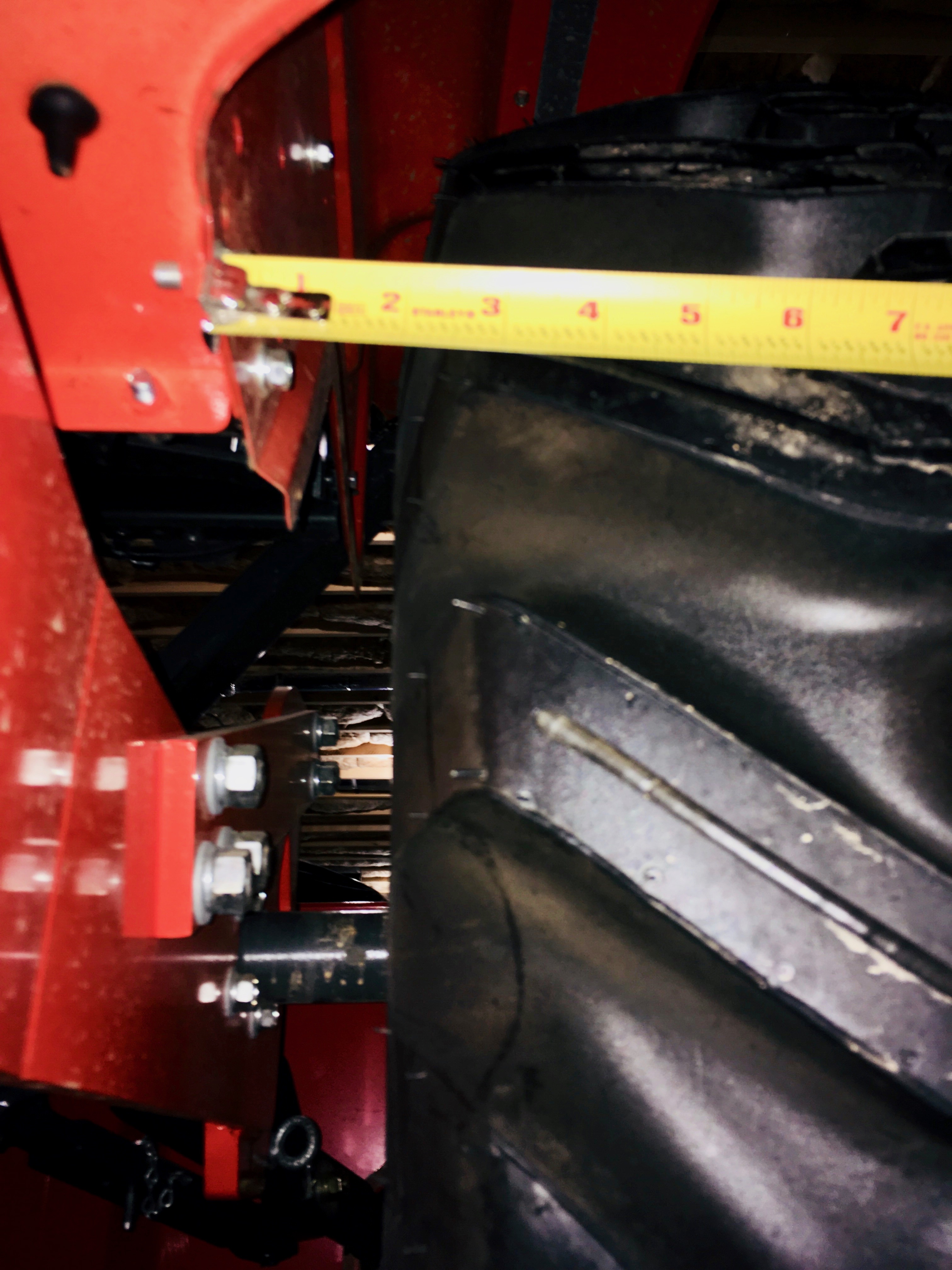

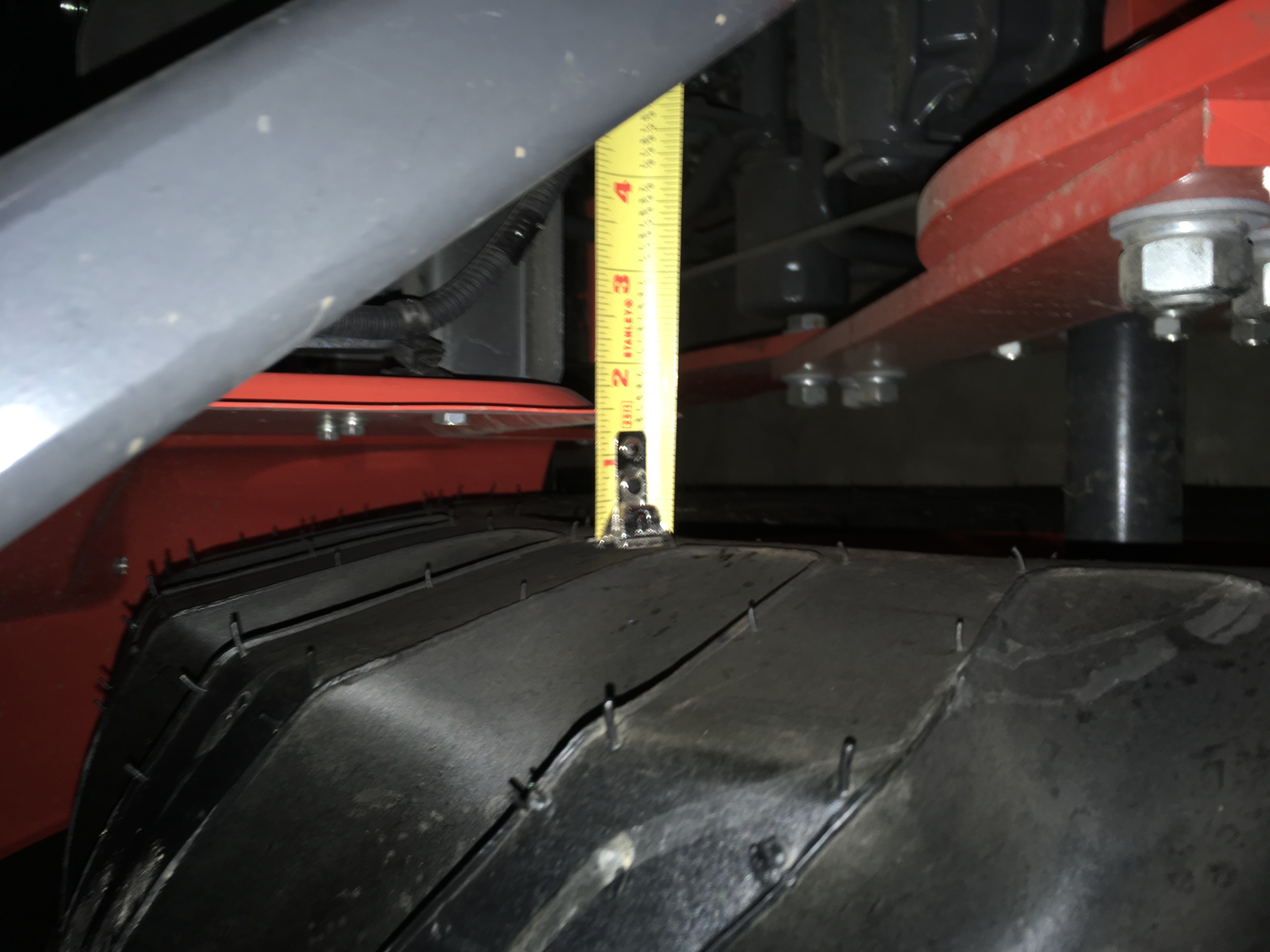

OK, I figured it would make it easier if I actually measured my clearances. It looks like I've got 1 1/2" clearance to the closest part of the fender. The frame is nowhere near the tires. Is 1 1/2" enough clearance for a set of chains without wheel spacers?
   / Tire chains on B3200 with R4's? #7
View attachment 535696View attachment 535697
I wouldn`t do it without wheel spacers if it were me. I just wish kubota would have a deeper wheel offset, then no worries.

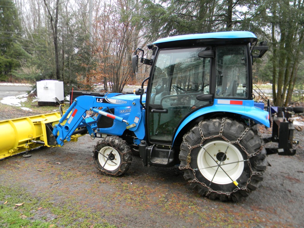

I have the same clearance on my LS with R4's and I use standard 4 link ladder chains. As long as I keep them tight with bungees there is no loose chain inside to hit the framework. Its been working for 3 winters now without incident.

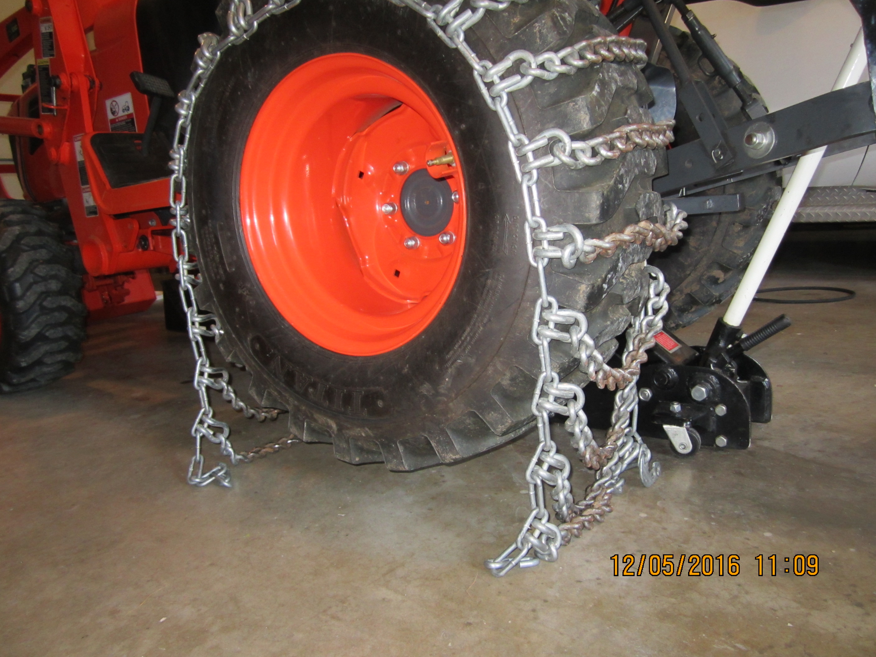

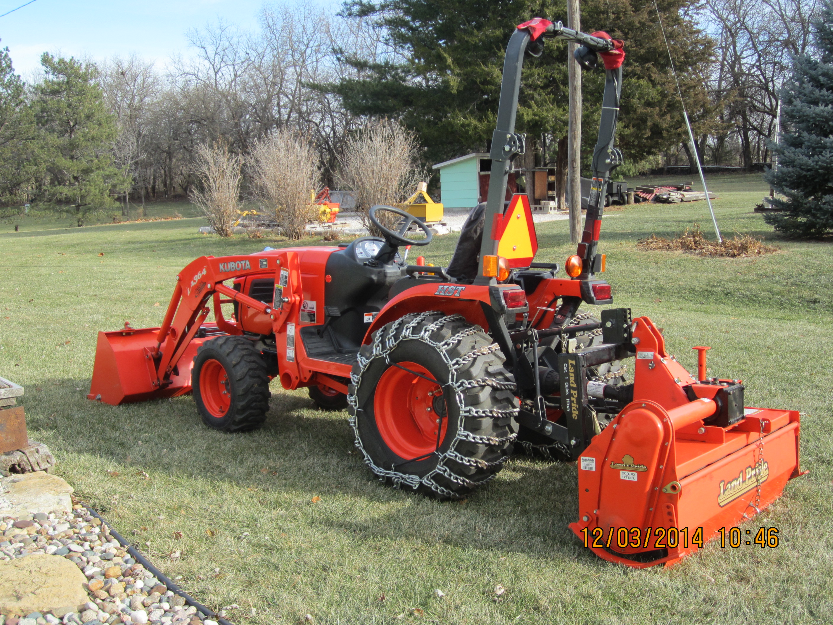

I've got stock R4 industrial tires on my B2620 (not B3200) with 2 link ladder chains and they clear fine. Just have to keep them tight installing and using bungee cords.....six seasons now.007.JPG807.JPG
