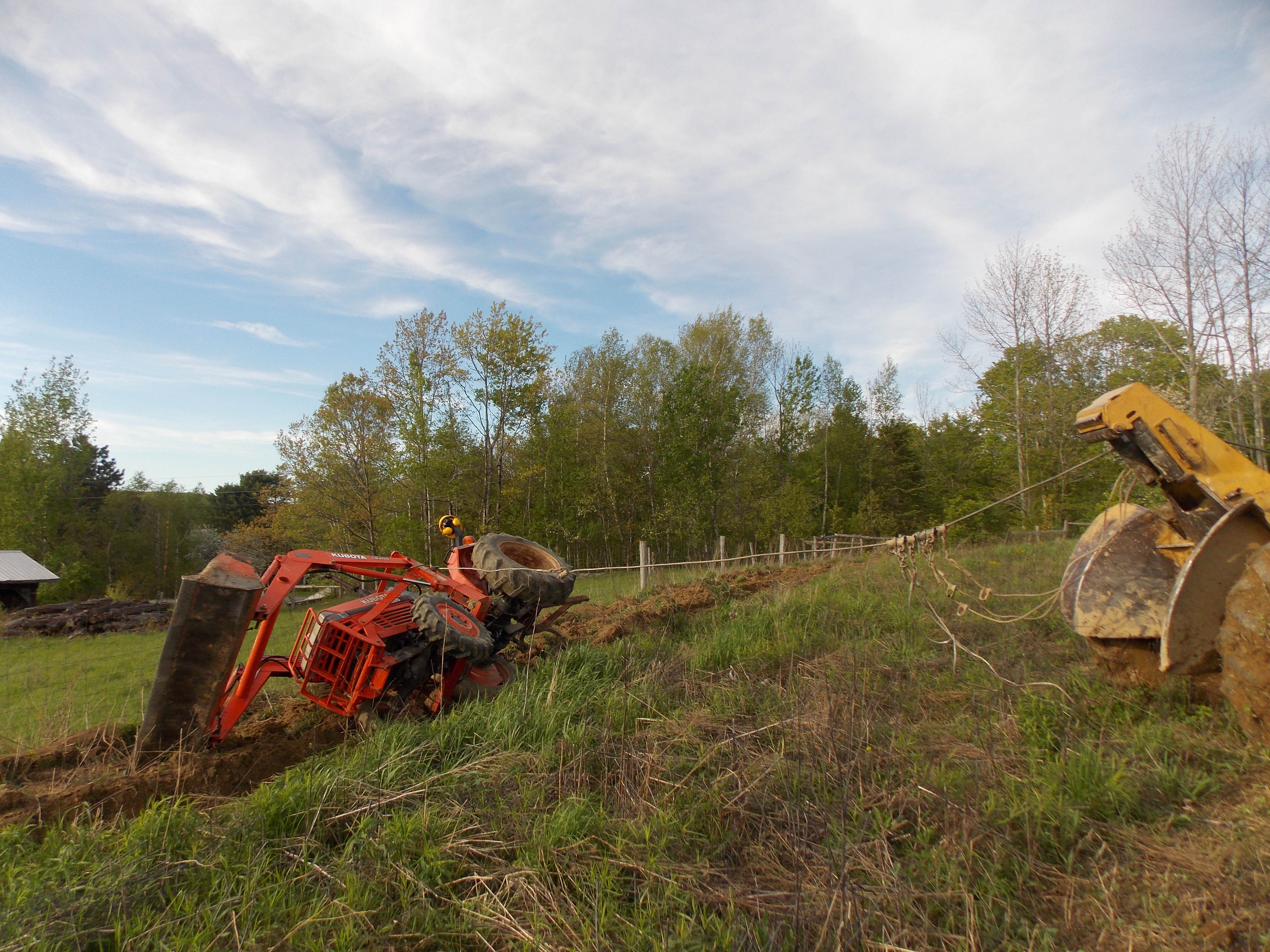

Can't you just invert the tires? My Kubota is a 1999 so maybe that cannot be done any more, but it seems it would save money and net the same thing?
The only big issue I found on spacing the tires out (no matter how it is done) is in going through deep snow the rear wheels do not track through the same path as the front. This also plays havoc when setting up a land plow as the tractor crabs when it goes down the furrow.
I would never put the tires back though, so much better stability, even though I did manage to roll it over last year while busting sod. (LOL) Thankfully I had a skidder right there to flop her back to earth.
