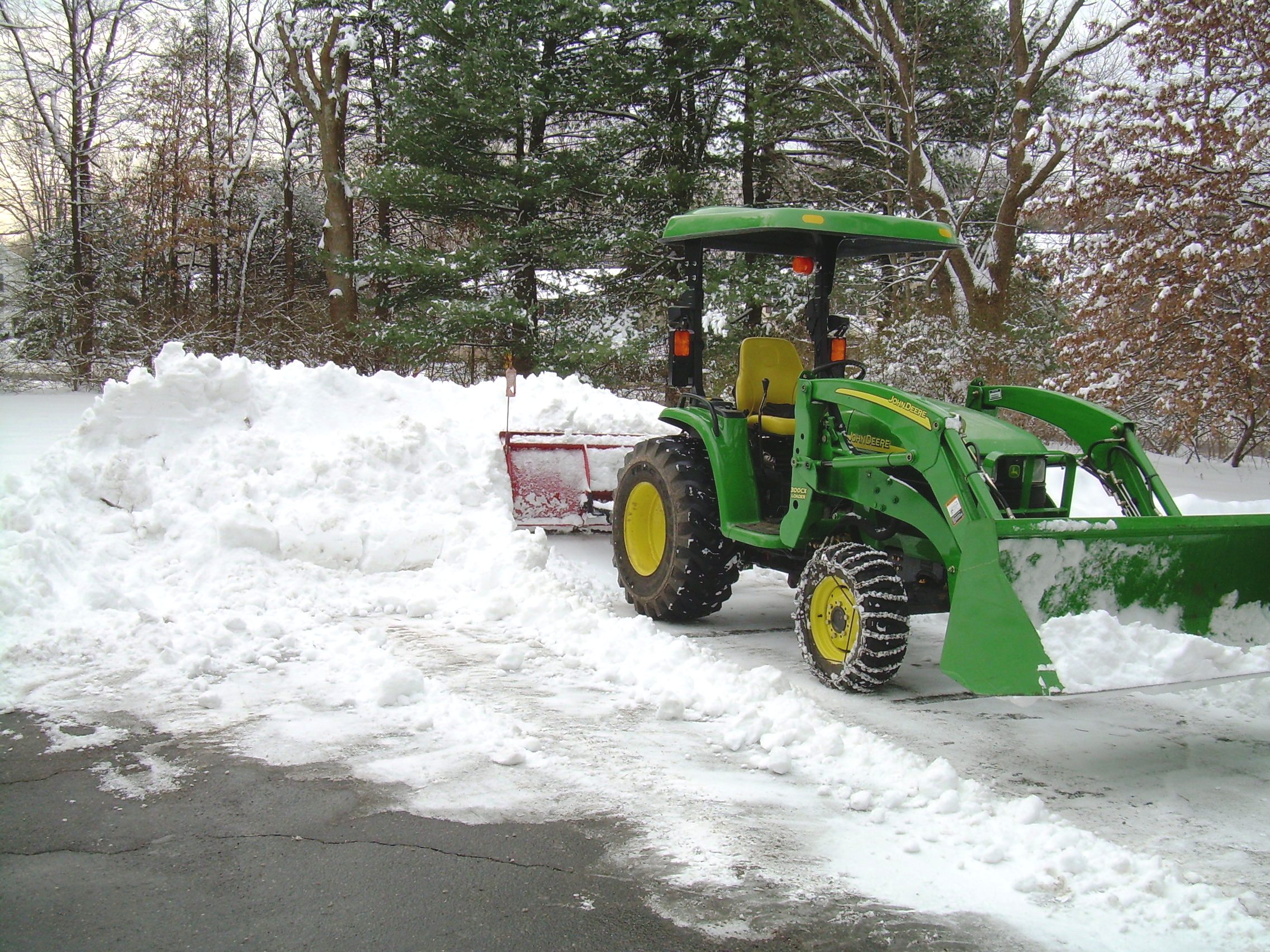

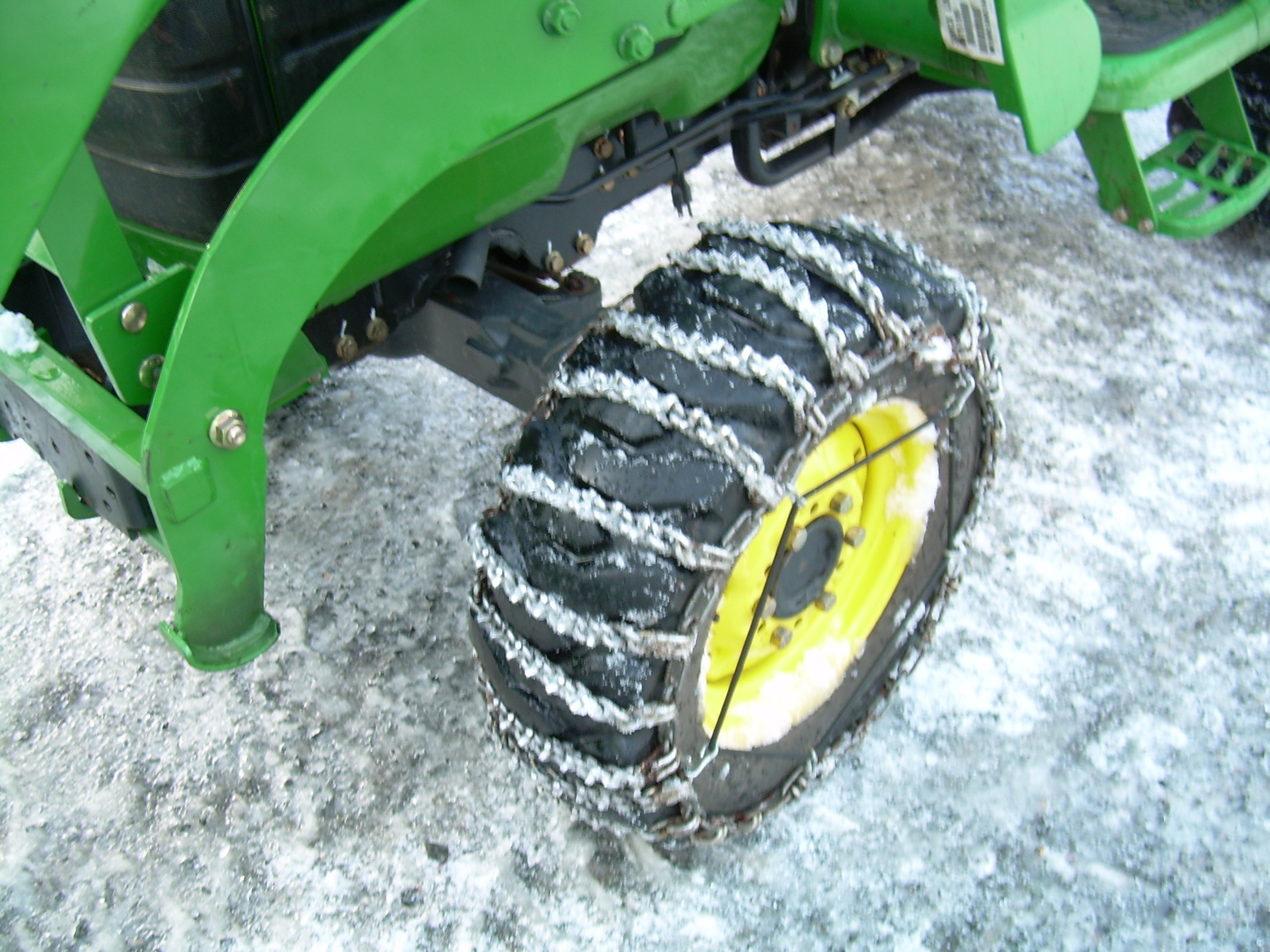

I needed a bit more traction for snow work on paved inclined areas, so put a set on just the fronts, made all the difference. I've got a set for the rears but so far have not needed them.
If you just need a little more traction you may consider going with just fronts, they of course are less expensive and are easier to install, especially with a loader to lift front end.
