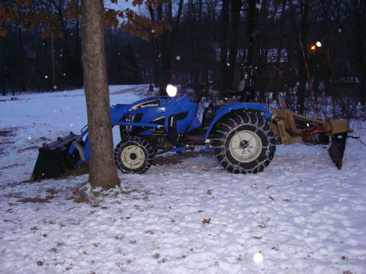

Today was the first day I was able to use my new chains - and they were awesome!
I bought 2-link ladder chains for both front and rear tires. What a difference they made on my Industrials!

They look good Compact1! Did you get vbar or just regular ladder chains? I think if I get chains, I would go the same way, two link ladder front and rear!:cool:

They aren't V-bar's, just ladder. I thought about getting the more expensive V-bar's but was worried about them being to aggressive on concrete and blacktop. I don't think I'll be disappointed with my decision.

Set up like that on all fours with the 2 link spacing, you don't need v's. Unless you were logging in the woods or something.
What's on the back of your tractor, A heavy duty blade? at first I thought maybe a log splitter. looks like it would have very little upward travel, or is that just an illusion?

Looks ready for anything. Couple questions: Did you use Tirechain.com? How'd the install go? Did you get the handy dandy install tool? Do work around any steep inclines?
Sorry that's more than a couple but it looks like some chains are in my not too distant future and I'm trying to do the homework. Right now I'm on the fence between the 2 link ladder that you have and the 2 link V bar. We have some pretty steep slopes in our drive and the tires alone just don't get the job done safely. Still hesitant about the front. Lots of folks here have me a tad gunshy. What tipped the scale for you on the front tire chanins?
