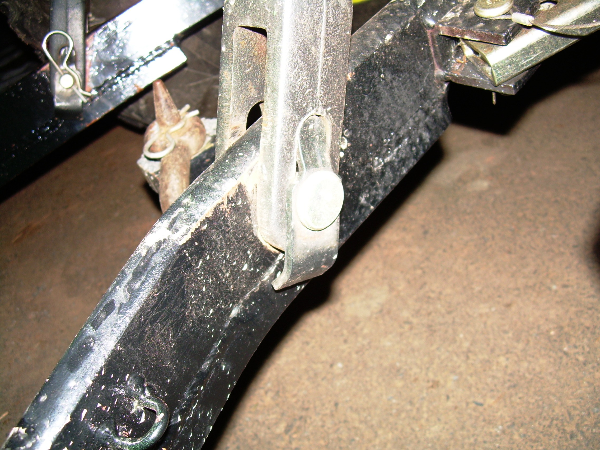

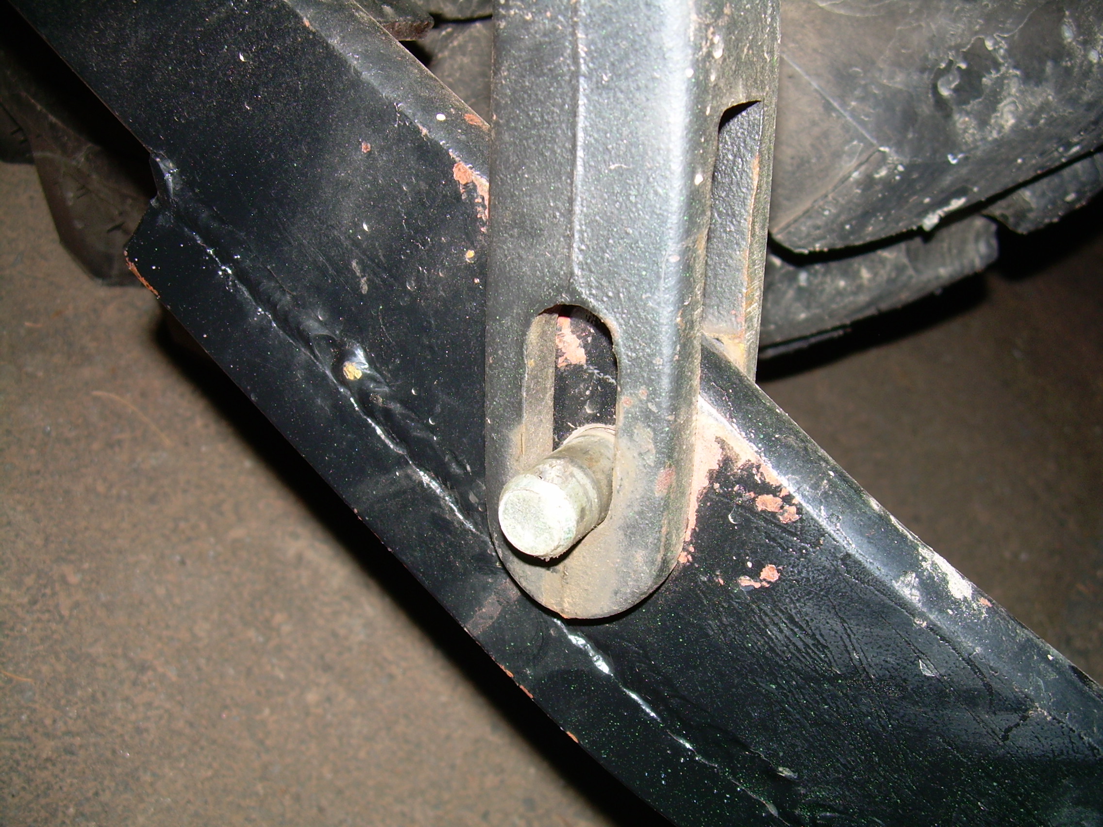

Thanks. I'll check for level but it is uneven there. I was aware of the float, can't remember if set that way as dealer put it on when I wasn't there. Probably best to have in float.
Took a couple of pics for the visual, never hear any discussions on this small feature, I only learned about it in the manual.
Basically those little thingamajigs just fill in the slot preventing any movement up and down, when you reverse them it floats.
