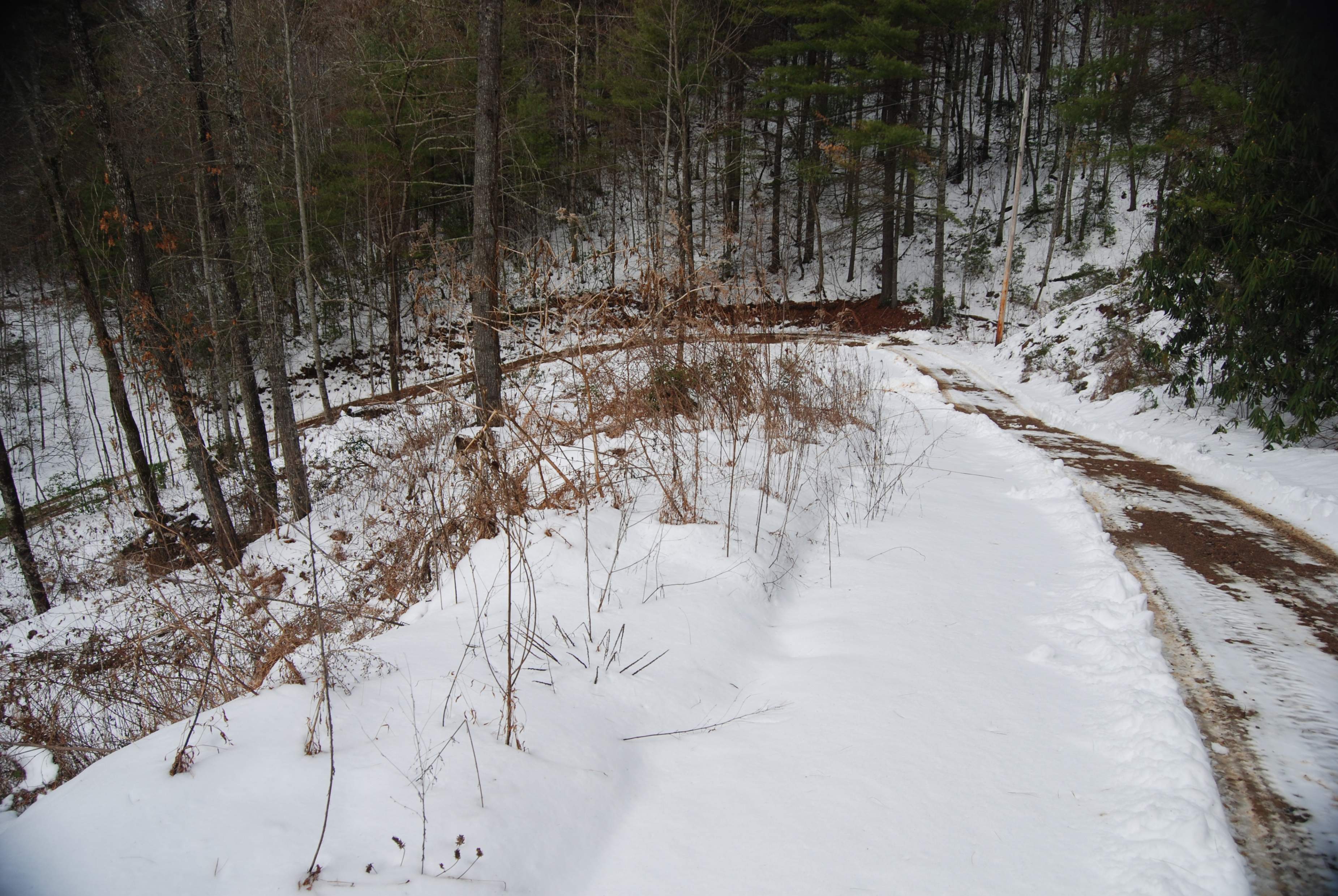

All gravel road...mostly mud right now. TireChains.com has been out of stock right now. Been checking back and hoping that I get an order in before the next big snow. Here's a picture of my driveway of an attempt of scraping the snow.

TB1529 - How have you dealt with the driveway in years past? If it were me I'd stick it, place the order for the V-Bar, if they come in this year great. If not then you will be prepaired for next winter. Just my 2 cents. Which now days might be worth a wooden nickel

Would a ladder style chains work good enough to pass over the V-bars for my driveway?
The ladders would be better then no chains, but I'd suggest you go with wedge40's advice to go with what you have this winter and pick up the v-bars come Spring.
If you do go with those ladder chains, the 2-links would be better then the 4 link (with that sloped drive) and learn to use your brakes for steering (as well as the 4WD, if you have it).
