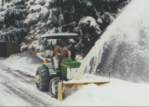

I use "chains" made with rubber belting cleats that do not leave any scratches or marks on asphalt driveways. I use them on both the front and the rear of my JD 955. I ordered them from Dave Anderson, Deere Creek Equipment, Oxford, PA, 1-800-255-6567. I have used them 2 seasons and am very pleased with performance.

JackIl,
What did you use to make your rubber covers?
Nice picture of you blowing snow! /w3tcompact/icons/smile.gif That looks like fun!
Terry

Terry,
I did not make any "rubber covers." These chains are commercially available and are made with lateral strips of heavy duty belting connected to a circumferential metal chain on each side. You simply specify to tire sizes when ordering these "chains." They prevent scratching and marring asphalt or concrete surfaces.
