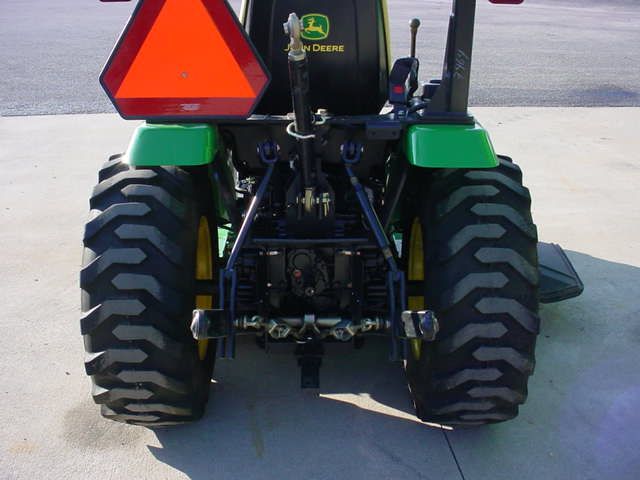

I am a new 2520 owner and questioned tire clearance before I bought it. Sounded like it would not be a problem running chains on r4 tires using I-Match.Well. I am disappointed,I can tell you first hand chains would not work on my 2520.I have alot of hills and the tires have worn the paint of the three point hitch arms when fully raised in just 3 hours use. And yes I have the turnbuckles adjusted tight.Chains just wouldn't work right now even with the wheels flipped.I am machining 3" spacers now that should solve my clearance problems and enable my to run chains.Plus I will get the added stability on side hills. Still, I am kinda pissed I need to do this especially when I asked the dealer about this before i bought this tractor.
   / Tire Clearance on 2520 #12
You said the wheels are switched and still rub? The valve stems are in correct?
   / Tire Clearance on 2520 #13
No my wheels aren't flipped,I beleive it will only gain about 1/2 " clearance.Maybe enough to stop the tire rub now. But will not gain enough clearance for chains.
   / Tire Clearance on 2520 #14
With my valve stems in I have 1 3/8" clearance at the 3pt arms. What if you remove the quick hitch through winter, might give some clearance. Just attach your blade or blower the old way. Also if you just put chains on front tires would that be enough? Just a suggestion.

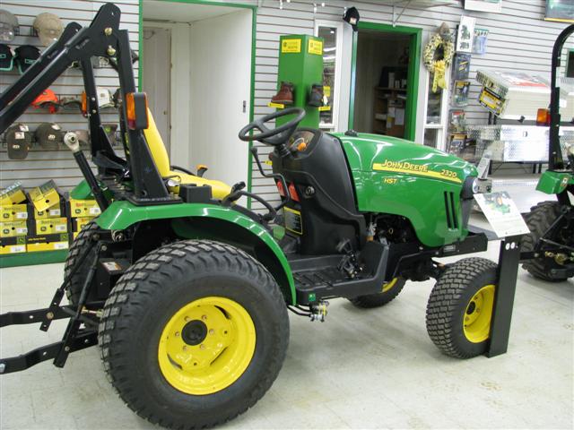

   / Tire Clearance on 2520 #19
Here are a couple of 2320 pictures.... hope they help I also attached a picture of a 2008 JD 2320, and it looks like they might have changed the turf tires to taller, and a little less wide. The Deere web site doesn't confirm that yet though.
   / Tire Clearance on 2520 #20
Those tires look super-skinny compared to my 2520's, wow!
