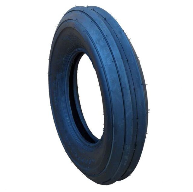

Intersting. I take it you have to keep the tire aired up or it would slip?
I guess if you cranked up the pto speed and dropped the pto clutch, you could burn rubber??? :D
Yes, 35 psi. It'll start to slip when not properly inflated. Haven't had to replace the tire in over 20 years of use. I have a live PTO so it ramps up.

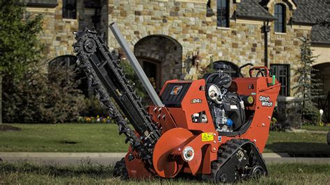

/ Tire driven Sidewinder advice #32
Those are all we have around here. We use them for trenching water furrows through fields.
/ Tire driven Sidewinder advice #33
I guess I ain't neer spent no time 'round thar.
All the ones (that I've seen) that we have in a place that goes by the exact same name "here" are the kind that look like big chain saws with twirley whirlies to shove the dirt to one side.
/ Tire driven Sidewinder advice #34
:ROFLMAO: :ROFLMAO: :ROFLMAO: :ROFLMAO: LMAO. That's not even close to what that furrow trencher is used for. It's not used to bury things under ground. If that's your feeble ass attempt at writing a southern dialect it's not very humerous nor is it very accurate.
/ Tire driven Sidewinder advice #35
I seen me a gravely larn mo with one of them spinning screw ditchers afore.
