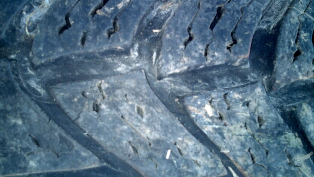

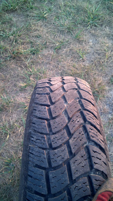

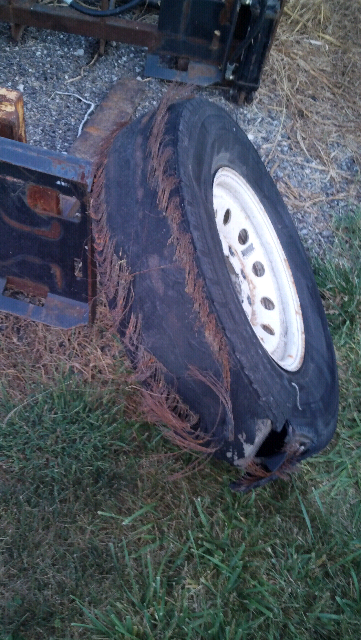

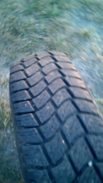

Well let's start with what I did to save money.
I had a truck that got totaled out and had a set of 235/85/16 10plies on the rearend 4 total that I saved to reuse as all my trailers use that size as do most my trucks.
A little while later 6moths or so I noticed my gooseneck needed new tire but I didn't want to spend 1300 on 14ply goodyears so I put the 10ply tires on it. The difference was only 800 lbs per tire so what the heck saves 1300 dollars and I thought I would be carefull and not over load it.
Well it didn't take long and I was using it way I use to and loading over 20k and I lost tire. Well next trip lost another. Both tires blew on interstate @65+
I broke down this week and purchase the right tires when removing the 2 that were left I noticed they had broken belts and were humped up in the middle.
Moral of the story when I built the trailer it was built for 14ply 3770lbs tires but I was tight aws and ended up I was luck that haven a blow out @ 65 didn't cause a wreck. SOOOO trailer is only is as strong as the weakest link.
The pictures are of the tires that were not blown and looked like new and no dry rot hope you can see the bulg and the stretched rubber in the closeup.
The blown tire as my 5yr old said as I was changing tire "dad that don't look so good"
Enjoy and be safe out there
