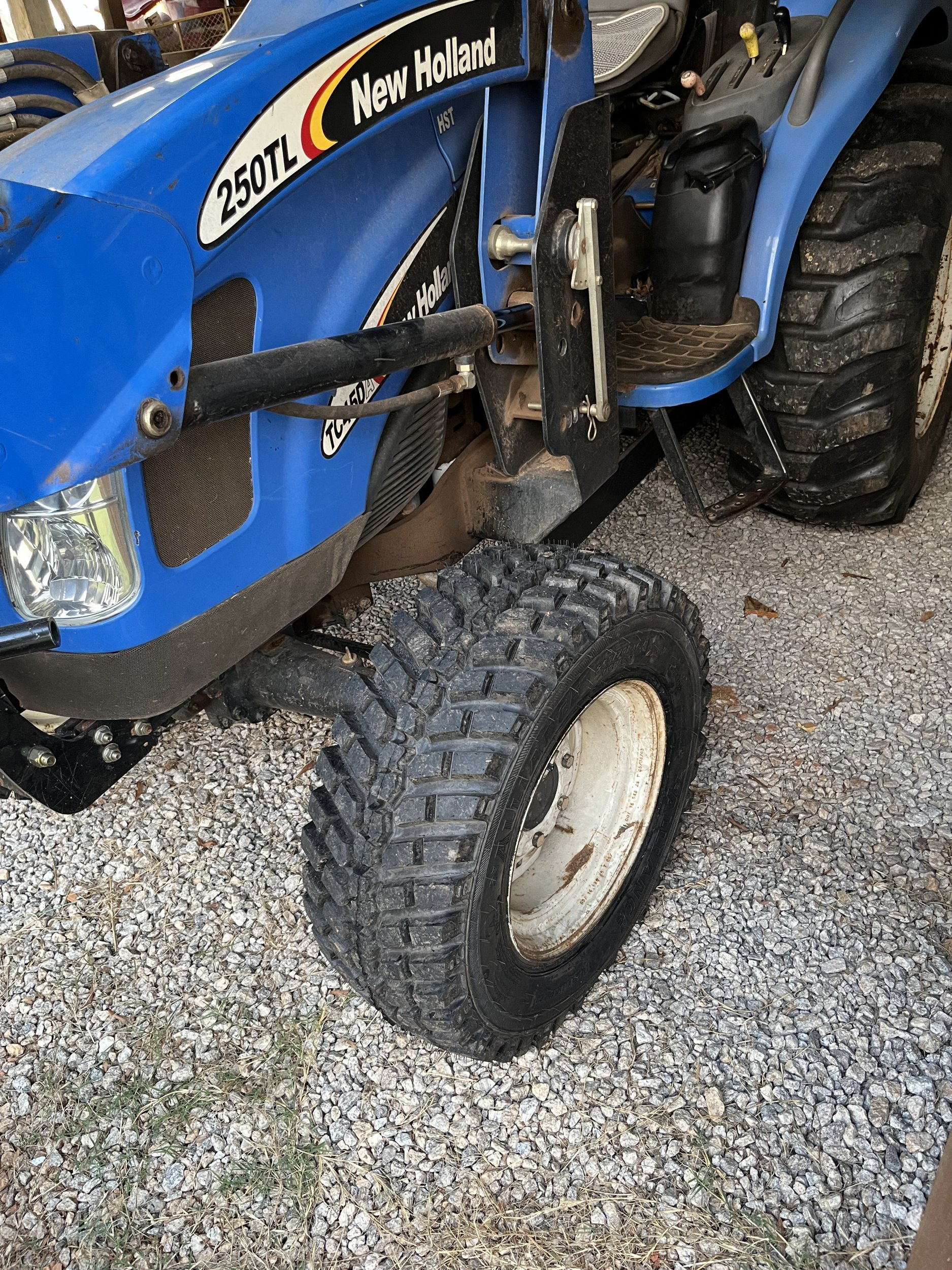

I went from an old IH 424 with R1 tires to a NH TC45 with R4s.
I can say for sure the traction of the R1 tires is way more than the R4s.
I replaced the bald fronts with Alliance 550 tires. I am also going to replace the rears, but I am thinking of replacing them with a BTK 747. However, the 550 tires are an option too, but may not have good traction in sticky mud due to not clearing mud from the lugs.

   / Tire planning #8
   / Tire planning #9
I replaced the bald fronts with Alliance 550 tires. I am also going to replace the rears, but I am thinking of replacing them with a BTK 747. However, the 550 tires are an option too, but may not have good traction in sticky mud due to not clearing mus from the lugs.
I like the looks of those fronts for a utility tractor, not for a tillage tractor but many other times I think they would be very good.
I have no use for R4's I haven't found a situation where they worked better the R1's for me.
