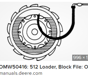

Probably does but it references a tire that is not liquid filled. if the valve on a liquid filled tire is at the bottom .... its under water right?
thats why your gauge is getting wet.
if the valve is at the top then its out of the water. What you arnt seeing is the tire never gets 100% filled with liquid. there has to be somewhere for the air to pressurize the tire and the tire to flex. Usually filled around 70-80% of the tire.
But if person filling tires with liquid isn't being very watchful tire can be filled with too much liquid which will be above valve stem @ 12 o'clock. BTDT seen that several times.
   / Tire pressure gauge for ballasted tractor tire #12
I have been using a regular gauge for 10 years without issue. Put the valve stem at 12 o'clock and briefly burp it to let any liquid out of the valve before you attach the gauge.
If this was bad for the gauge surely it would have died by now.
If the tire has been properly filled to cover the rim you'll likely still get some liquid even at 12 o'clock (I know I do). As others suggested, just get a liquid-compatible stick-type gauge at Tractor Supply for $9.00.

According to some manuals, the valve stem should be covered. This is from my 2720 manual:
"Fill tubeless tires at least to valve stem level (minimum 75% full). Less solution would expose part of rim, possibly
causing corrosion."
   / Tire pressure gauge for ballasted tractor tire #14
Liquid ballast filled to just covering valve stem won't leave 25% for air & filling to just over valve stem will leave some of rim inside of tubeless tire exposed to air for possible corrosion.
