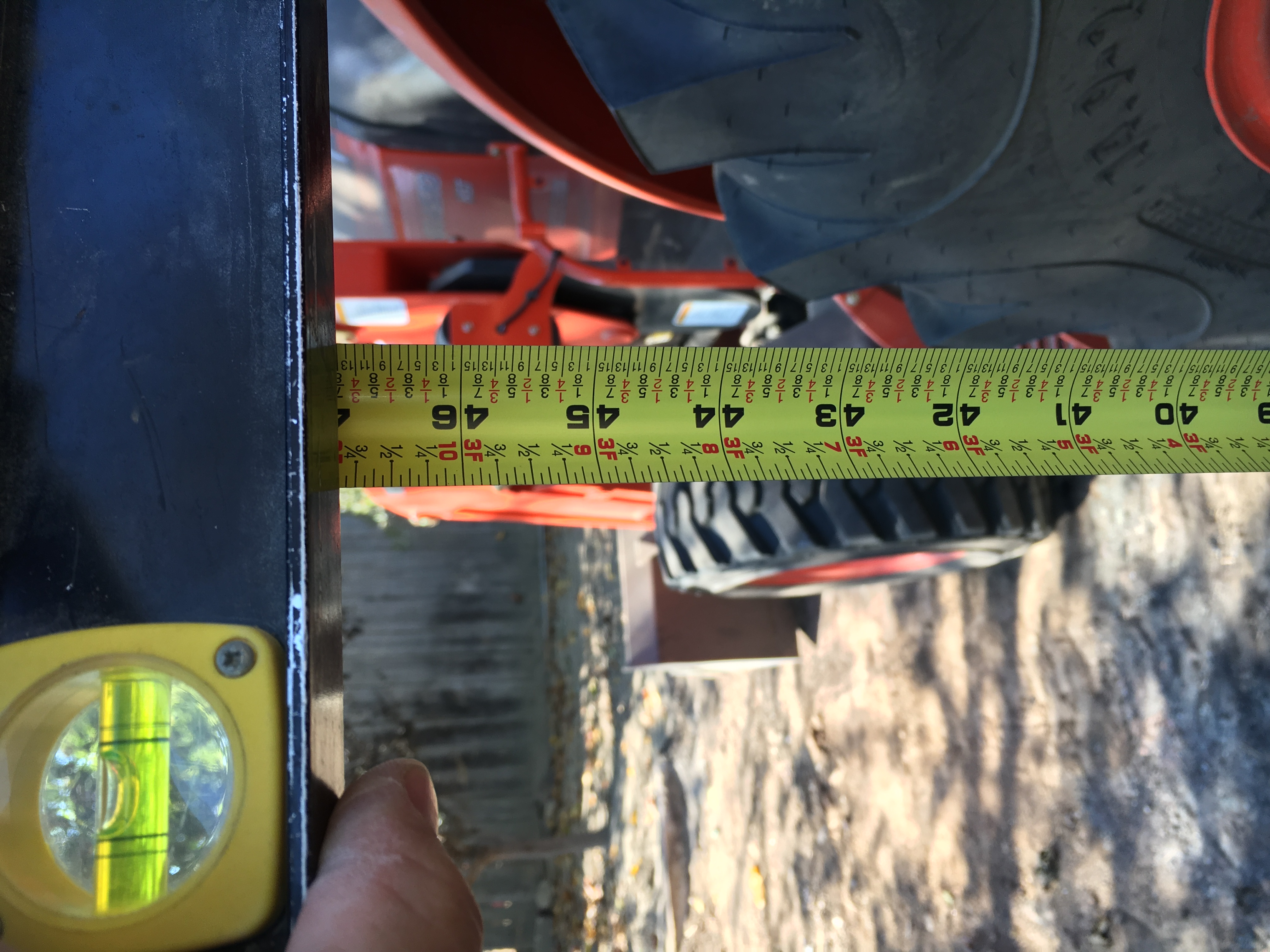

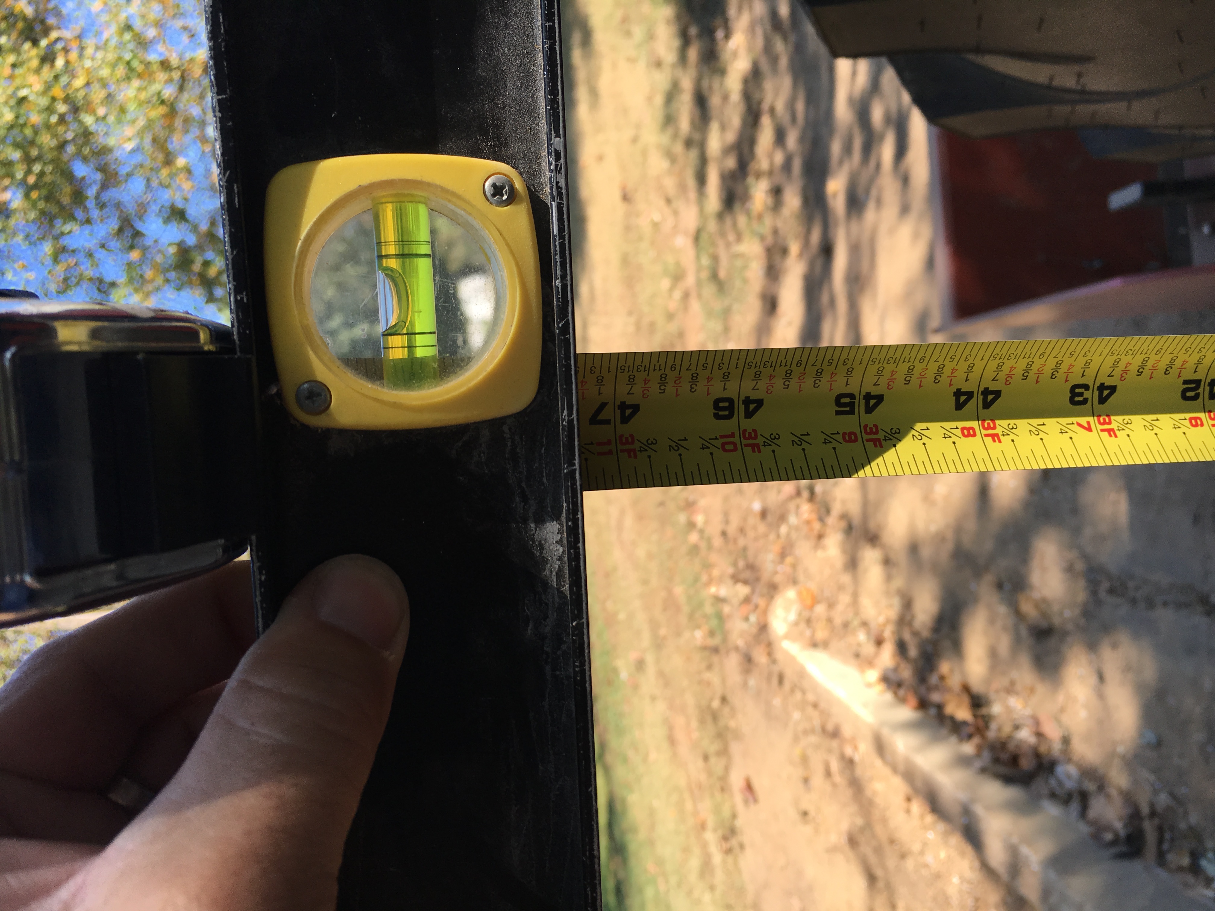

#13
ok did the same kind of measurement using a level. i have 120 hrs on the tractor so almost new and they measure the same after several checks 47 1/8 slightly give or take a fraction due to not having a real clean level surface, so i don't see why they would cause any trouble since the height is the same or really close image.jpegimage.jpeg as you can see one side is a little taller could be air pressure or un level ground

/ tire question #15
The 14.9-24 and 17.5L-24 are the same diameter for all intents and purposes.
there are always slight variations in the measurements among different MFG's. There is less than 1" difference in those two tires. IT aint gonna effect the gearing at all IMO. You can make a bigger difference just in playing with air pressures. And I believe you are probably right about the NX55-NX60 being the same gearing internally, and they all have the same front tires.
SO I say if you want to, go for it and the tractor is not gonna care one way or the other. But I question the need. You arent gonna notice much real world difference in changing to a wider tire. So what has you wanting to switch?
Wider is good for more flotation, and less compaction.....meaning it wont rut up as bad. But that usually isnt a concern on the rears. IF your rears are rutting things up.....the fronts are probably really doing alot more damage.
For firm/dry soil.....there isnt gonna be a measurable difference. Added ground contact area but proportionally less ground pressure. Traction is a function of the weight, not the tire size when you are on firm footing.
