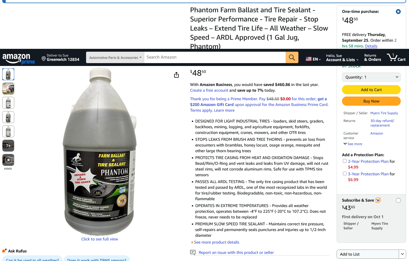

   / Tire Sealant for Slow Leak #26
I have had good luck with this product;
