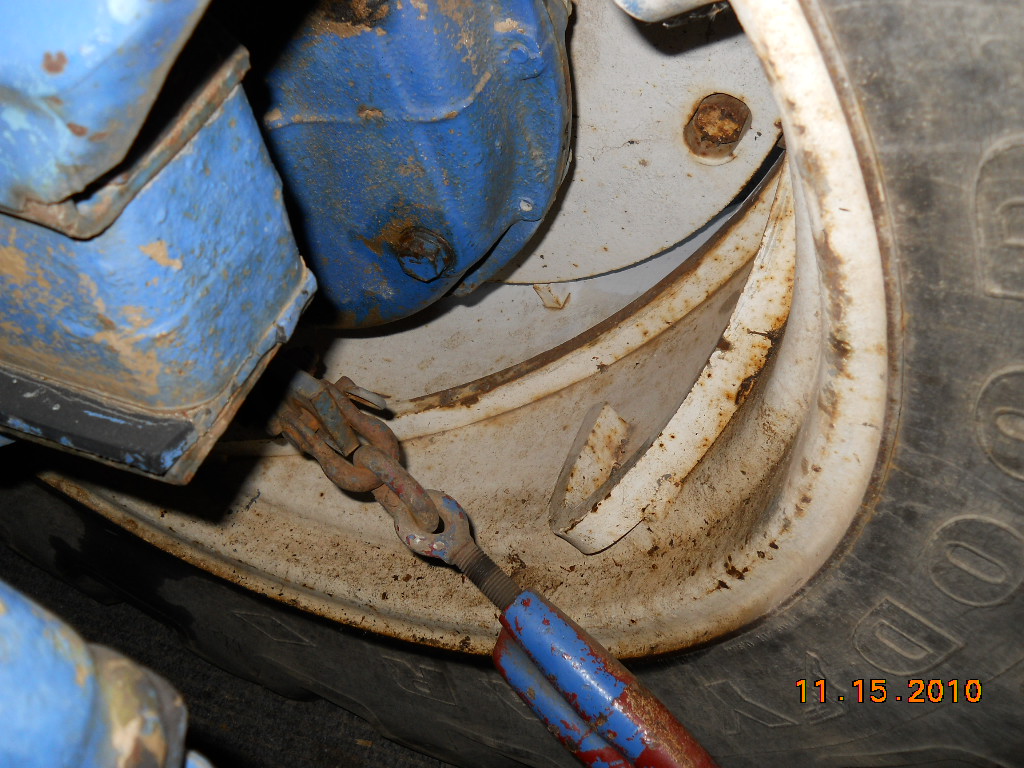

So I wanted to go to turf tires and leave them unloaded. I dont do any farming. I just haul wood in my loader and grade my driveway with a back blade.
The loader will be about useless without the loaded tires. Might not be a big deal if you REALLY only haul the odd stick of firewood.
It might be a better approach to sell the too big tractor and buy a smaller one. The right tool for the job and all that.
   / Tire size question.
#12
To each is own but I think you will be really disappointed with the capabilities of that tractor with undersized turfs and not loading them.
Our JD 2040 has ags that are loaded and about the equivellent tread of turfs. It wont getout of its own way. It will literally get stuck on a wet leaf with Just the weight of the loader, let alone putting anything in it.
If you go the route you are planning, I dont think that blade will you much good. Because when you drop it to the ground, you have absolutly no added weight to the rear, and turfs to boot. Unless you have a way of removing the loader, I dont think you will be able to move much dirt/gravel. And with a bucket load of wood, I think you will be fighting it more than you want, especiall trying to back up.
If possible, and you really want the turfs, I'd look for a set of rims. That way, if you are unhappy with the performance, you can throw your old tires back on. If you decide you can live with them, sell your old tires/wheels then.
Well I measured the width of my rims from the outer edges and they are about 14.5 to 15 wide. Im not sure if a 13.6 wide tire will bead on my rims or not. I still want weight on my rear, I just dont want so much that it leaves ruts in my yard. I figured with those huge cast iron centers in my rims, that would be enough weight without having to load my tires.. I could be wrong?? As you can see the centers are pretty thick. Ive never seen rims like these. They have rails running along the inner rim like they are adjustable. I just assumed that turf tires were the only way to go for mowing and yard work. Although I think my problem might be that Im trying to use a farm tractor for a CUT. Should I look into R4's instead of turfs?

   / Tire size question. #13
I figured with those huge cast iron centers in my rims, that would be enough weight without having to fill them. I could be wrong??
It all just depends. How much firewood in the bucket?? How soft or wet is the ground?? Any hills/inclines??
But i am going to say that anything more than a wheelbarrow load is going to give you fits.

Before you purchase you probably should ask the tire dealer. There's a reason that rim width is usually shorter than tire width. Might work, might not. Might have a difficult time getting the tire to seal the bead. Another thing is the wider tire should provide better traction and less compaction of the ground.
#16
Another good point. Maybe im just better off sticking with the 16.9's. At least I'll know for sure that they fit
