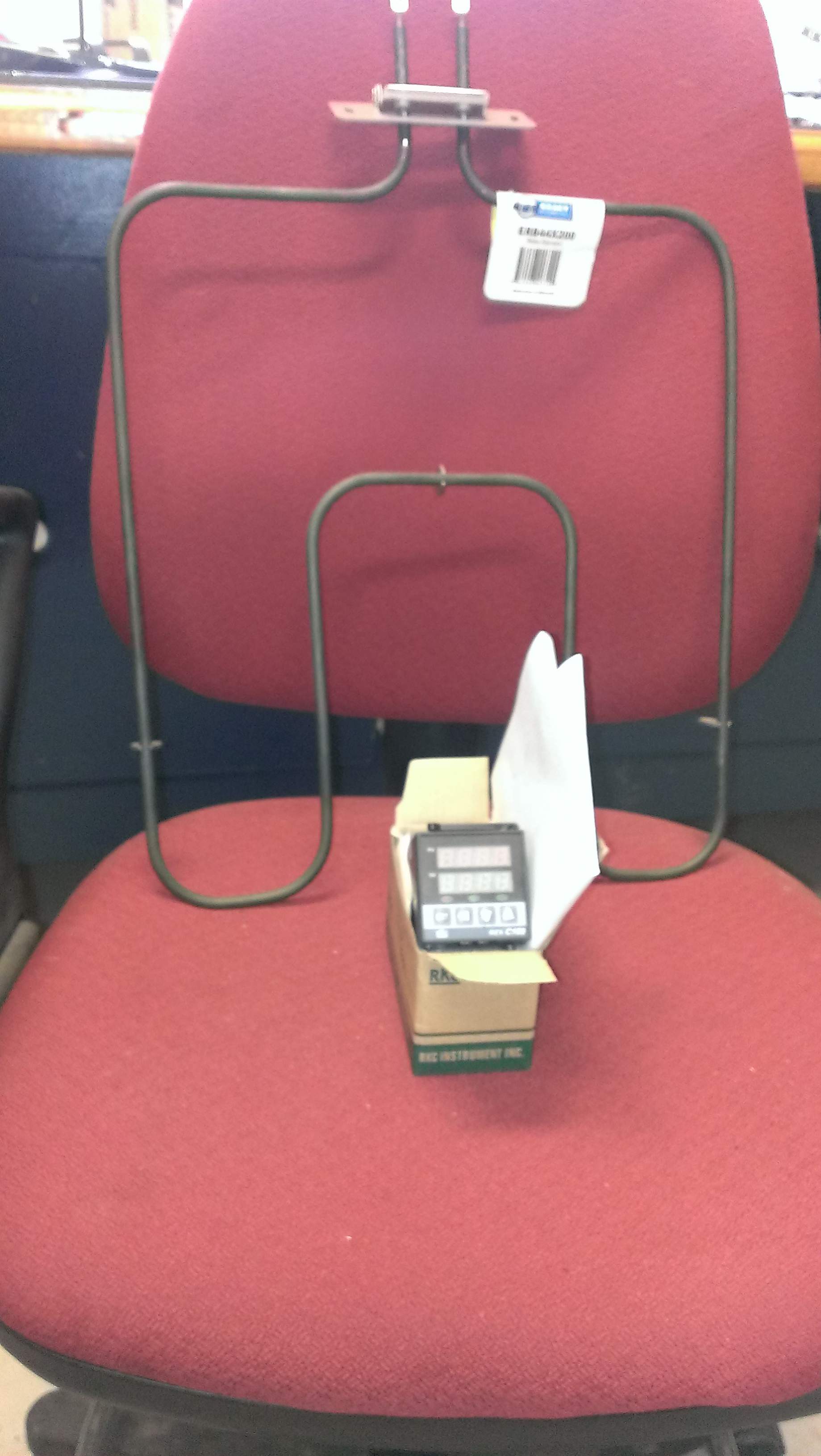

you could take the electric guts from an oven and put them into a homemade insulated box to make your own larger powder coat oven.
The thermostat and heating elements are all you would need.
   / Tired of Painting!
#23
Bought this to control temp, it was cheap, think it should work.
Temperature Controller, 0-400Deg. C, Programmable | MPJA.COM I will then need contactor/relay of some sort to turn the heating elements on and off.
Bought the oven heating elements, four of them at 3100 watts, at 240 puts me at 52 amps, so I should be able to run it on 60 amp breaker, maybe trying 50amps as that is what the welder is already at, can always change latter.(yes, i know I will have to increase awg for the larger breaker) The question is will 4 3100 watt elements heat a 6 x 6 x 4 oven?

I would like to get to 400 in 30 -40 min empty. It will be convection. Insulation wise it will be whatever I can get cost effectively in a 6" wall and doors. One large door one smaller door with window on the side. I need it the 6 x 6 x 4 to get particular part in otherwise I would send out. By not sending out it pays for cost to build oven. And that rationalize it all in my silly brain. Yes reedsville, wi

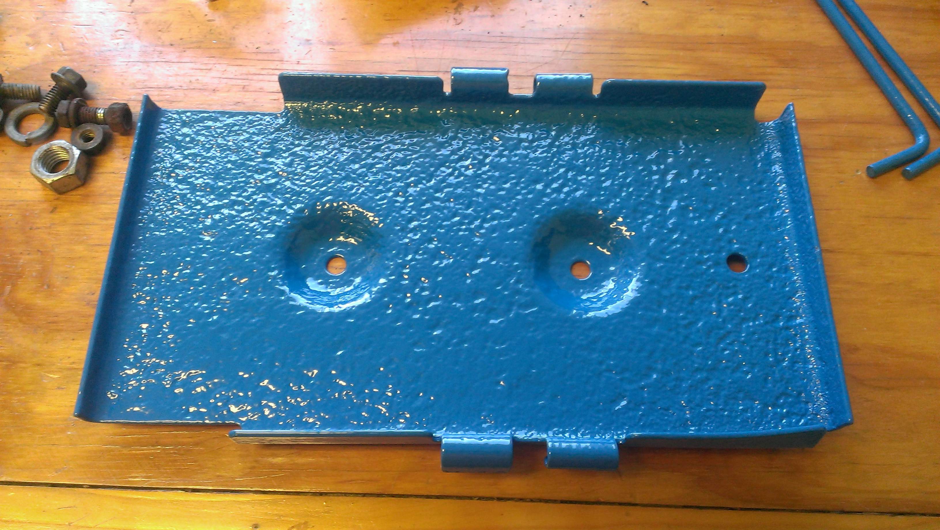

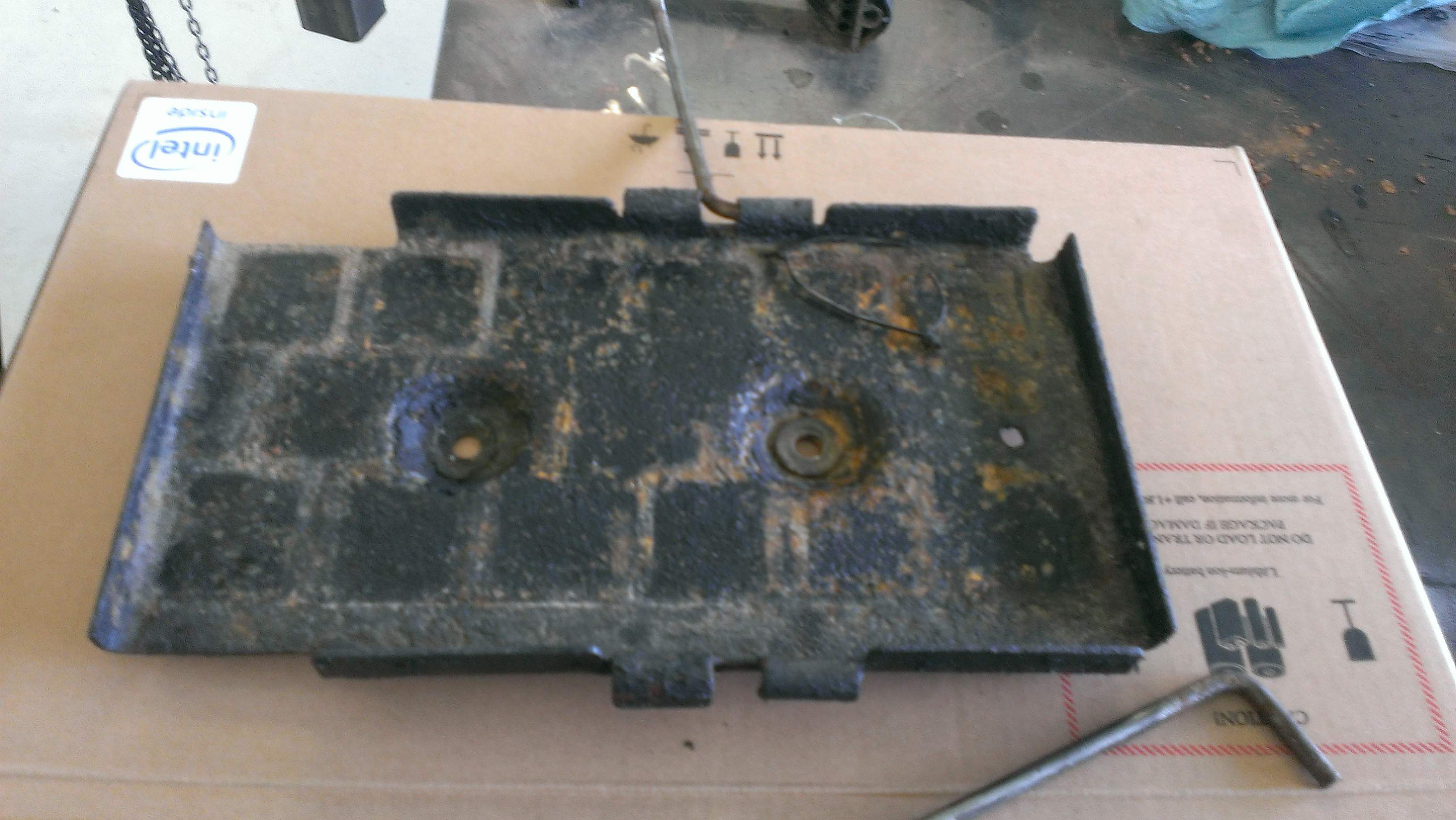

Came a crossed some epoxy powder. Supposed to be better with chemicals and much harder. I agree on the hardness you are hard pressed to scratch this stuff. I'm sold! The down side on the epoxy powder is it breaks down in sun light. So, I did the battery pan on the skid loader.
Here is the before which was done with a brushed on rustolem 2 years ago.
Here is after, good coverage and should be good test. Used same prep as other parts.
   / Tired of Painting! #29
This will be an excellent test for the epoxy! Keep us updated. Someone told me that two weeks in the direct sunlite and it will start to chalk.
