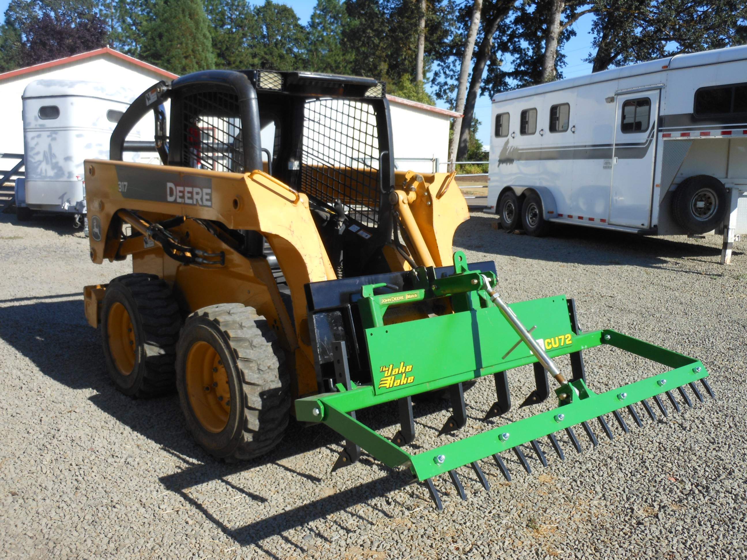

I have a John Deere imatch, in fact I loved it so much i gave the first one to my grandpa and got a second one for my last tractor, a small 16 hp Yanmar. Sold the Yanmar and made myself a quick attach plate so now I can run my few 3 point implements on the front of my skid steer. :D I have yet to have a problem with the imatch system, it's quick and easy and all of my implements fit it. When I had the Yanmar I also had swapped out the lower links with a set of Kioti telescopic lower links however I still ran it with the imatch as well. The telescopic lower links were great for my post hole digger and increased the lift height however the additional stress from pushing the load further back eventually blew the O-ring inside the lift cylinder which resulted in loss of lifting capabilities until I fixed it. I still have the telescopic lower links, some day when I get another tractor they will defiantly be going on it. :thumbsup:
