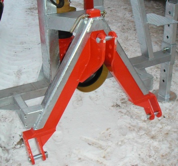

I don't know if this is available there in USA (for 5 years, I have been away and haven't followed here.)
This is what we called A-frame, two-pieces 3pt hitch of which one (gray u-section) is welded to your implements and the other is mounted at your tractor 3pt. You don't need to leave your tractor seat to mount any implement which has u-section. Since we manufactured tousands of this for Danish customer, without going there, I can say this way of quick hitch must be popular there.
