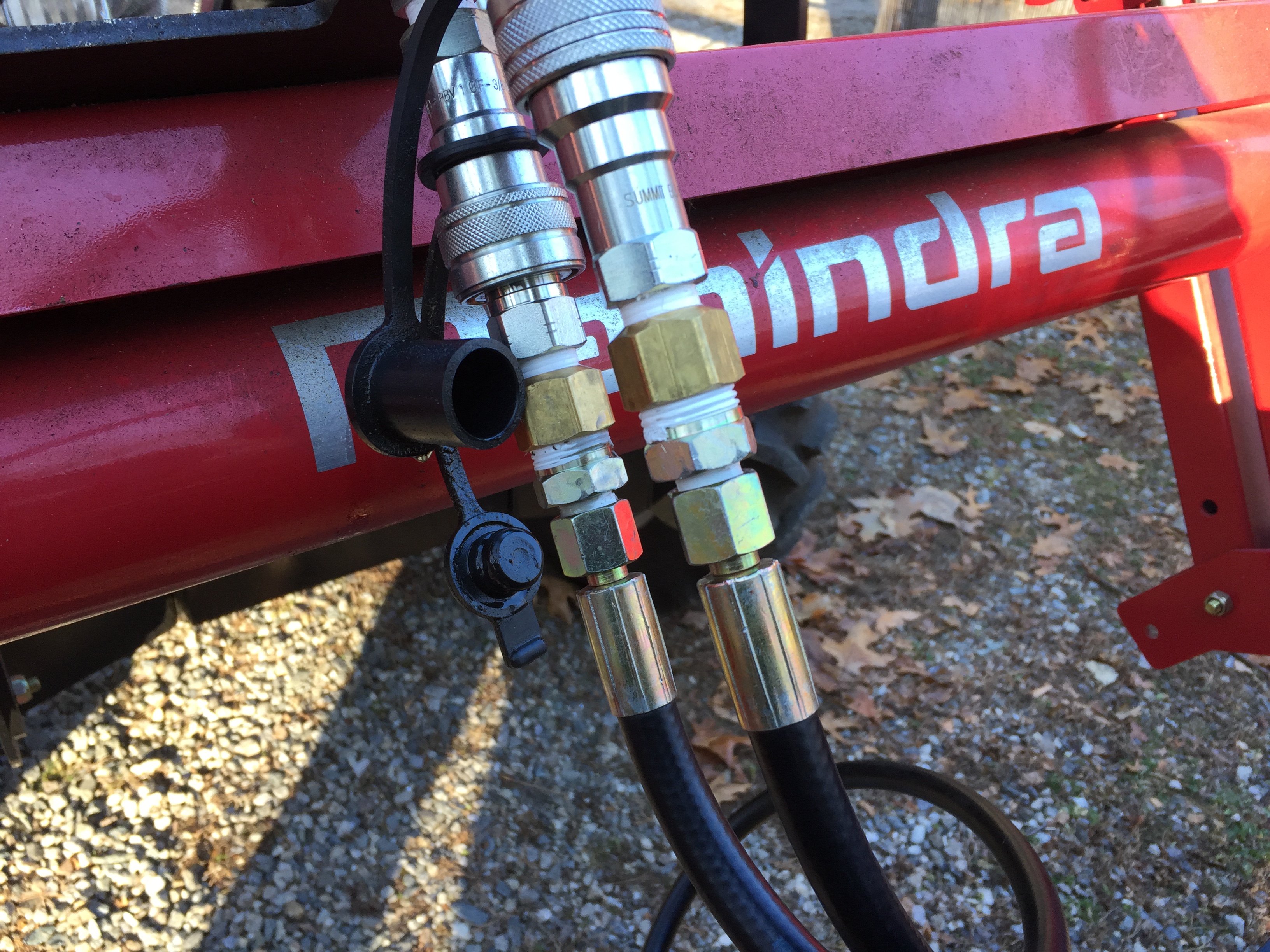

Cool! Glad it did the trick for you. :thumbsup:

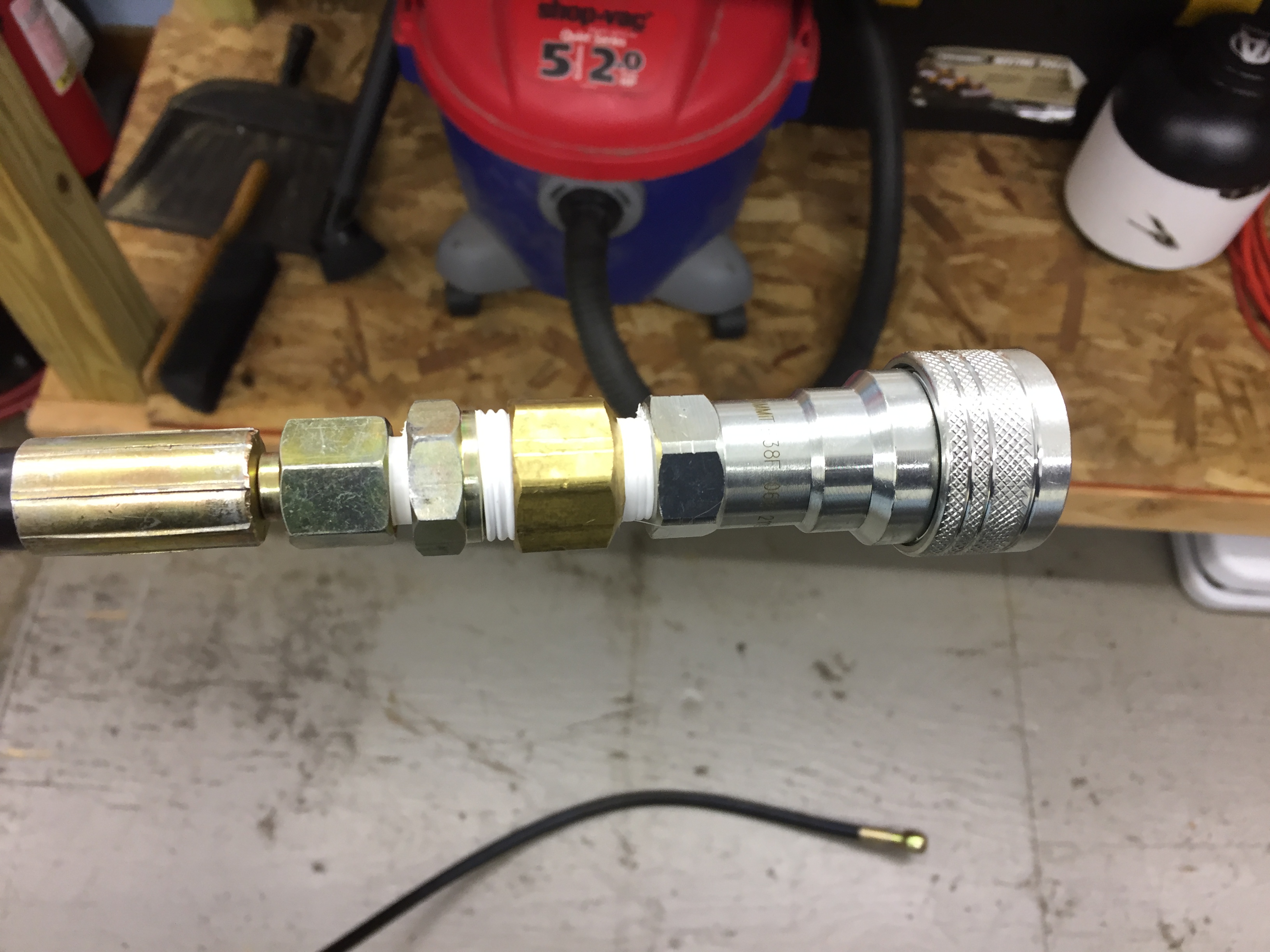

UPS showed up today with the 1/2 to 3/8" NPT adapter. It worked perfectly. No leaks! Thanks again for your help.
   / Titan 79" Snow Hydraulic Blade adapted to compact tractor? #12
Nice! :fing32:
I would say the price was good also. And yes, I'm really cheap actually. I've actually done fittings my self since I have a lathe and milling machine.

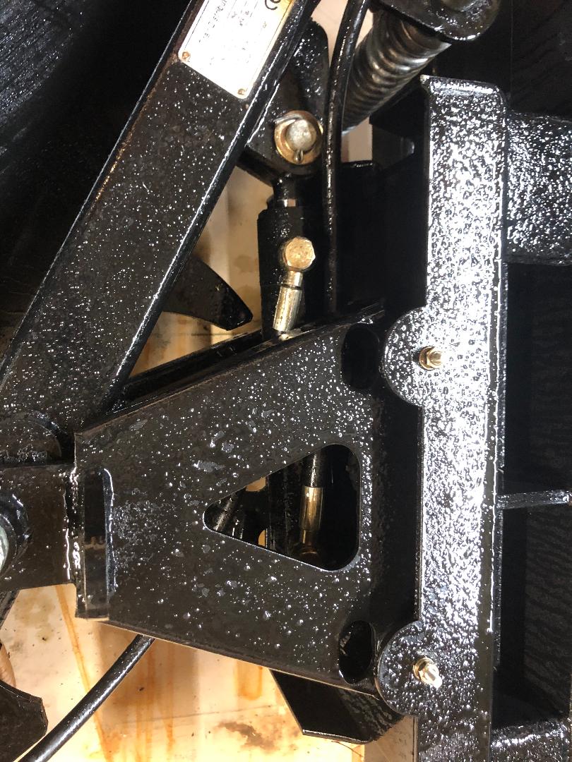

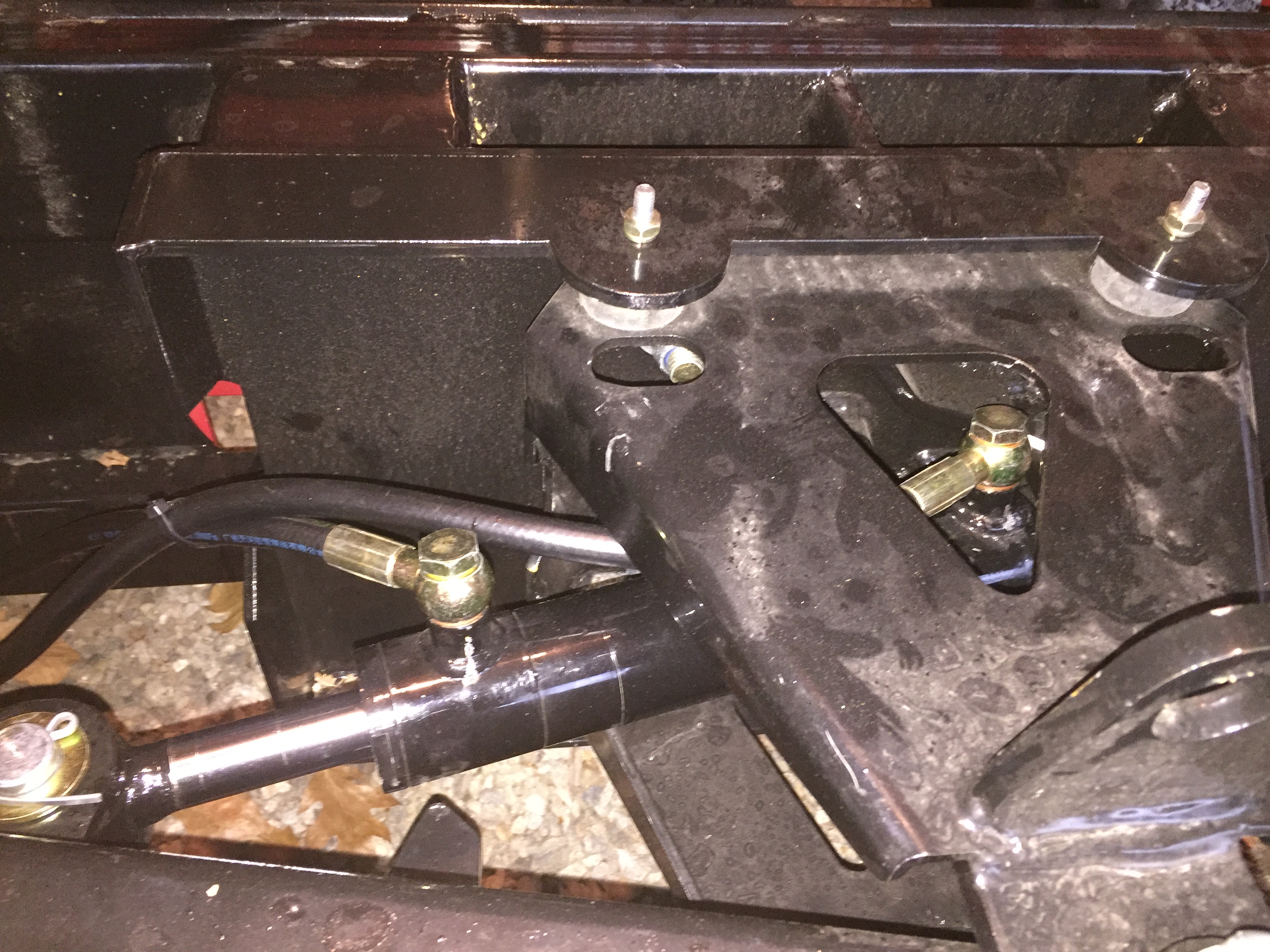

Newbie here. Been reading and learning for a year or so but still have a lot to learn.

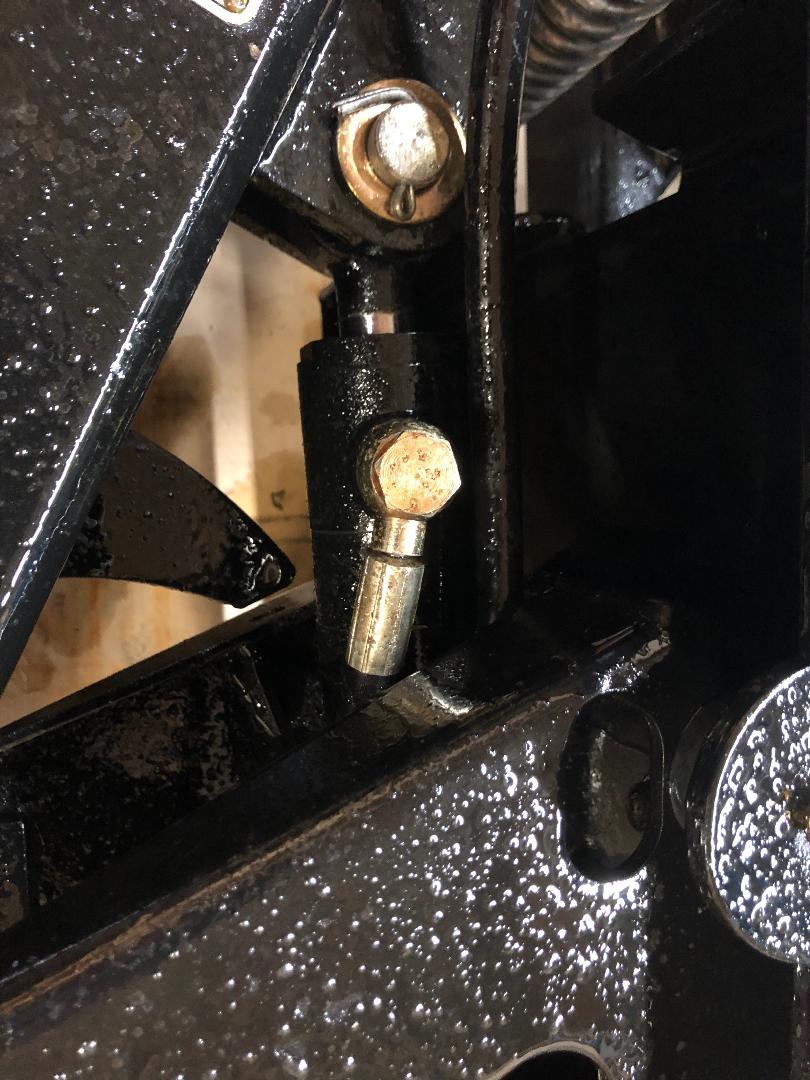

I have the same Titan plow setup on an LS3037. I just tried the plow for the first time today and found a problem. Apparently turning the plow to far to the right broke the angle hose connection on the right side of the plow piston. The fluid went everywhere with a huge mess to clean up.
Stupit, Can you post a pic looking down at the plow with the hose connections? I am thinking mine came with the hose connector facing the wrong way. I am attaching pics.
#15
Sorry, Just saw this. I've been out on the road all week. Yes I will take a pic when I get home this weekend. However, in my quest to figure out my coupler situation, I removed the hydraulic lines from the piston...and then the piston itself. I put it all back together in a way that make sense to me with the lines routed appropriately.
I was not pleased with Titan's customer service. I called them asking about the banjo fittings on the piston and they were of no help. The fittings were missing two sealing crush washers, and were dripping at the attachment point. I ended up buying some on Amazon.
The plow is good for it's price point, but I wouldn't doubt yours was put together incorrectly coming from Titan.
   / Titan 79" Snow Hydraulic Blade adapted to compact tractor? #16
Titan has sent me a new hose. I can't complain about the customer service as they were pretty quick to agree to send it. I came up with a few hose placement adjustments via heavy duty zip ties so I think I am all set. Please post pics of your setup when you get a chance. Thanks!

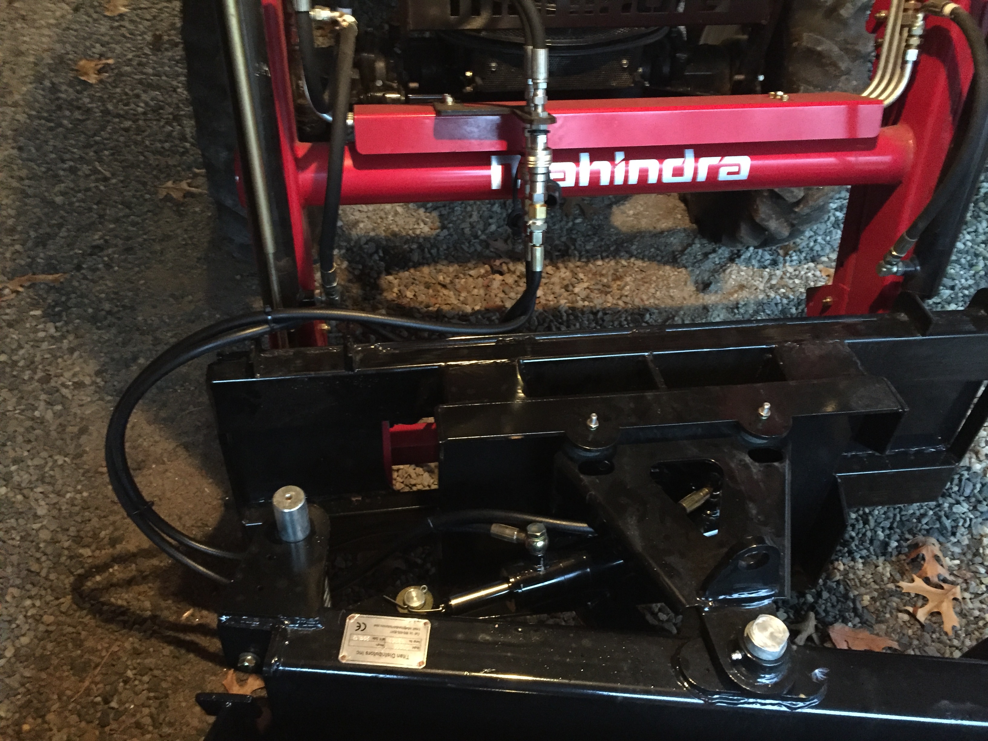

I just got home. It's dark out. I'll post a pic tomorrow.
#18
I did move the fitting on the left forward, towards the blade after I took the pic. It was a bit tight as it was.

I know this is an old thread and a resolution made.
I just wanted to add that Tractor Supply has Pioneer connections that for perfectly for my Kioti tractor.

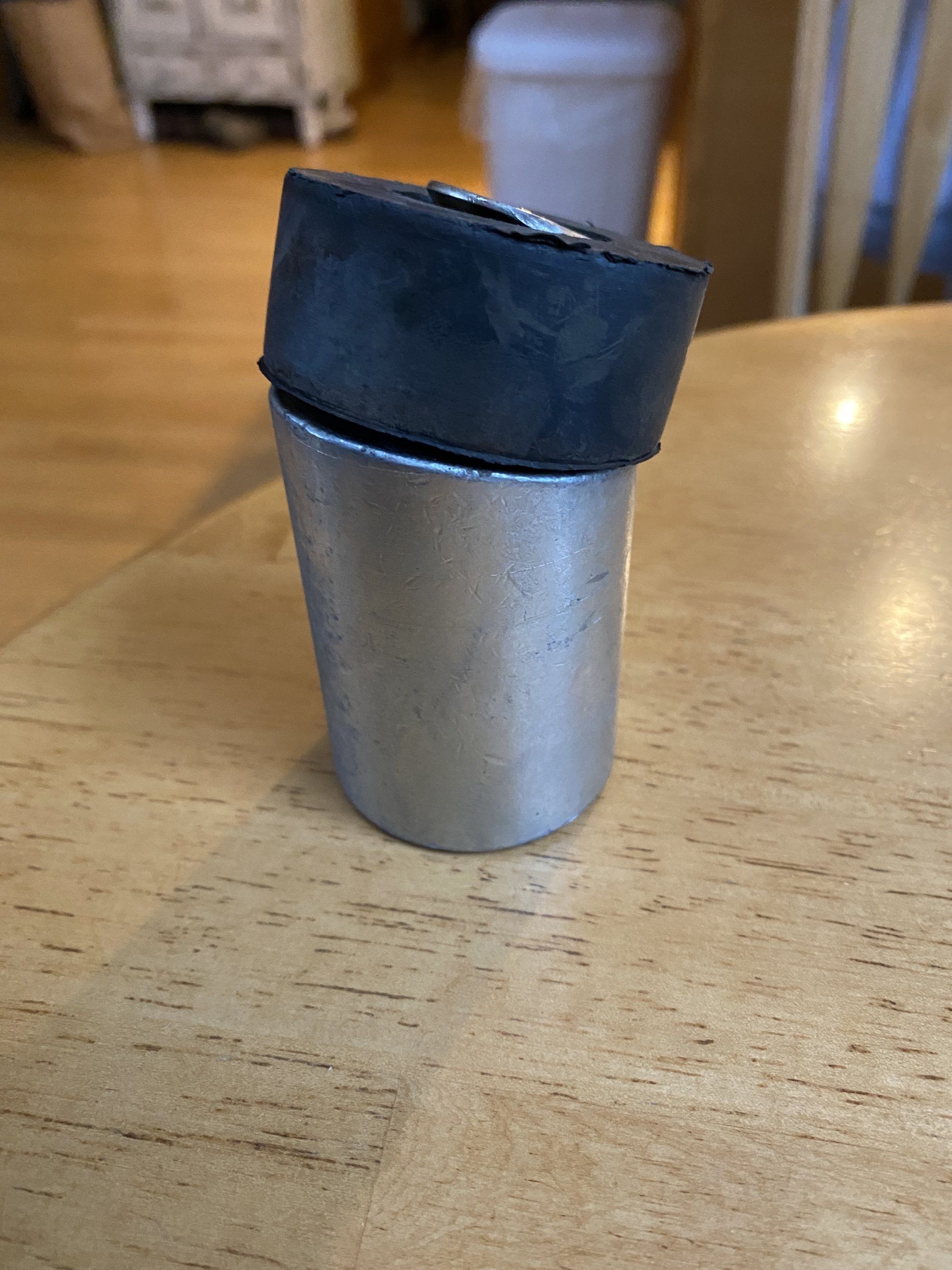

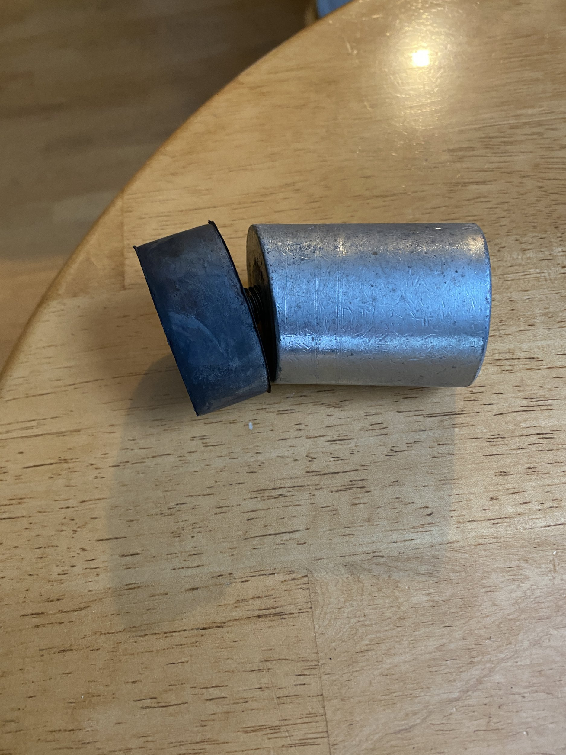

Had a few inches to plow this am. After the job was done, I found this piece in the driveway. Does anyone know what it is or where it might go? I can't figure out where it is missing from.
