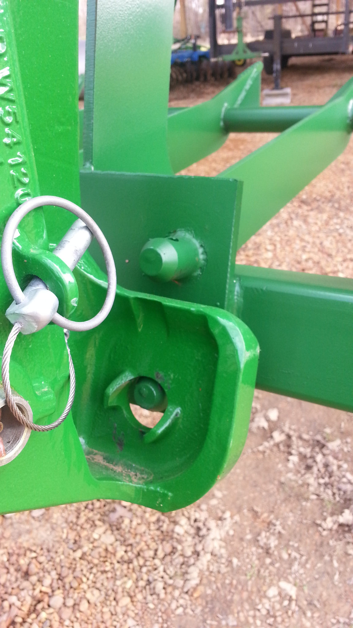

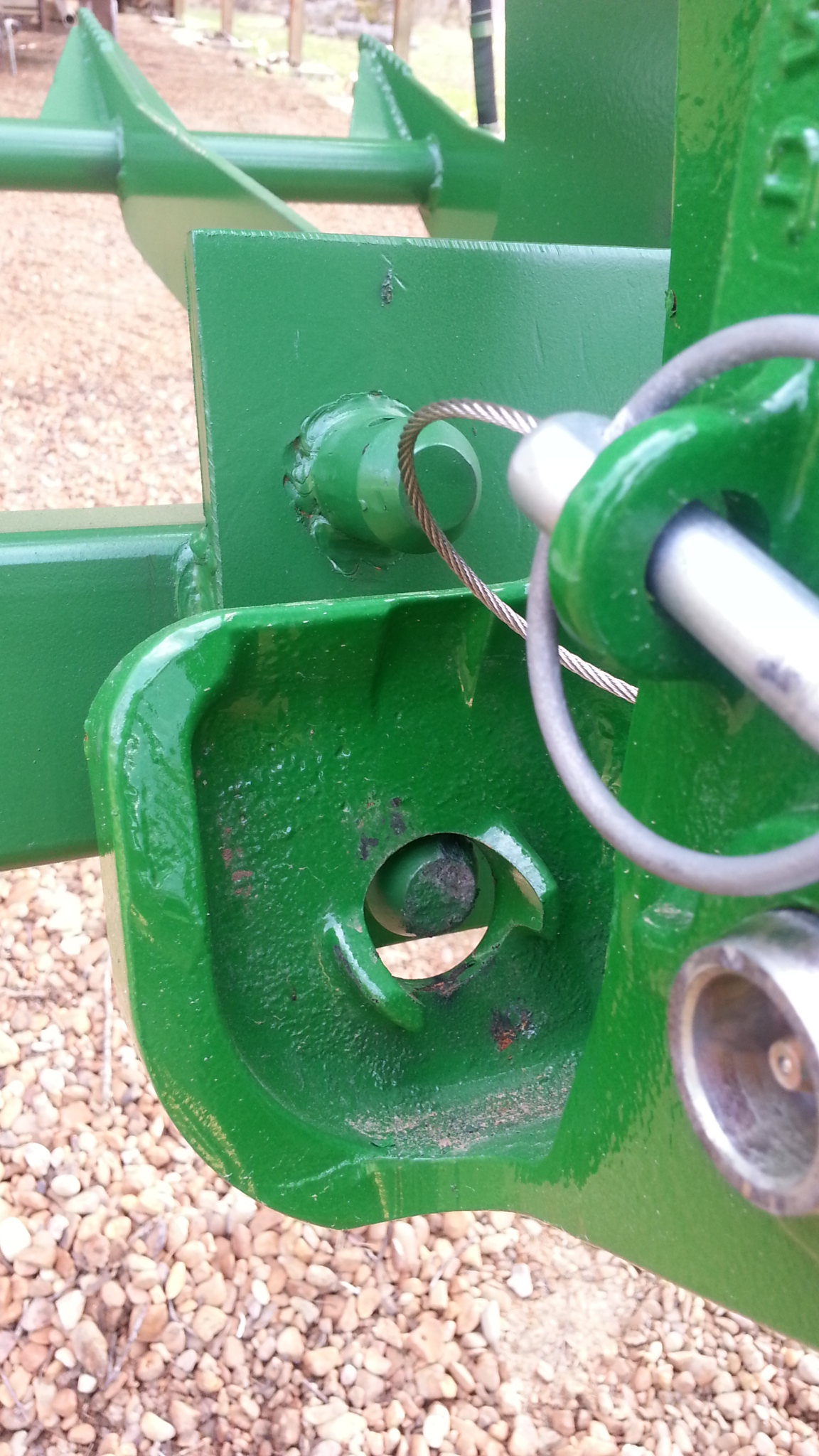

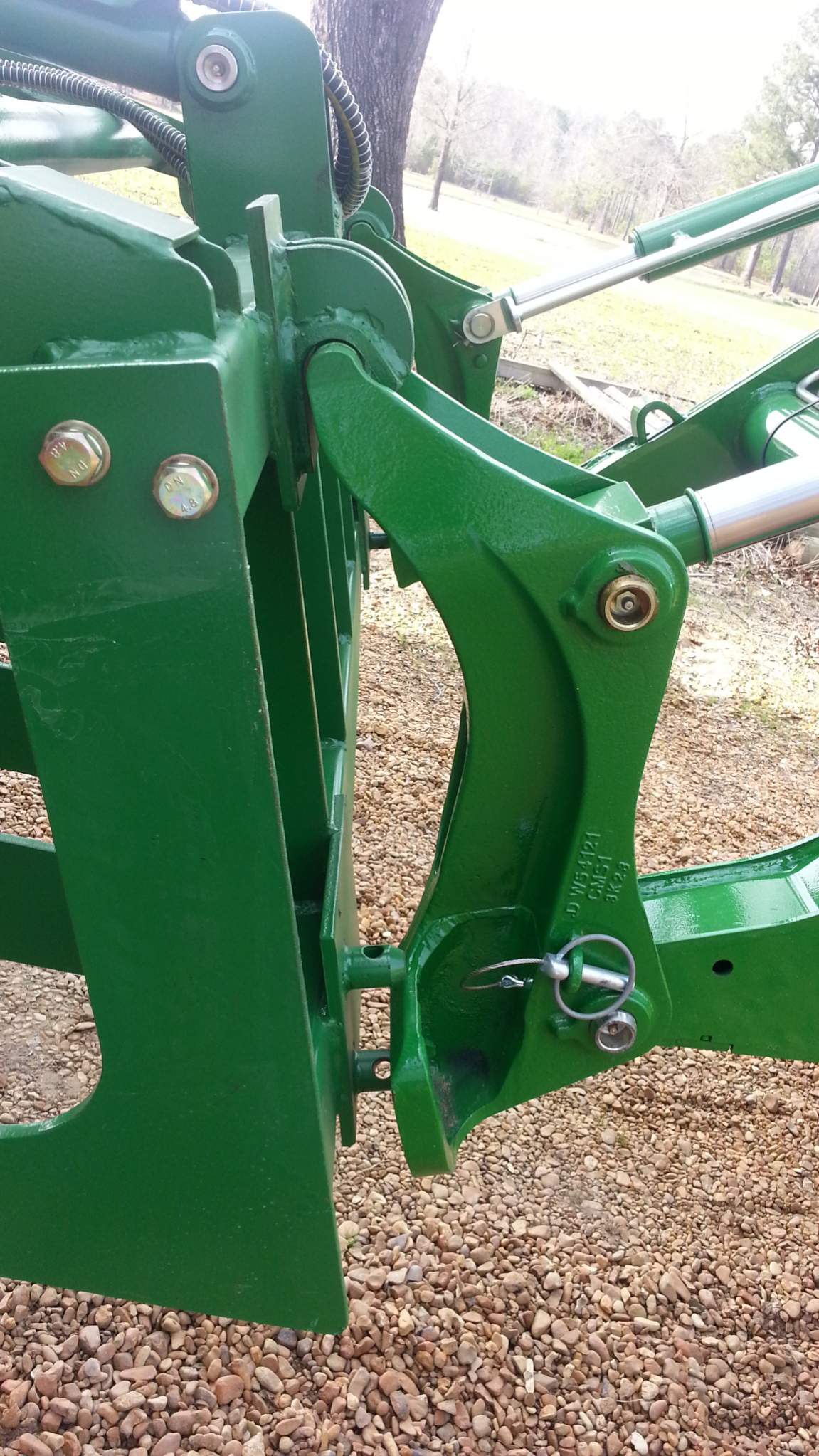

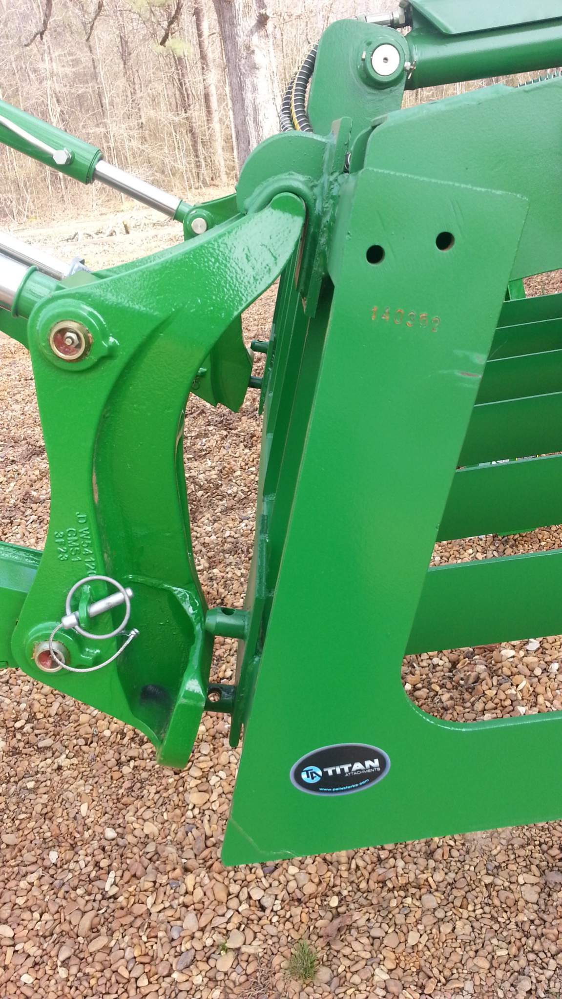

20140321_161442.jpg20140321_161454.jpg20140321_161501.jpg20140321_161514.jpgTo make a long story short, I had a delivery issue with Titan concerning my 60" JD grapple. I tried to remain positive and patient, and I received the grapple approximately 2 weeks late after I convinced them their tracking number was wrong and my grapple was never delivered. To make matters worse, today when I tried to install the new grapple on my FEL, I realized the bottom pins are not spaced properly to fit the FEL :mad: They were welded about 1/2" too high which does not allow them to fit into the pin hole frame on the FEL (the welds all over the grapple are a subject for a different day).
I will withhold final judgment until Titan decides what to do with the grapple. Will they pay to have a welder come out to grind off the lower pin brackets and re-weld in the proper location? Will they pick it up, re-package everything, send it back and send me a new grapple? I certainly don't want to load this thing up, re-package with angle iron and wire and transport to a shipper. And I certainly don't want to drive the tractor and grapple to a welding shop 10 miles each way from our property to have the grapple pins refitted by a welder. This is very inconveniencing to say the least. Hopefully, Titan will find a viable and timely solution.
I don't know. I called them and they told me to send them pictures. I did within 5 minutes. However, they did not respond to my email this afternoon. Hopefully, I'll hear something positive first thing Monday morning. I'll see what happens. So far, I'm certainly not having a good experience.

Titan's advise was to grind the pin to the point that it will fit into the hole on the bottom of the FEL. That is roughly 1/4" less diameter the entire length of the pin... I realize most of the strength lies with the connector at the top of the grapple and not at the bottom connection. What do y'all say about the reduction in strength of the pin?

View attachment 366577View attachment 366578View attachment 366579View attachment 366580To make a long story short, I had a delivery issue with Titan concerning my 60" JD grapple. I tried to remain positive and patient, and I received the grapple approximately 2 weeks late after I convinced them their tracking number was wrong and my grapple was never delivered. To make matters worse, today when I tried to install the new grapple on my FEL, I realized the bottom pins are not spaced properly to fit the FEL :mad: They were welded about 1/2" too high which does not allow them to fit into the pin hole frame on the FEL (the welds all over the grapple are a subject for a different day).
:eek: Yikes. Better exchange it for one out of the next container coming over from China. :laughing: :thumbsup: :thumbsup: :laughing:
Return it and get something from a reputable company. Do you really want to watch that thing turn back into recycled rusted scrap over the next 13 months?
