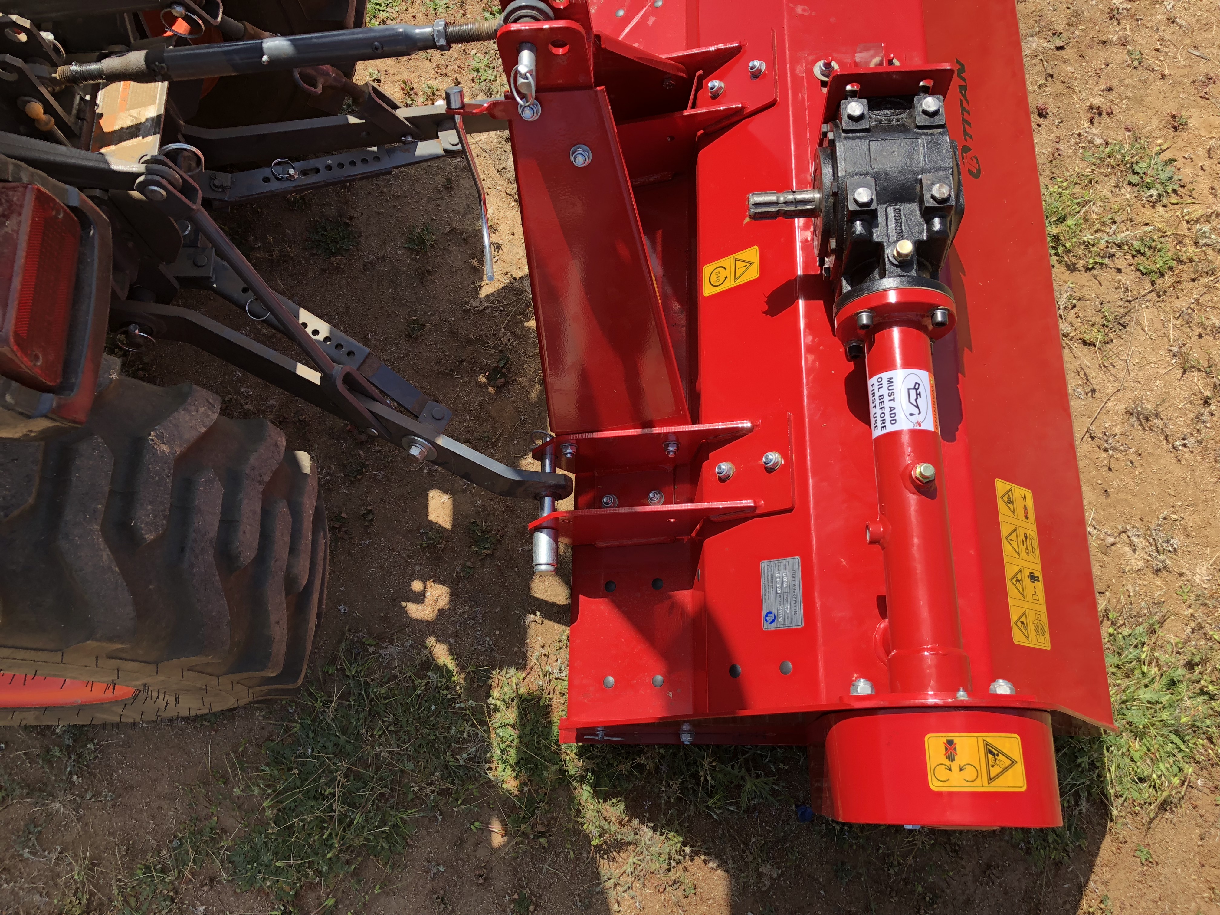

Well, I had time to troubleshoot it today. While I managed to get the twist out, as well as most of the bend, the gearbox has issues now. I think I'm going to replace it with a new one from Titan and build an external cage/bumper for protection. Experience shows up right after you need it....

You assemble the lower bushing at wrong position, it should be installed inside the lower hitch like this. To avoild the mower to slip when mowing.
Look at these photos.
And where is the PTO cover on the gear box????? Safety first.

Ah yes that makes sense, I'll move the bushings next time I take the mower out. I took this picture right before putting the PTO shaft on so I took off the rubber gearbox PTO cover. Again Jack, thanks for your flail mower knowledge and help!
