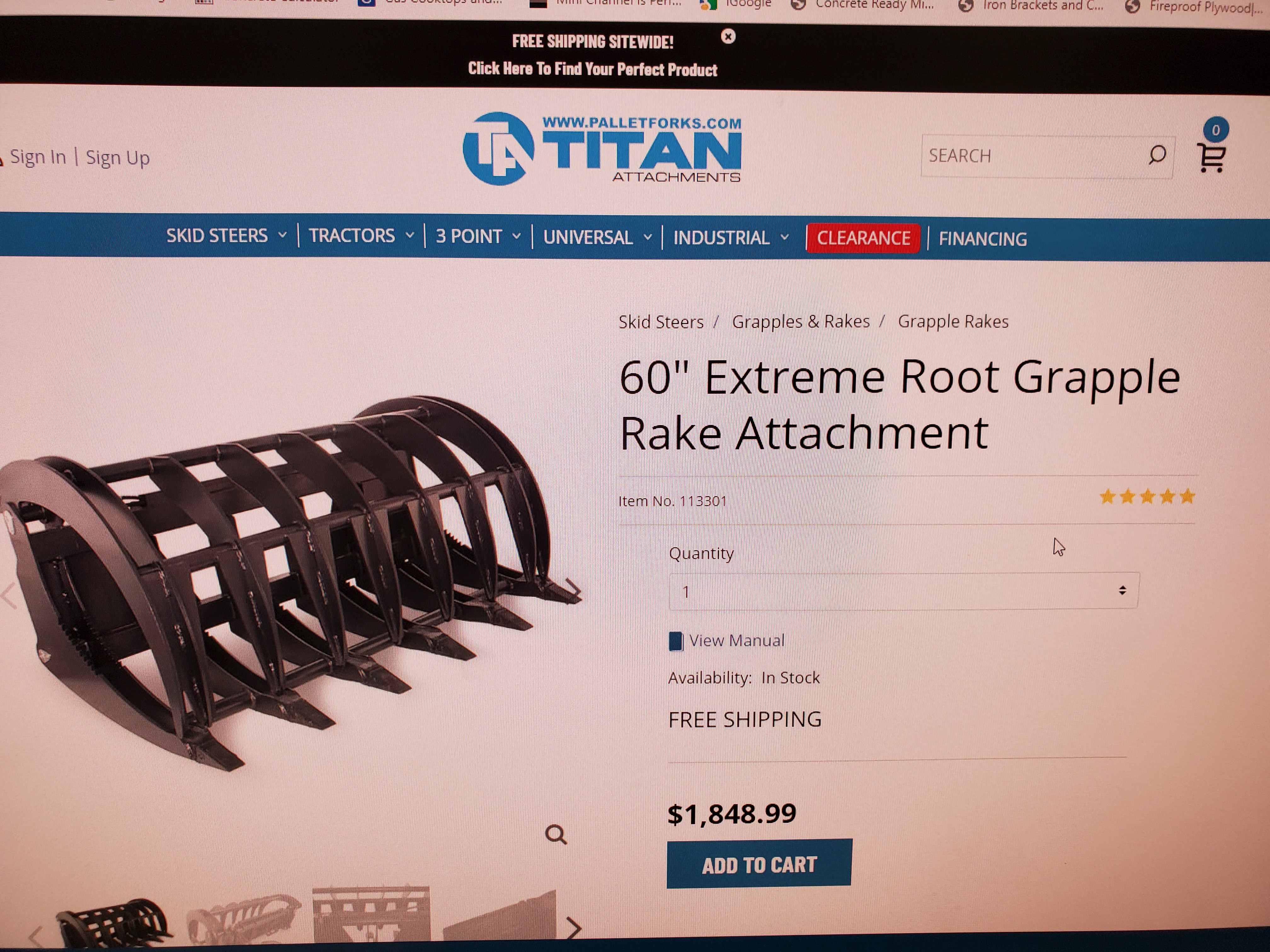

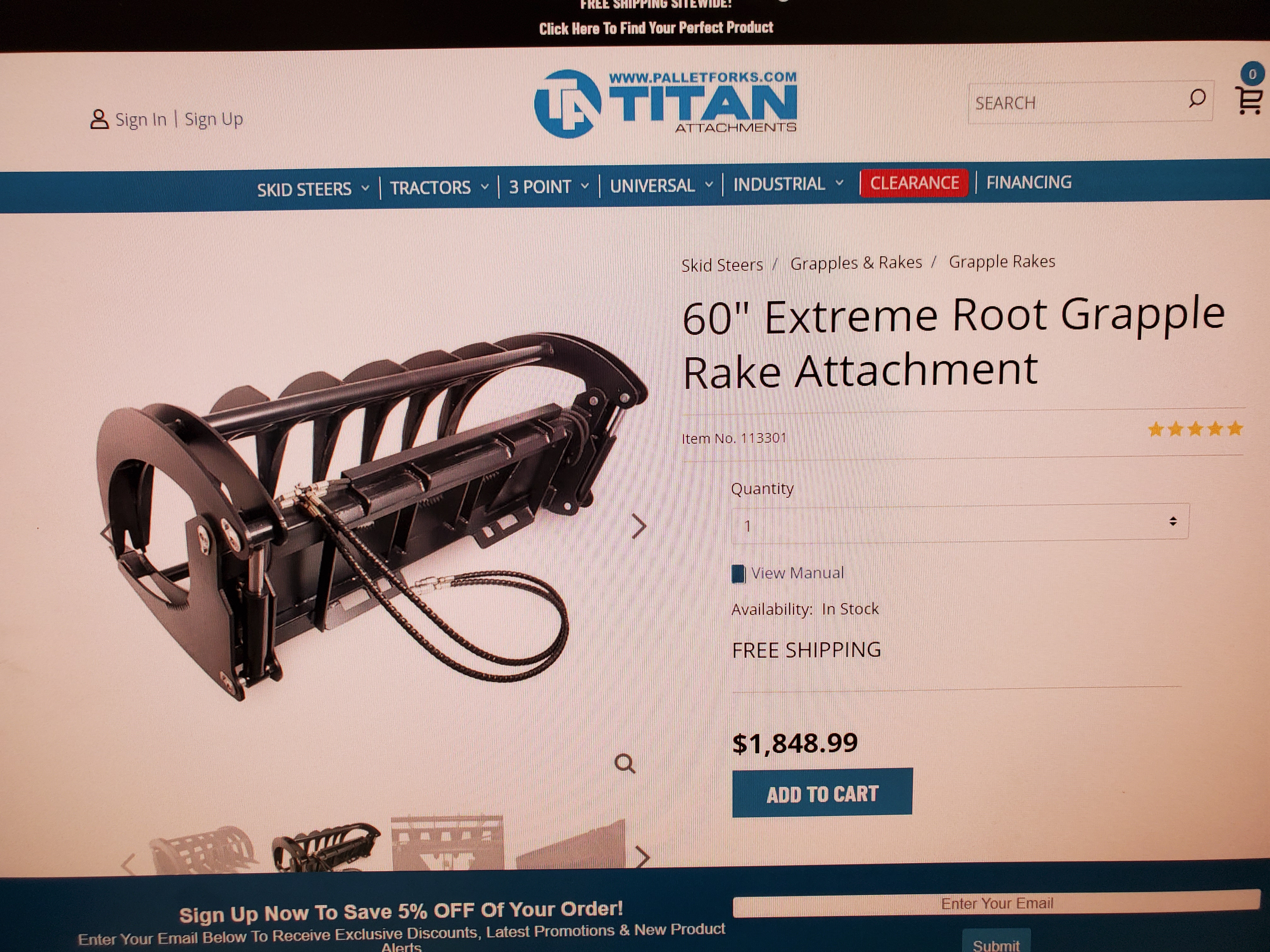

Anyone have any experience with the Titan Extreme Root Grapple. I am looking at the 60" model. I was trying to keep it somewhat smaller and low in weight. My use will be for smaller trees while building roads in the woods on my property. No rocks so that's not an issue. I thought keeping it lighter in weight would help with pulling power, less load on the machine. This guy weighs 890 lbs which is actually a little more than I was hoping for. I like the rake style grapple with closer together hooks like this Titan has. Price is good at about $1900 bucks. Has Dual cylinders which is what I want. Would like to hear any reviews on it. Good or Bad. Thanks
View attachment 644684View attachment 644685
This looks exactly like the grapple manufactured and sold by Mid-State attachments, in Denton, NC.
I am about to order their 60" lighter duty (575-lb. wt.) version of this, and will use it for brush removal.
I have zero rocks, and do not do work for hire.
I suspect that Mid-State may be the actual manufacturer (for Titan) of the grapple in your picture.
You might call Connie at Mid-State for their direct sale price, it will likely be somewhat less than Titan's $1848.
Mid-State phone number is: 336-857-2564.
Friendly folks with excellent feedback.
Their shipping is very reasonable.
I will order from them next month.
I also want their unique tooth design, to meet my other very specific need for snagging and ripping out climbing vines.
