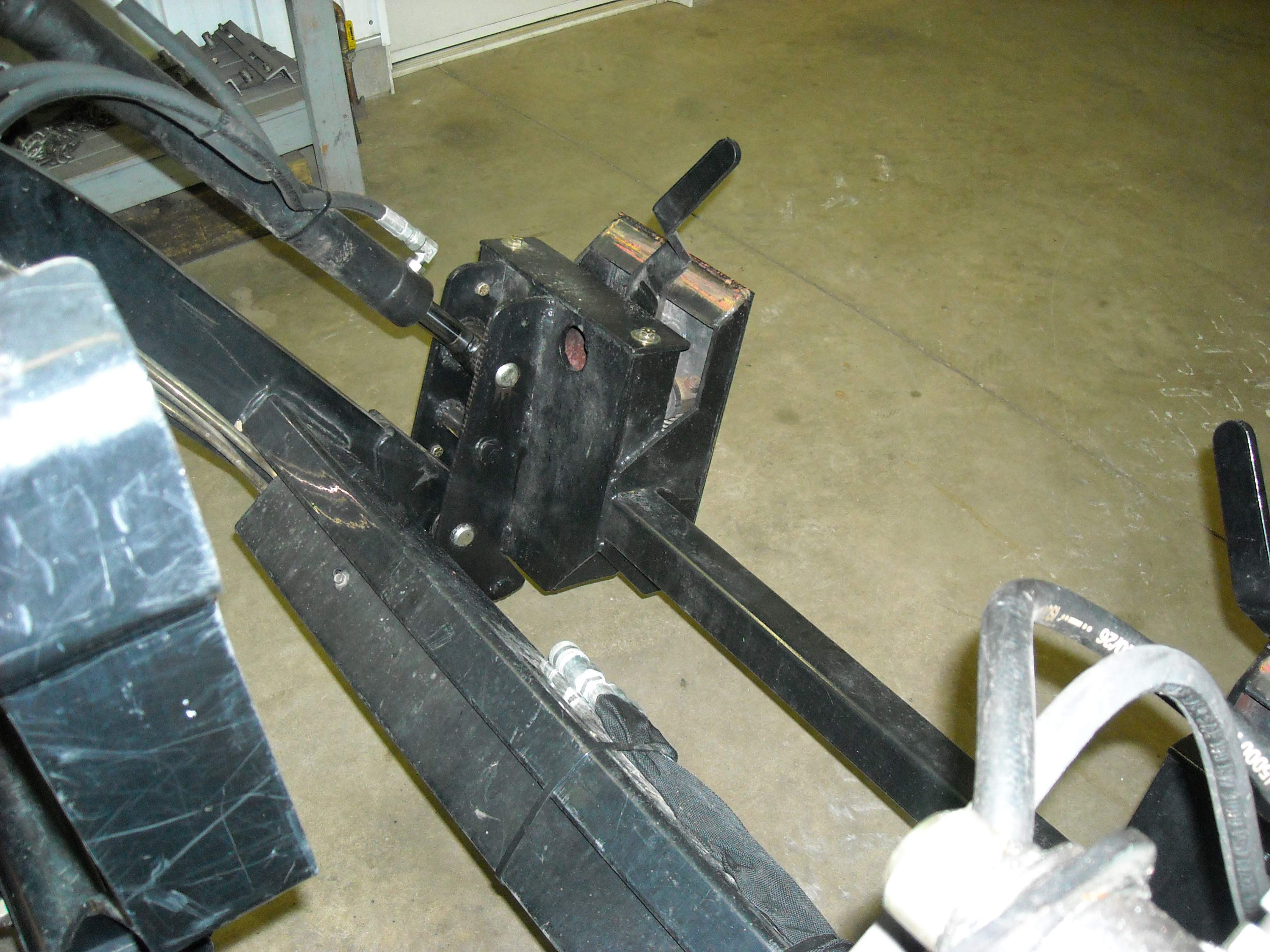

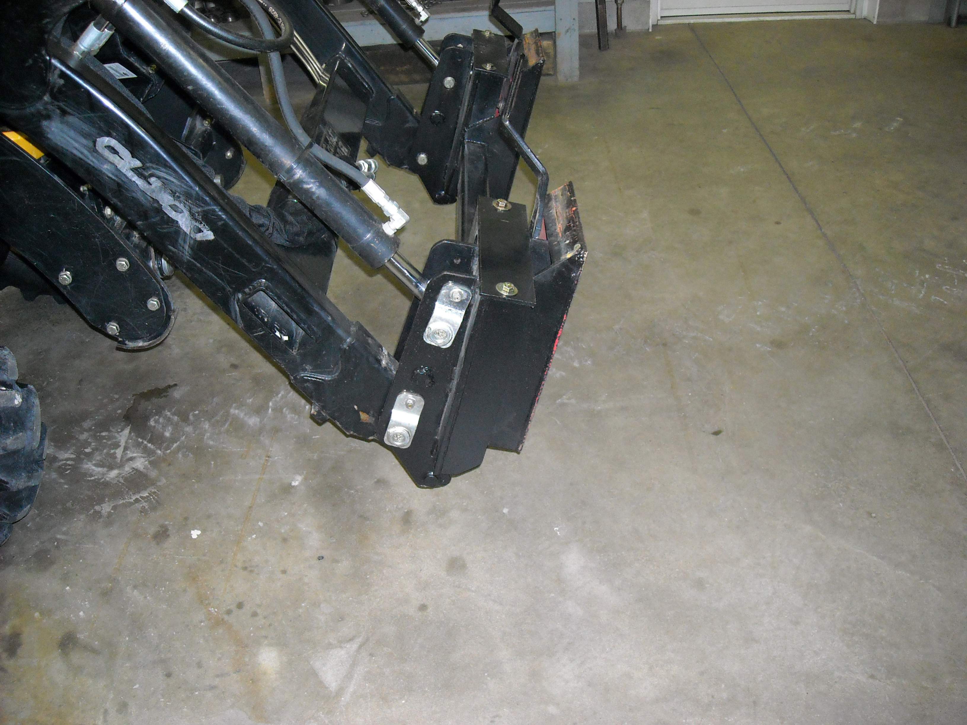

Here's a few pics of the titan setup on mine. I reworked it quite a bit from the original but it works for me. Buying attachments is that much easier, cheaper and availability shot through the roof.
/ Titan SSQA kit #8
Note that I cut off the top of the mounting area to gain visibility to the top lip to hook up attachment and bolted a top plate (saved from the excess metal cut off) to retain the access to the lever mechanism in case something were to break or what have you. I had planned on welding it but there would be no way to service it after that. My locking pins were also mounted backwards when I got the QA. The bevel was facing frontwards when it needs to be facing the tractor, I simply removed the pin and flipped it 180*.
